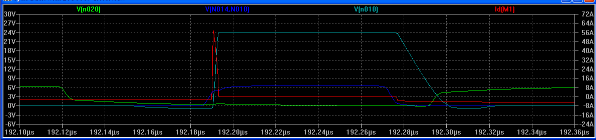

This sync Buck FET driver has extremely low dead time of 13ns between top fet driven off and bottom fet being driven on (and vice versa) . This is far too low. Do you know why it is so low?
The simulator (LTspice) shows it giving serious shoot-thru current spikes of 100 Amps plus.

I don't think this is shoot through.
Left side, green trace is bottom gate drive, G-S of bottom FET 192.12uS
Blue trace is top gate G-S of tip FET 192.19uS.
Red is current in M1 FET. 56A I noticed that the M1 has about the same current spike that looks like shoot through.
I think the current in M1 is negative 2.3A when M2 turns on. So the current has been going through the body diode. You can see the D-S voltage of M1 is -0.7 volts at this time between when M1 is turned off and when M2 is turned on. I think you are fighting a slow RR time in the diode.

This is not shoot through. With shoot through you don't get the -700mV steps at the switch node because the low side FET (which is On when it shouldn't be) clamps the switch node at 0V. Your circuit has negative steps these implying that the bottom FET body diode is conducting when the top FET switches ON. As Ron says, you are switching on the high side FET into a conducting low side body diode and this current spike is the reverse recovery of that body diode

Looks like shoot-through to me (which would coincide with diode recovery). If you plot the Vgs voltages of M3 and M4 there's an overlap point where they are both about 2.3V, their turn-on threshold, even though the TG and BG outputs of the 4449 don't overlap.
I am looking at M1, M2 (right side) At 699.83uS
I think M1 voltage rise time is so fast that the 10 ohms gate resistor can not keep M1 turned off.
Look at the out put of U2-BG and the M1 gate voltage. The voltage on U2-BG drops fine but during the rise time the gate voltage rises back up and turns on M1.
To slow down the rise time by added capacitance which helps. Capacitance from M1-D/M2-S to ground.
AND
I reduced the 10 ohm gate resistors to 2 ohms helps. Then to double prove I change to 100 ohms which leaves M1 on for a very long time.
Bottom line, I think the capacitance in the MOSFET is so high that 10 ohms causes problems. Try changing to 20 ohms or 50 ohms and watch the current spike to up.
The 4449 datasheet makes that very point. The drain-to-gate capacitance of the bottom FET causes its gate voltage to rise to the turn-on threshold when the top FET turns on.
Yes, the answer to preventing the bottom fet turning on when the top fet turns on is to have the bottom fet held hard off by a separate low resistance turn-off channel in the fet driver, as in the ucc27511….

Post #4 is definitely shoot through. The original post I was looking at is NOT shoot through - because you have the negative steps on the switch node. Try putting a resistor in series with the BOOST pin of the LTC4449. This will slow down the top FET turn ON time, but not slow down the turn OFF time. Remove the series gate resistors. My simulations show this drastically reduces the drain current pulse you are worried about.
