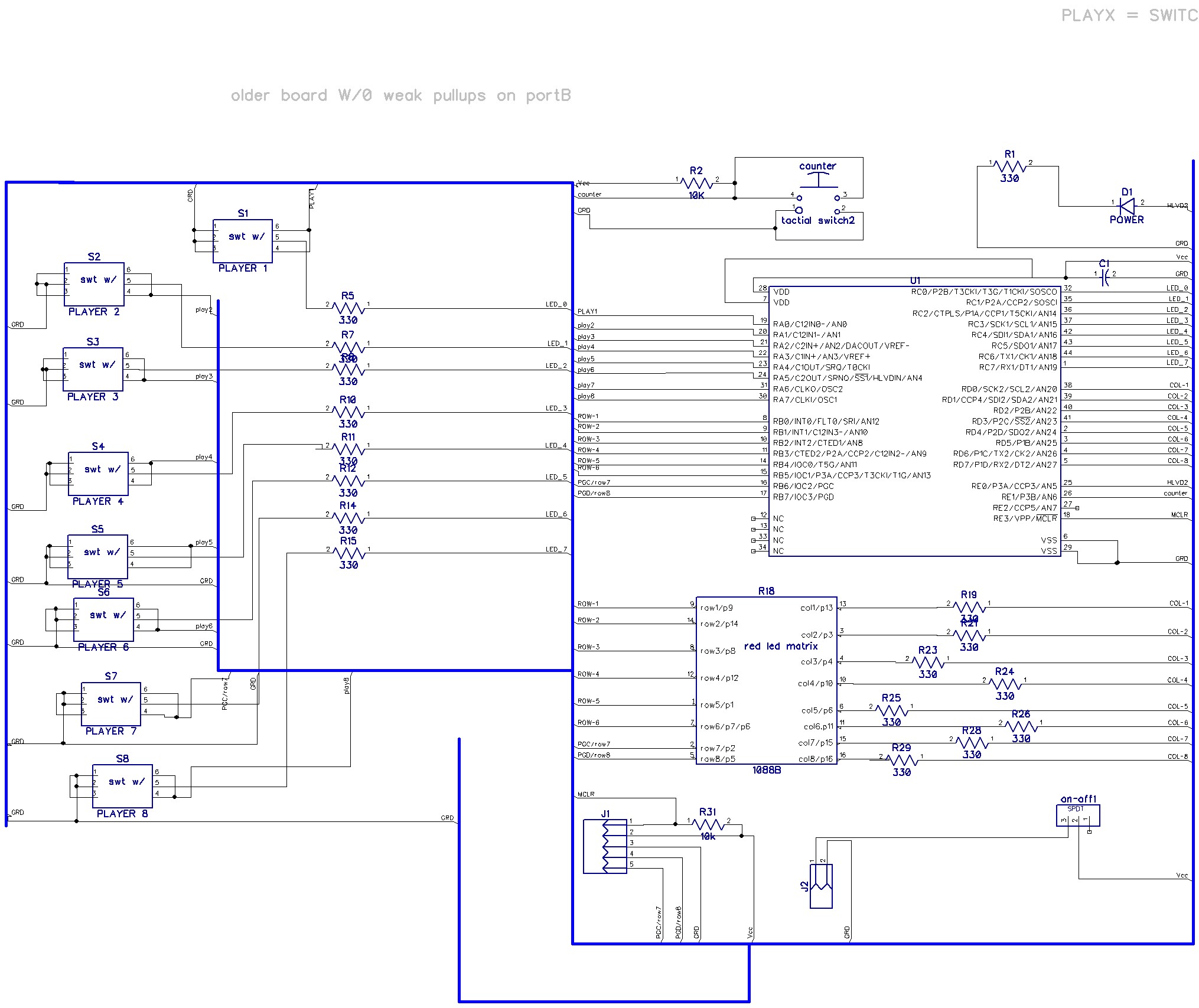

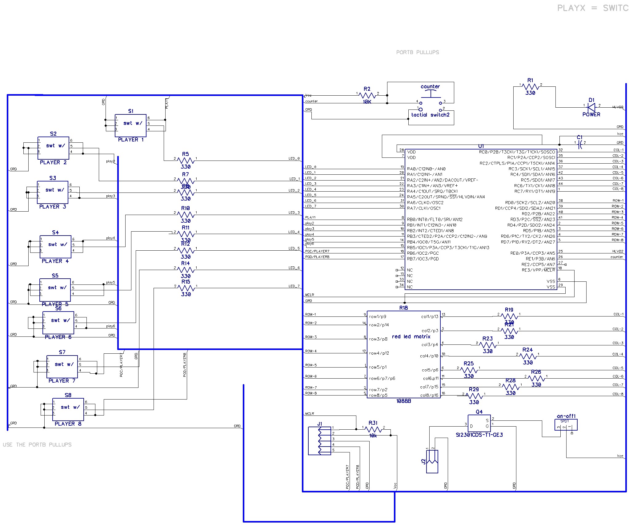

Be hacking at this swordfish basic code and inserting led markers but code still does not declimate the numbers (SEE SUD ROUTINES)
the COUNTER is working but still the matrix is not displaying correctly. I had a similar code that worked but with a harddrive issue most is gone. Trying to rebuild working code.
Am sure it is something simple but I have yet to get the correct configuration

As usual, post your schematic.
That code doesn't match any of the ones you've posted here that I'm aware of (not that anyone would know unless they follow all the different posts you make)
I have to redo the "lost" schematic. Had to reverse engener the board to find out what each port does.
Player LEDs = port C
player buttons = portA
the matrix is ports D and B
the e.1 is the switch that changes the matrix display.
Will dra up new schematic
Maybe a long way around but it works perfect AND got the idea to turn OFF all the LEDs on portC when switch=0

That's not going to work out very well unless you've added pullup resistors to PORTA since the last schematic you posted here...
the board I am using has 10k pullup resistors on PortA.
Still working on code for board using weal pullups on portB
Will post schematic of the posted code in post#4
here is a schematic that matches the posted code in post#4

I'll take your word for it that there are pullups on PORTA since they're not shown in that schematic.
If that code works for you then great.
oUPS! I forgo to put the 10K pullups on portA. My bad.
I used the schematic that I have for my newer boards with PortB for the switch inputs,
Thanks.
