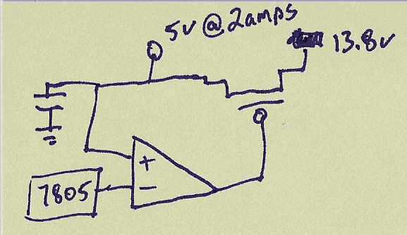

In my senior design group, I gave my group mate a schematic to build our power supply for our project. It consisted of a 7805 and a PNP (or NPN, I forget which) pass transistor. He replaced the BJT with an opamp and an N-FET. I was quite annoyed with it at first because while doing all of that, he also made the rest of the circuit much more complex.
So did he basically make a more efficient 5v source by doing this? We'll need about 2 amps, and with what I had quick math shows that the BJT would have to dissipate about 18 watts (its going in a car, changing 13.8v to 5v, about 2 amps current). But if his is truly a switching supply, it would reduce the power consumption right?
The opamp - is connected 5v from a 7805
The output of the opamp goes to an N-FET
The N-FET source is connected to 12v to 13.8v
The N-FET drain is connected to the opamp + and is used for a 5 volt 2 amp (6 amp capable, though fused much lower than that) supply

Could you post a schematic? The 7805 is a linear regulator and changing the pass element from a BJT to an op-amp/FET combination won't make it any more efficient. The pass element still needs to dissipate most of the 18 watts.
Why do you think this is a switching power supply? Are there more circuit details I'm missing?

Deja vu, Noggin. Like I said before, why don't you post a schematic? Your description is way too sketchy to understand.
Oh man I'm sorry.... I did a quick look for that but I missed it. Didn't even think to run a search, I dimissed it as too long and just a ranting post and didn't put my consideration into it.
I'll see if I can come up with a schematic...
As for why I think it may be a switching supply, its based only on the fact that the NFET doesn't seem to ever get into a steady state. It just keeps wobbling back and forth... can't think of a better word.
That opamp is a 741. Not sure about the PFET, wouldn't think it matters though as the op-amp would adjust accordingly, rated for 8 amps. I believe we have a 470 micro farad cap on the drain of the PFET.

Perhaps I am not clued in, but I have no idea how this circuit works even after looking at the schematic. It seems that you have somehow configured the opamp as a follower. This is in no way a switching power supply. The 7805 is a linear regulator. if you are drawing 1A, presumably the 7805 will dissipated 1A at 13.8V-5V or about 8W. Perhaps you can provide a clearer idea of what your end goal is: For instance, are you attempting to construct a 13.8-5V switching power supply? Or are you trying a high power 5V linear power supply (the 7805 is rated at 1A or so, do you want a 5V/5A?)
spuffock said:
You have built an oscillator. OOPS :shock:
Go back to the first idea, save money and gnashing teeth.

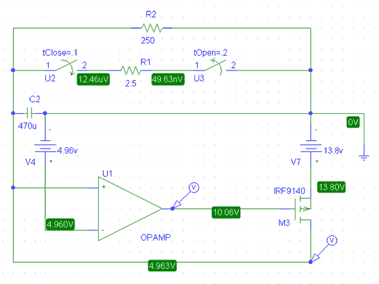

As for if I'm trying to build a switching supply, no... just want something that works. The 7805 should dissipate VERY little heat. Its ouput ONLY goes to an opamp, which of course has very high input impedance. The ouput of the NFET goes to the other input of the opamp, and the output of the opamp drives the NFET until there is 0 difference between the 7805 and the FET drain.
I actually did put it into PSPICE last night, those are ideal parts in PSPICE, and it showed 0 ripple. I don't know how to change those things so that they're not ideal.
Here is a better shcematic of it though... if anyone can help me add some ripple on the 13.8v DC source I'd appreciate it. I tried several AC sources, but couldn't figure out how to do an appropriate AC sweep on it. Instead of a sweep, I'd rather just select the frequency and then run it at the frequency for some set amount of time though.

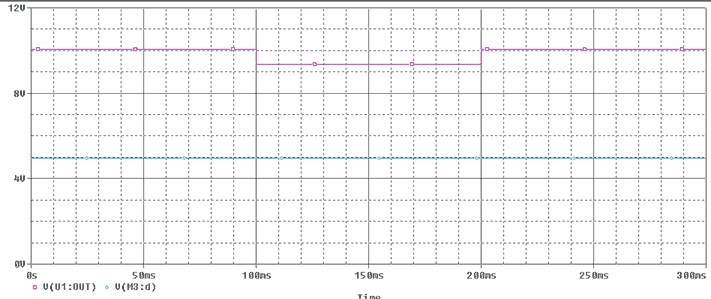

On the graph, the teal line (wait, I'm a guy... pretend I said blue! I don't know what teal is I swear!) is the 5v rail, and the mauve (I MEAN PURPLE! :shock:) is the output of the op amp.
Also, the higher the gain of the opamp the closer it gets to 5v (well, 4.96 since that is what our 7805 outputs).
Edit: The resistors are meant to just be a load on the circuit. R2 is the load from 0s to .1s, R1 || R2 is the load from .1 to .2, and R2 is the load from .2 to .3 seconds. This is just the approximate load for when the modem is or is not transmitting.

You do in fact have a negative feedback loop, but it's unstable due to multiple poles at low frequency. If you really want to use a linear regulator, look at LM350K mounted on a heat sink. I personally would use a switching regulator unless the 2 amp load is low duty cycle (<20%) and of short duration (a few milliseconds).

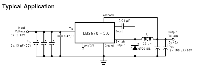

Is there a decent switching supply you can recommend? I'll search digikey for now...
These capacitors are low ESR -type.Todays you can also purchase one 47uF and 360uF (or 470uF).
Ok, so a single big one on the input and output should work then... Its supposed to be DC so I imagine its just to reduce ripple, so the only drawback to one being too big is cost....

I'm casting my vote for the LM2678 solution...especially if you're powering a micro. That regulator is specifically designed for the automotive environment which can be quite ugly...huge voltage spikes from load dumps and all manner of nastiness. There are other similar regulators from National that you can find with a parametric search. Oh...and read the whole datasheet for the LM2678, it's full of good info. They have an excellent app note about automotive LDO's as well. LDO regulators have very specific capapcitor ESR requirements, hence the multiple input caps...all explained in the datasheet.
