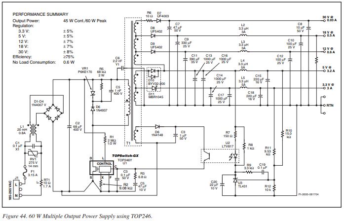

I’m trying to fix a Switching Mode Power Supply for an audio component that is producing only half of the designed output voltage. It has 12V and 5V outputs that are now only 6V and 2.5V. I replaced an obviously bad capacitor on the output of the bridge rectifier and the unit initially worked fine for about a minute until it went off again with the current symptom. It is switched by a Power Integrations TOP245PN (datasheet here). The design of the SMPS is similar to the one in Figure 44 but stripped down to just the 12V/5V outputs with a few component value differences.

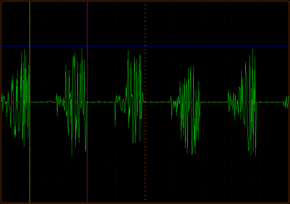

I don’t know what the output of the transformer should normally be but it appears that the duty cycle may only be half of what it should be according to what I’ve seen with an oscope.
118977
The 5V output (blue) is overlaid on the 12V output (green) measured at the transformer secondary. The time between the yellow/magenta markers is ~25ms (40Hz).
Could this apparently half-duty cycle be normal or be the problem?
Well it's a bit bizarre, in that it seems to be trying to regulate too rails (5V and 3.3V) in one supply, which can't be done - so it can only try and 'average' between them.
However, by FAR the most common cause would be electrolytic capacitors (because they fit sub-standard ones), particularly C13, 14, 16 and 17.
Try placing the scope on the +ve's of C13 and C14, and see what the ripple is like.
R1 might have gone high, or possibly one of the rails is overloaded or shorted.

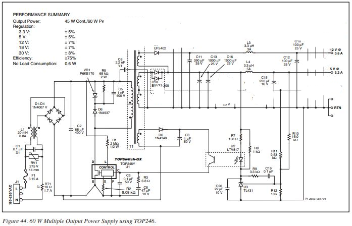

The example schematic includes a 3.3V output but the actual design has only 12V & 5V. Replacement capacitors have been ordered but I'd like to understand the cause of the problem based on the indications. The ripple at C13 (used for 5V output) is 4mV p-p. At C11 (for 12V output), ripple is 2mV p-p.
Measurements have been with no load. In the brief period the PS worked after the cap replacement, it provided the proper voltages with and without the normal load.

I think the scope is showing that the supply is turning on and off at 40hz. (burst mode) It is hard to see but I think the PWM is turning off for 12mS our of 25mS. This often happens when the supply has no load, or some time when the supply see too big a load.
I agree.
It looks to me like it's starting up, seeing that something is wrong so it shuts down, then restarts.
My best guess would be on something that would appear as an overload condition to the TOP245.
If the supply is unloaded: It might take 50 cycles to get to full output. Then with out load the output is at or even above where it should be so the duty cycle goes to zero for a long time. The output voltages slowly drop back to where the IC starts switching again. (burst mode)
If there is a near short somewhere (maybe a damaged diode), or too high a load, bad cap, etc : The current limit is hit hard causing the IC to shutdown and delay then restart. This restarting is a second form of (burst mode).

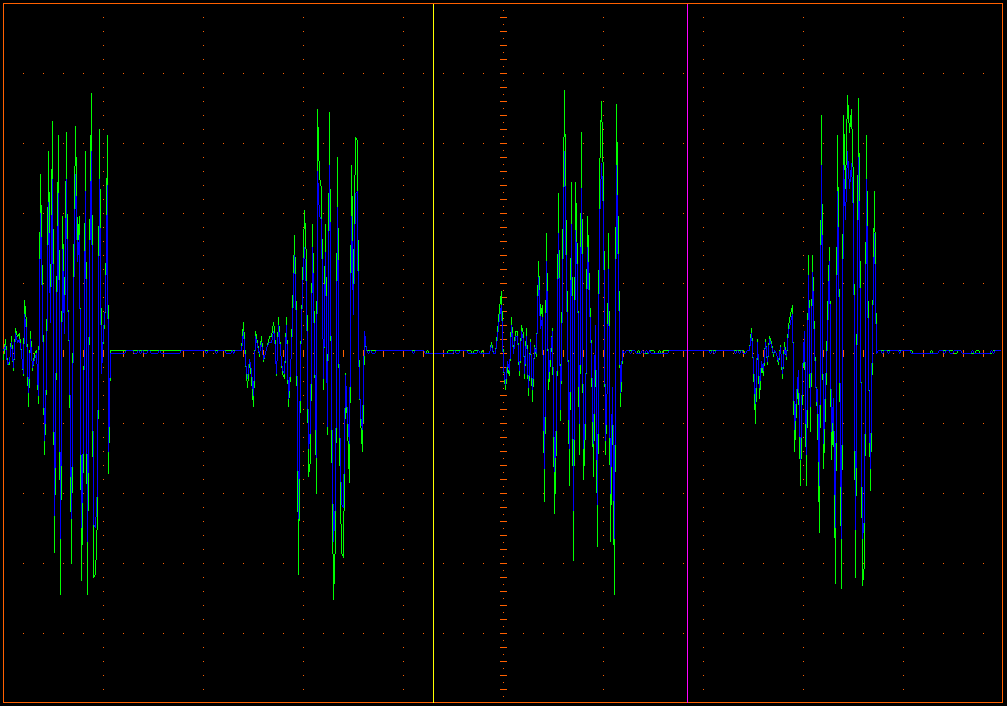

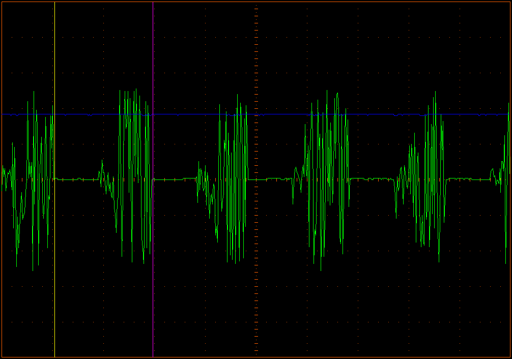

jward I'm assuming that the behavior that you show in the scope capture in your original post goes on continuously?
I'd be interested is seeing a couple of other scope images:
1) Ch1, 5V trans secondary. Ch2, 5V DC output
2) Ch1, 5V trans secondary. Ch2, the cathode of the TL431
As for the time scale. That would be long enough to show either a repetitive behavior, or reaching an asymptote.
1)
Ch1 (green): 5V trans secondary. 1V/div AC coupled
Ch2 (blue): 5V DC output. 1V/div DC coupled
Timebase: 10mS/div
Markers: 20mS (50Hz). Note: input is 120VAC 60Hz

2)
Ch2 (blue): the cathode of the TL431. 1V/div DC coupled
Timebase: 10mS/div
118997

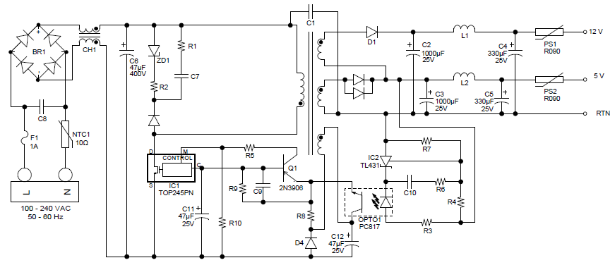

While waiting to receive the replacement capacitors, I prepared to continue troubleshooting based on the advice given. It was then that I discovered that the circuit deviated from the example even more than I had initially mentioned, particularly with the addition of Q1. Because of the kind efforts of those who took the time to read about the problem and especially of those who offered advice, I felt obligated to begin the laborious task of partially reverse-engineering the board to have a more accurate schematic, which is shown below.
119076
In the schematic, all components are accounted for but I didn’t go as far as examining the value of each component, which isn’t always necessary for troubleshooting anyway. By the time I got this far, I had the replacements. I first replaced C11 and C12 because C12 seemed most likely to cause my symptom. They were also identical in value and were adjacent to each other so for convenience, I replaced them at the same time before testing. This fixed the problem. Unfortunately, because I did both at the same time, I don’t know which one fixed the problem so I partially lost my academic exercise in properly troubleshooting this circuit. Most importantly though, the unit works and is in service. While I was at it and had new electrolytic caps, I replaced the others as well which wasn’t absolutely necessary because the old ones still worked fine but maybe the replacements will postpone another repair.
Thanks for the troubleshooting tips. For others who may benefit from this, this schematic is of the switched-mode power supply (SMPS) for a NuVo tuner model NV-T2DFG. I was unable to find a schematic of it from other sources. The tuner is discontinued and the company was sold to Legrand.
