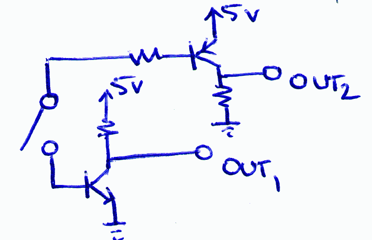

The following quote is what JowWawaw was asking for. The circuit I provided gives a a near 0-5V swing on one output and a near 5-0V swing on the other; the change occurs when the switch is pressed.

Dougy83, on your circuit you have 2 outputs per switch, not one.
With reference to above paragraph red text, Does this not mean that JoeWawaw wants one switch to vary one output?

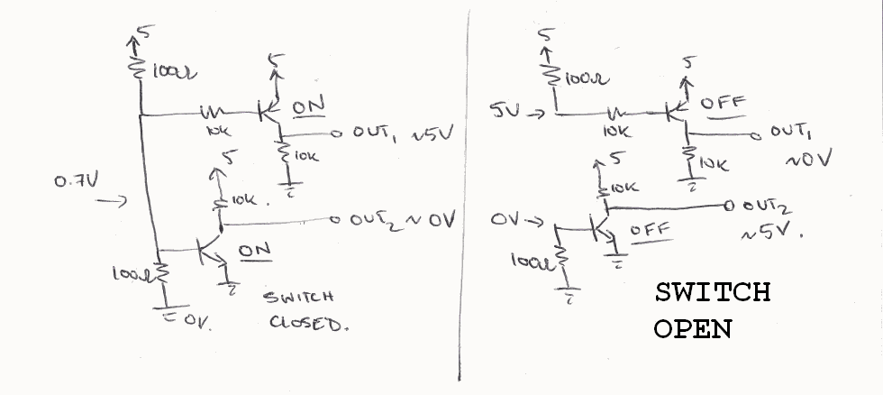

I didn't read all of your passive aggressive post, but I drew some pictures for you. These include a 100R pull-up and pull-down on the switch that you mentioned. Circuit functions in the same manner with or without them.

Yes, I agree, your circuit will theoretically work, but for how long practically?
Most cheapy keypads I've seen online are contact current rated around approx 20mA
Your base current on NPN (lower transistor ...when switch is closed)...... is 43mA
where I = V/R .....
0.043A = 5V{supply} - 0.7V{NPN Base Emitter Voltage} ....divided by 100 {100ohm resistor}
....that equates to your 12 switch keypad drawing a massive 0.516 amps if all 12 switches were to be pressed simultaneously .....which, yes I know, isn't an issue here.
Unless you place an additional current reducing resistor on its base, or implement a "digital transistor" here, for example a DTC114ECA. .... 43mA is also a bit on the harsh side of things for such a multiplex keypad digital circuit design.

Irrelevant......for such a simple circuit....you'll find my current estimation close enough to prove you are over-biasing the NPN transistor.

Try at least to add less confusion for other forum users and redraw your circuits outputs in a similar named format. (see attach)

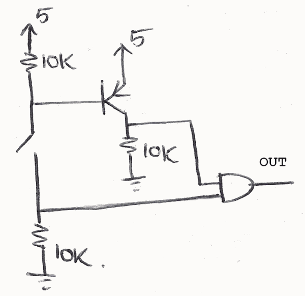

JoeWawaw, you could fashion something similar to what you've proposed and it could be made to work. You'd probably want to use TTL compatible input (e.g. 74HCT') buffers as they have inputs specified to operate with a lower threshold.
OTOH, you'd get a more reliable function using something based on the first circuit I posted feeding into the decoder circuitry. Alternately you could further simplify that circuit, removing the NPN (thus simplifying the decoder also by removing the inverter) to something like the attached circuit. For a 3x4 keypad matrix, you'd only need 3 transistors and 6 resistors on the rows, and 4 resistors on the columns. The decoder then consists of just a single AND gate per switch.
