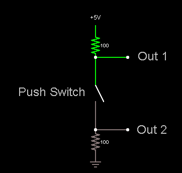

If you look at the first image i put up, out 1 is before the switch, and out 2 is after it. the switch is in between the the outputs, in your idea they are both after the switch
Yes I see that is the way you have drawn it, but is the important bit, to have 0V or 5V output at each output, without them being the same voltage at the same time.....I'm confused here,.... why has the switch to be physically in between the outputs?.... perhaps an explanation of what you are trying to achieve project wise might help to clarify things

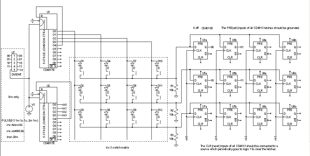

Here's one possibility for demultiplexing the keypad without using a micro. The key switch matrix is scanned using two 4017 counters and the switch states are latched by 4013 ICs. I haven't included latch reset circuitry.
Edit:
One CD4017 could be eliminated, outputs of the remaining one being applied to both rows and columns, providing the extra loading on the outputs doesn't slow the rising edges of the latch clock inputs so as to prevent reliable latching.

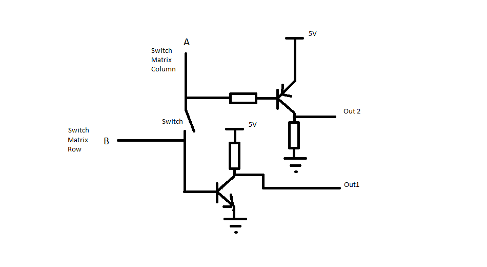

My idea was to have this circuit connected twelve times from each "anode" to each "cathode", then when one switch is pressed, the voltage alternates only on those two pins that connect that switch, ...
That should be pretty simple; see attached sketch. Obviously for a 3x4 matrix you'll need 3+4=7 transistors.
Not sure if thats going to work Dougy83.
My thoughts on your idea is that you are tying down the bottom of your switch to 0.7 volts (base emitter voltage of bottom transistor) ..... remember that this is a 3 x 4 matix keypad, which means that all switches on that row or column will be stuck at that voltage when one of those row or column switches are pressed. Same issue with the top of your switch...... that complete row or column will also be 0.7 volts when one of the switches is pressed.
Draw it out and have a think about it.
Correct. Why is this an issue?
I'm not sure why you keep mentioning 0.7V... and why you think this is an issue. Yes, the row and column of an activated switch will be ~0.7V; this will result in the PNP transistor for that row being activated in addition to the NPN transistor for that column being activated.
From what I understood from his posts he wants to get a logic level from his switch matrix. The circuit I posted (when extended to each row/column) will give him 7 logic-level outputs from his switch matrix, which he can then feed into his logic decoder circuit.

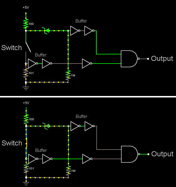

After a few days, i've found a way of doing it, see the attached picture. on the top i have a zener diode with a breakdown voltage of 4V, so when the switch is depressed, it conducts, and when it's pressed, the voltage splits to 2.5V and the zener diode blocks the current.
although think the trick with the counters is a good idea, since I'd have to make seven (i think) of these to make it work.
and im not going to use any microprocessor in this project, all just logic gates and counters, so i dont think contact bounce would be a problem, right?

My point is, that it is a working switch matrix with rows and columns, which I assume that if you place a logic high on point A (see my redrawn attachment) of the matrix switch, that you would like to see a logic high at point B when the switch is closed.
With your circuit you will never see a logic high at point B, because the base emitter junction of the lower NPN transistor will always limit / drag down the input AND output of the switch to 0.7Volts when the switch is closed.
I cannot explain it any simpler than that.
Dougy83, I not looking to argue with you over this, its really great to get different opinions .....perhaps I'm looking at this at a totally different angle that you, but I was reading that JoeWawaw was requesting to monitor what state his matrix switches were in, so I'm presuming that he's still using logic levels on the matrix switches rows and columns.
Looking forward to your reply,
Rotarymaker
Why are you placing any external voltage on the switch matrix?
There doesn't need to be any logic high (or low) on any base-emitter junction. The junction will have about 0.7V across it when the switch is closed, and 0V when the switch is open.
I don't see any point that needs to be argued. The circuit is very simple. Close the switch and tell me what the voltage on the outputs are. Now open the switch; what are the output voltages now?
The following quote is what JowWawaw was asking for. The circuit I provided gives a a near 0-5V swing on one output and a near 5-0V swing on the other; the change occurs when the switch is pressed.
