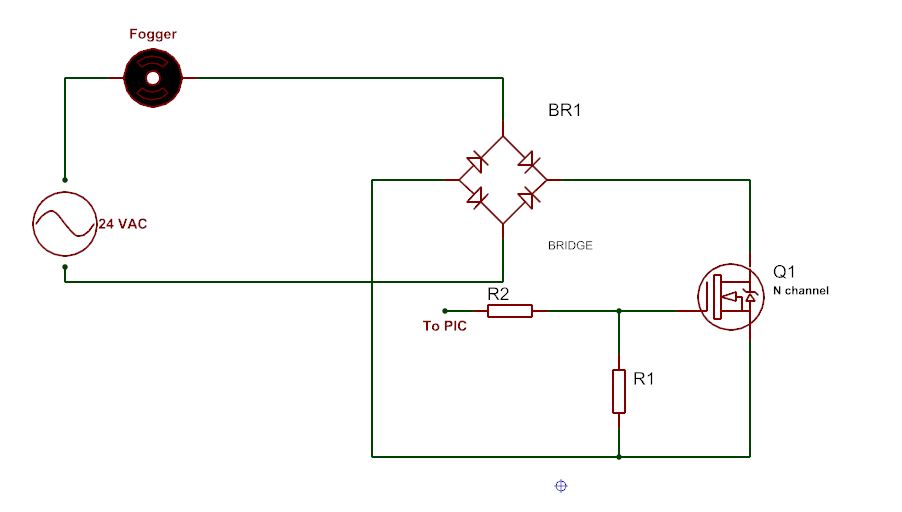

and just for completeness here is the mosfet circuit i had in mind if i go that way, i think if i did go for the zero cross detect with a micro route then it would be a pure learning experience and i would want to try and add a filter, i do except fully that from the outside it seems a utter waste of time energy and components, but on the other hand it might be a chance to get a little experience of something without having to use dangerous voltage so it does kind of appeal from that point!
anyway here is the mosfet circuit i was thinking of using, no values added as i havnt thought that far :D
That should work but I have a curiosity about how you plan to deal with the floating ground/common lines between the DC logic side and the AC fogger drive side? :confused:

If the 24vac supply is isolated from the digital supply (i.e. fed from a separate transformer etc) then surely it would be fine to tie the ground from the Mosfet driver bit to the microcontroller part ?
*Edit - you could even just replace Q1 with a relay for full isolation but then you might as well just use a relay to switch the fogger lol.
Good answer! :D
Sometimes the simple way really is the easiest to do.:p
I would just opto isolate the circuits and be done with it.;)

As you probably gathered by now, when you just have to turn a load on and off you dont need to sense zero crossing in many cases. You just need to turn the triac on or off as needed. You can do this with a switch and resistor or opto if you prefer.
The MOSFET/bridge setup is not needed here. It just adds complexity. But if you want to use it anyway then you need to find a way to power the MOSFET gate. Since it doesnt take much power it shouldnt be too hard to do.
Another problem with either of these solutions however is that there will be significant drop in the switch. It could be as high as 1.5 volts, which may or may not affect the application load significantly so you'll have to check that. If you puts two diodes in series and then another set of two diodes in series and then put those two strings in antiparallel, you can then insert that in series with the load. If the load still performs well then the switch voltage drop wont be a problem.
Another problem that 'could' come up in the MOSFET solution is back EMF from the load. If there is back EMF even during one switch 'off' cycle, that could destroy the diodes and/or MOSFET. So some snubbing may be necessary. If the load does not contain significant inductance this may not be a problem but something that has to be kept in mind.
