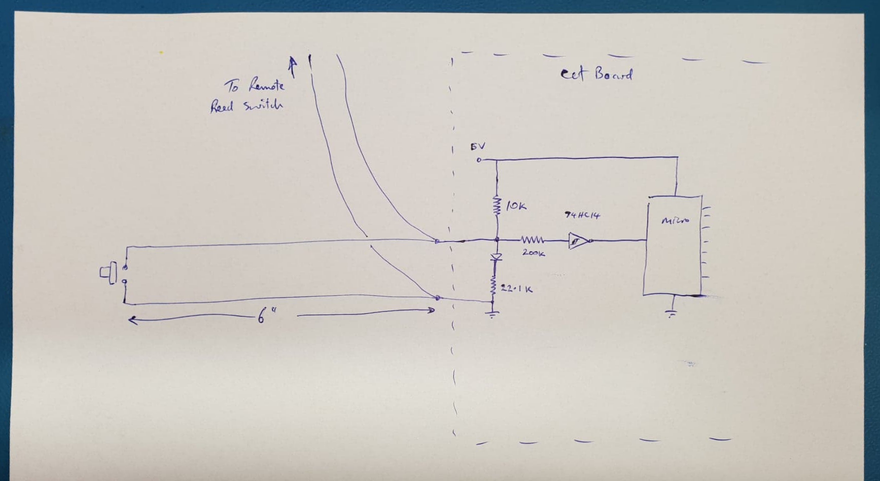

We have made some progress, albeit very slowly.
The techs had virtually given up, so has been difficult to get them to try any suggestions … but finally got a phone call this morning with some promising news.
I had been asking them to start the process … and then unplug the switch leads from the board altogether … to see if it would still falsely re-trigger when the automatic process stopped (which has been the fault all along)
In the call this morning they tell me that doing this prevents the fault from occurring. No real surprise there … but it’s progress.
(I had previously got them to remove the lead from the remote switch … which I really expected to be the issue … but that did not help)
I'm after any suggestions as to what could cause these switch circuits to falsely trigger … and what should I try to prevent it.
My suggestion was to get them to twist the (six inch) leads from the switch to the board … and also keep the remote switch leads disconnected until the issue is solved.
Should we try a signal diode across the switch terminals on the board … or any other suppression component suggestions please.
Thanks for any help.
Edit: There's also a 50nF cap to ground on the input of the schmitt trigger.

There is no debouncing and no noise/transient/EMI control on your input. 200K is a high enough input impedance to be susceptable to ESD/EMI in the area. Also, I don't see any need for the diode (in that location) nor the 200 K resistor. If the intent is for the 200 K to limit the transient current into the HC14 input protection diodes, it is way better to add that protection externally.
If the switch and the micro run on the same 5 V supply, I also don't see any need for the 2/3 voltage divider. Am I missing something, or many things, or what?
If the circuit really is nothing more than two mechanical switches in parallel (whatever the wire lengths) and a schmitt trigger buffer, then I suggest:
1. Keep the 10K
2. Increase the 22.1 K to 100 K.
3. Relocate the diode in parallel with the 100 K, anode to GND (reverse voltage / negative interference spike protection).
4. Add a diode in parallel with the 10 K, cathode to +5 V.
5. Add a 0.1 uF capacitor in parallel with the 100 K (switch debounce / noise filter)

I've certainly been questioning the need for the diode and the 200k resistor as well ... but before we go too far down that track ...
... there are 50 of these boards in this plant ... with only about 20 that never play up ... the rest are all over the place apparently ... sometimes good, but often re-triggering.
There is a plant nearby with identical boards and set-up which have never shown these symptoms ... and there are 100's of thousand of the boards throughout the world.
A redesigned board may solve the problem in this instance ... but what could be happening here that doesn't happen at least somewhere else in the world?

If this was just the one board on my bench, I'd go right ahead and attempt to fine tune the circuit ... but as above ... this particular board works perfectly in thousands of other locations around the world ... there must be something at this particular installation causing the grief with ~30 out of its 50 boards ...
I need to work out what it is and somehow direct a solution. I'm in the middle of Australia ... and the problem is over in New Zealand.

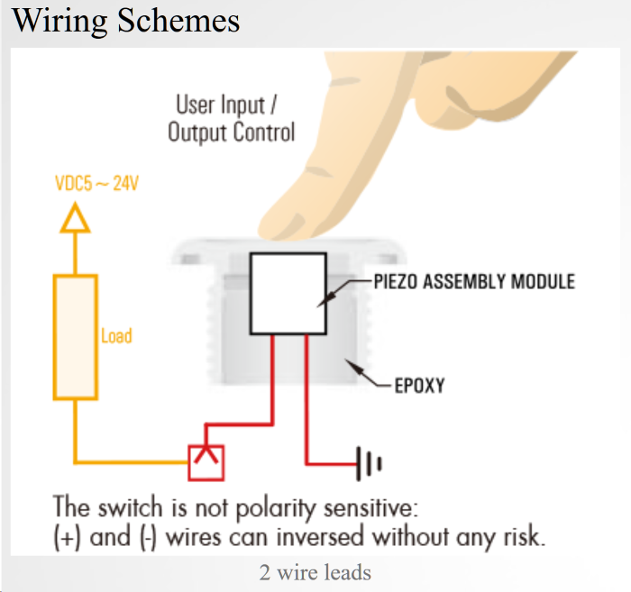

These units are using piezo switches ... in an effort to avoid moisture killing normal press button switches. Again ... the neighbouring facility is using piezos as well.

Apparently, a piezoelectric pushbuton switch is a solid state switch that has no bounce. Its internal circuitry is driven by the "piezoelectric effect" and drives an internal FET that acts like a switch contact (except with no bounce). When pressed it is active for a specific duration.
As above, the reason they use these in this situation is because they are completely sealed ... so there is not the issue they have elsewhere with water getting into the switch contacts.
These particular switches are used with several different models of boards from this manufacturer ... and seen as the top of the line answer for reliability.
They are something like $90 each !!! ... so they're not cheap junk ones.

Which one is the "start" button on your diagram?
So you were able to isolate one switch from the other to determine which "input" is causing the fault?
If so, and the switches are not bad, then it has to be the wiring or something in close proximity to the wires inducing a glitch. The input circuit on your diagram looks a little strange...seems like it should only have transient protection since there is no switch bounce to deal with.

Since the switches actually have semiconductors in them, is there special circuiting required when wiring them in parallel?
Is the same terminal on each button connected to the input and ground?
Basically, its like two FETS with source and drain connected to each other.
