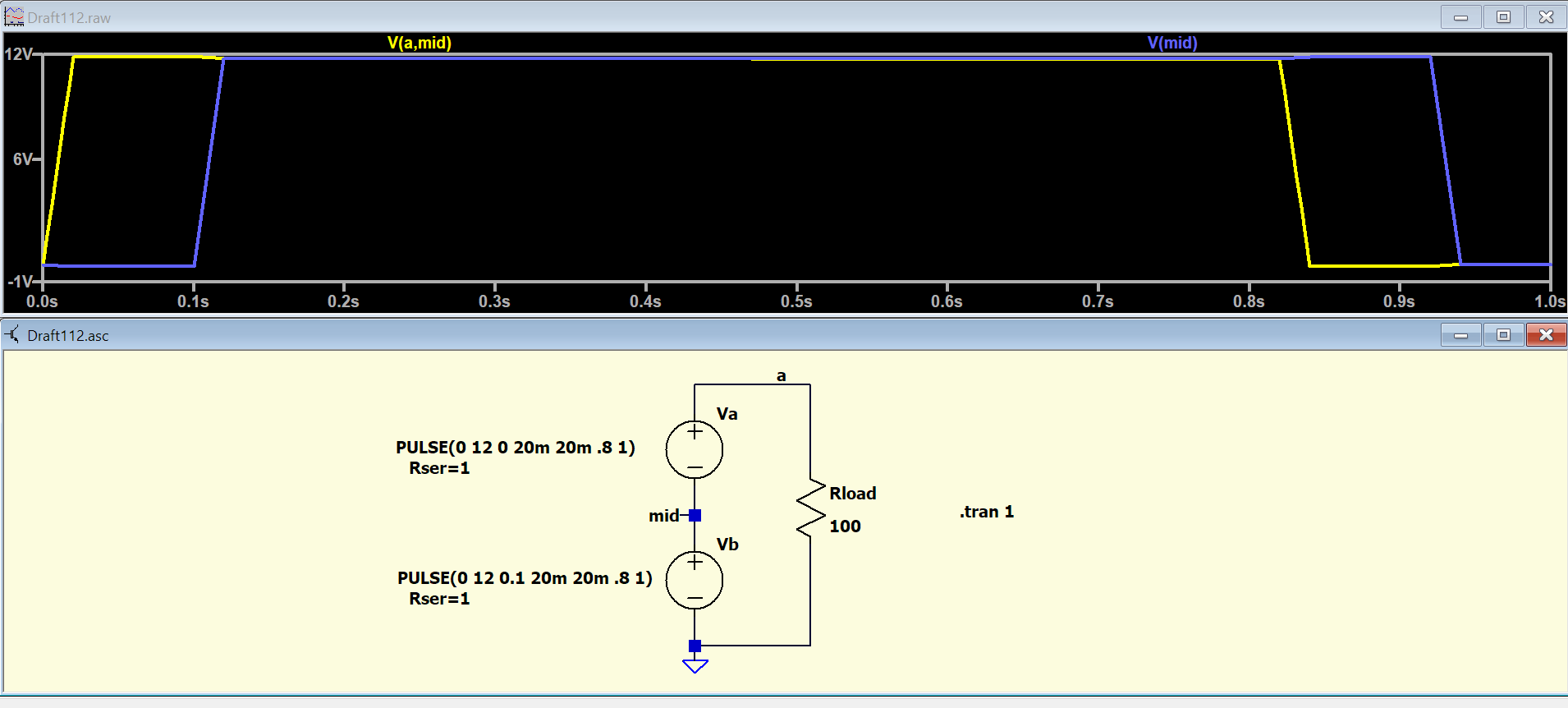

We're not discussing two separate power supplies, but rather two power supplies combined to make one split power supply, so they shouldn't be an option to switch only one of them on.
Obviously if you used two entirely separate supplies with separate mains leads then you're asking for problems, but that would be a very foolish thing to do.

However, turn only ONE of those supplies on first and leave the second one off, and we could see -12v across the second supply when it should be +12v.
I still don't see how (unless assumptions are made about the supply internals). Nor can LTspice :).
Re.#9..I assumed MrAl was talking about a momentary situation that might arise if the PSUs did not spark up at the same instant...Of course they would all be powered by a common mains switch in any scheme I would try...
'instant' wouldn't be a problem at all anyway, and identical supplies will perform pretty identically in any case.
You are assuming that the two supplies are ideal sources. Obviously that cant be true.
Power supplies are not ideal sources, and many of them have NPN pass transistors that have the output emitter connected to the positive output terminal (or nearly so). That means that a negative voltage (from the other power supply that starts up first) may force the NPN to conduct emitter to base, and so we may see a negative voltage at the base too. That may or may not work.
For power supplies with PNP output stages, it could mean the supply looks totally open. That would put a negative voltage across the output caps.
So what we have here is an indeterminate system where we cant be sure what will happen.
Just for the heck of it you can try to simulate two LM317 voltage regulators and tie them in series, then add a load, then start one up before the other, see what happens. You could also try one LM317 and the negative version of that IC in a split supply hookup with load from +12 to =12 (not to ground) and see what happens.
They may or may not work.
You can also try the reverse diodes, and see if they prevent latchup.
So if what MrAL is saying is a worry and the power supplies connected to the same mains power switch for whatever reason don't power up at the same instant, there's a simple solution:

And you're assuming linear analogue supplies, which almost certainly won't be the case. Why do you seem determined to mess the thread up by posting irrelevant rubbish?.
Hello,
Quite judgemental on your part which is not echoed by other postees.
I had to work in the power supply industry for many years so i've seen a number of different designs. They vary, and when we dont know the configuration we assume the worst. You are free to assume any config you wish, and i am free to assume the worst case. That's a large part of engineering, recognizing the worst case scenario and taking precautions.
That's why I was seeking clarification as to what assumptions you were making about the internals.
Ok that's fine, no problem here. But i did want to make it clear that i think the most important thing about this question is that we dont know what power supply circuit we are dealing with so i assume the worst case.
If you like you can try a few simulations with different regulator circuits and see what turns up. You may find hat some can work ok and others can not. In one of my Mastech 30v 10amp supplies there is already a reverse diode across the output, in the other there is a fuse in series with that because i upgraded it with a fuse too so the fuse would blow. That kind of power supply will take a very brief reverse voltage because of that diode, but the diode is not rated for full current so if it was left too long like that it would blow the diode. Dont bother looking on the schematic for this diode either because it's not on the original schematic, and it is also hidden just behind the front panel which is hard to see without taking considerable stuff apart. I think i have a pic somewhere though of that diode and fuse mod too, i'll see if i can find it.
