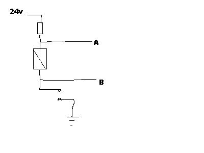

I have tried to enclosed a rough drawing of what I have in mind, I don't know if it is readable until I submit this.
If it is , I want to either connect something to point A that will delay the coil resetting and be able to earth B so it sets (preferred) or earth A to reset and put something onto point B with a delay to set the relay.
Altering the resistor above point A allows me to use different value relays in the circuit.

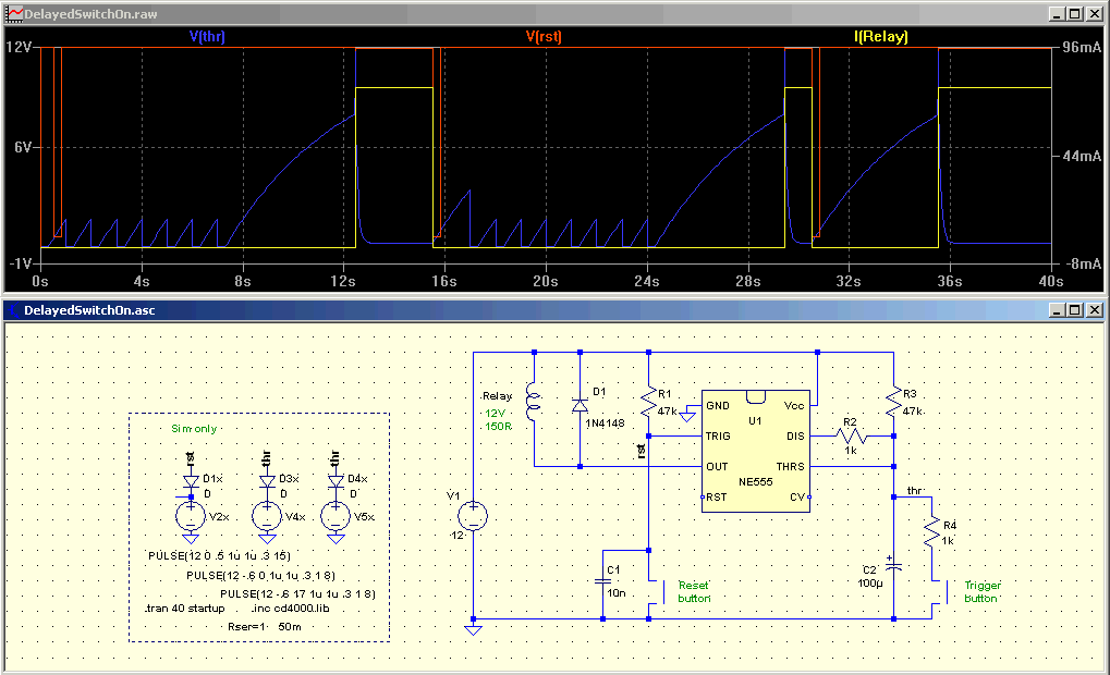

If I've understood your requirements this should do the trick:-
This is for 12V. 24V would be too much for the 555 IC.
Time constant R3C2 determines the delay before the relay energises. R3 could be replaced by a potentiometer. R2 and R4 limit the C2 discharge current.

In your circuit if I press the reset the timer starts, if I keep pressing the trigger button the timer keeps restarting.
If I press both buttons and keep pressing them the time keeps restarting.
when the trigger button is not pressed for a few seconds the relay sets.

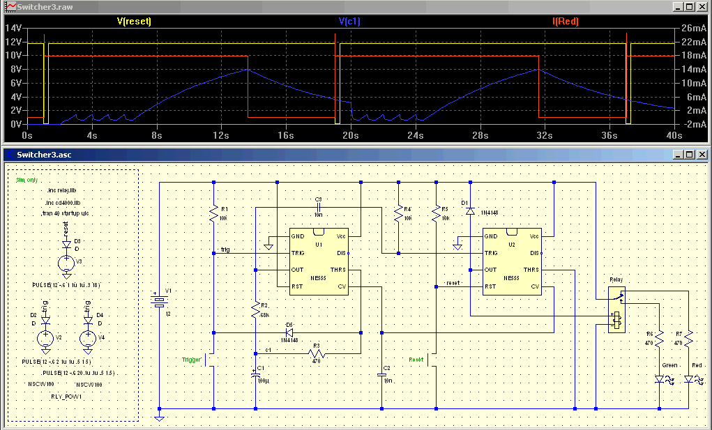

Here you go. I think this is what you want. The sequence is more complex than I originally understood you to want; hence the use of a second 555. You could, of course, use a 556 instead of two 555s, and the LEDs shown are by way of example for lights. Vary R2 and/or C1 if you want to adjust the timing.

Hi Alec,
Sorry about the delay, I have been meaning to purchase a 556 for a while, I got chance yesterday and built the second circuit you sent me today.
It is perfect and exactly what I wanted, I owe you a debt of gratitude.

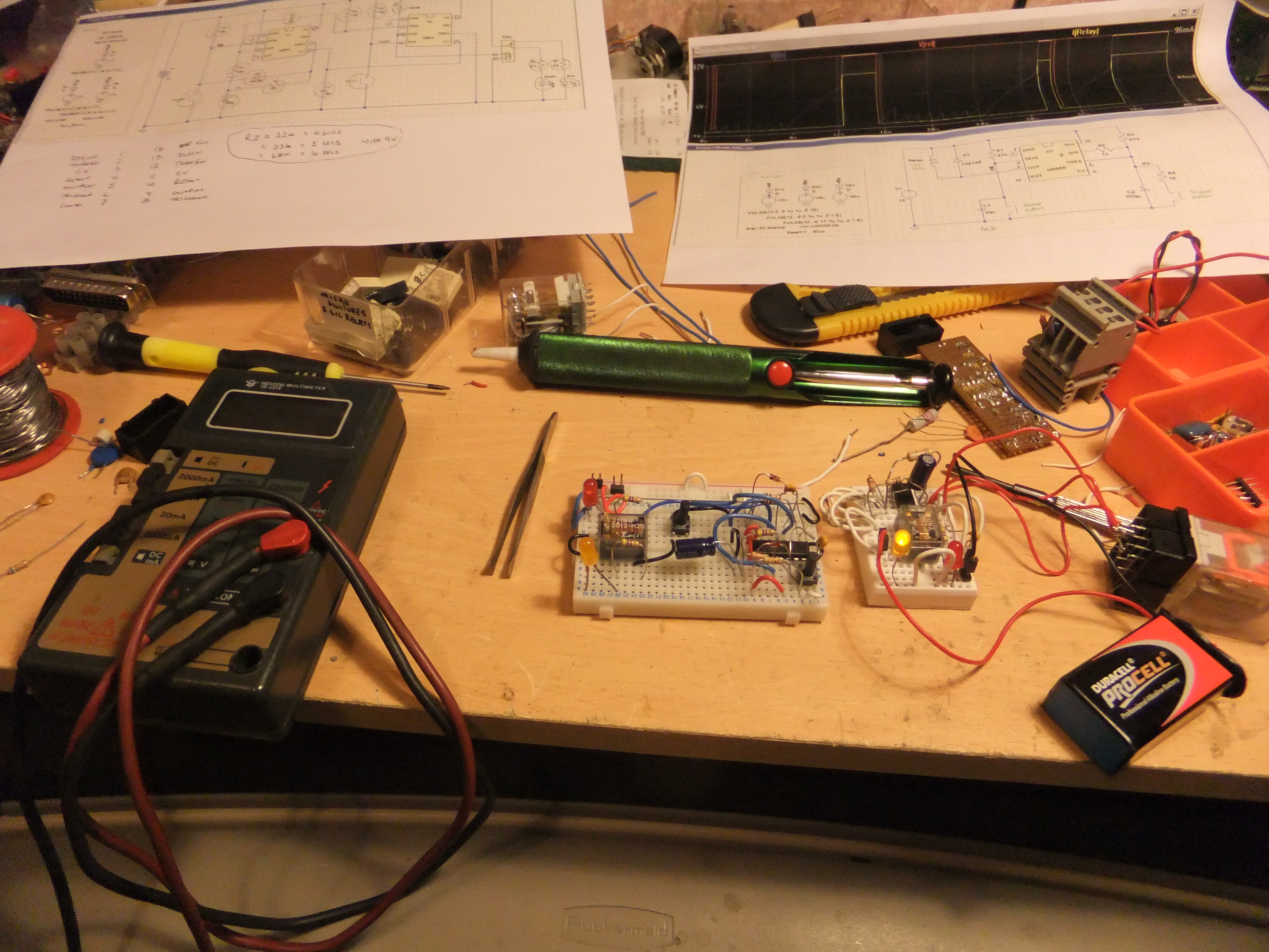

The circuit will eventually run a larger circuit but the small relay on the circuit board will be the interface to the final circuit and it will run from an external 24 volts so current is not too much of an issue.
I have sent a photo of both of the circuits set up on blob boards.
Again thank you.
