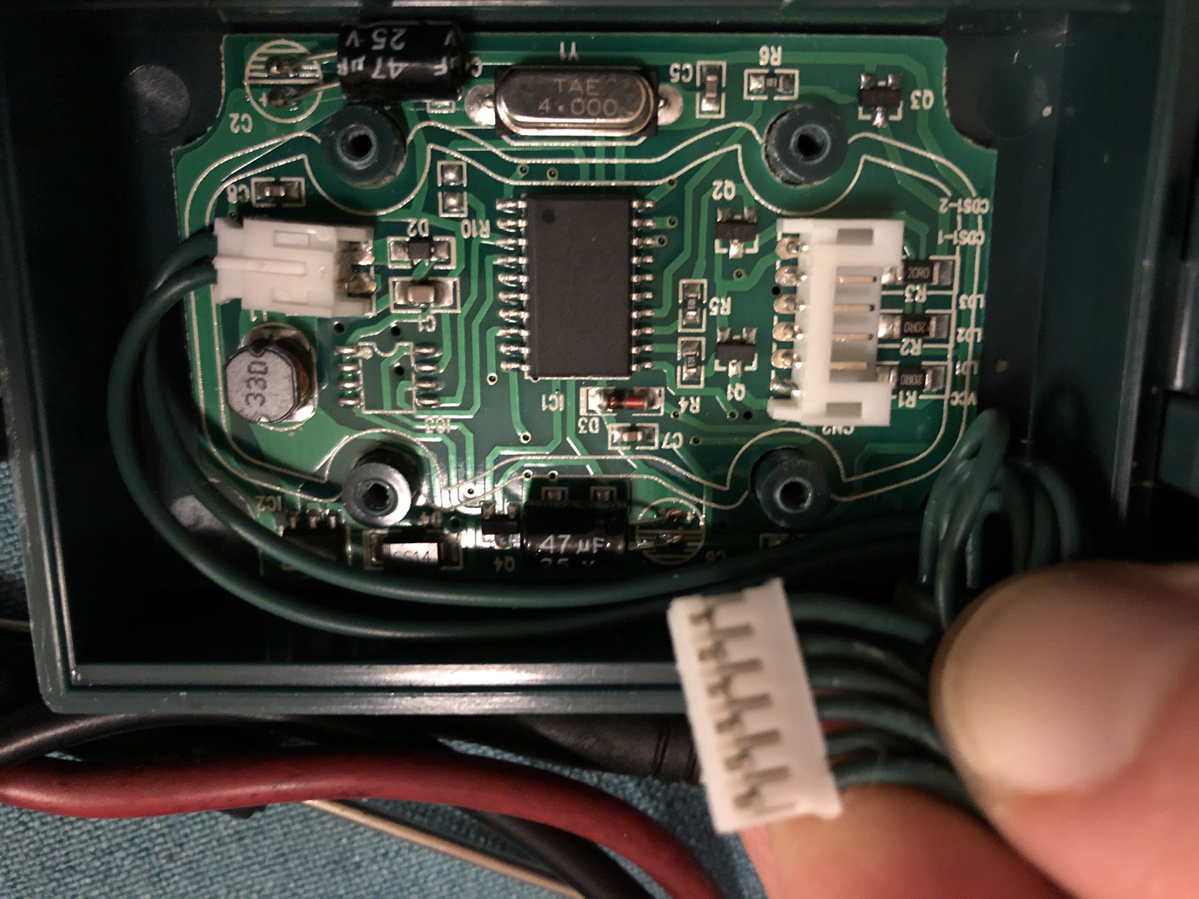

Is it possible to wire a standard two wire light string to a DC controller box and still utilize the timer and photo sensor features?

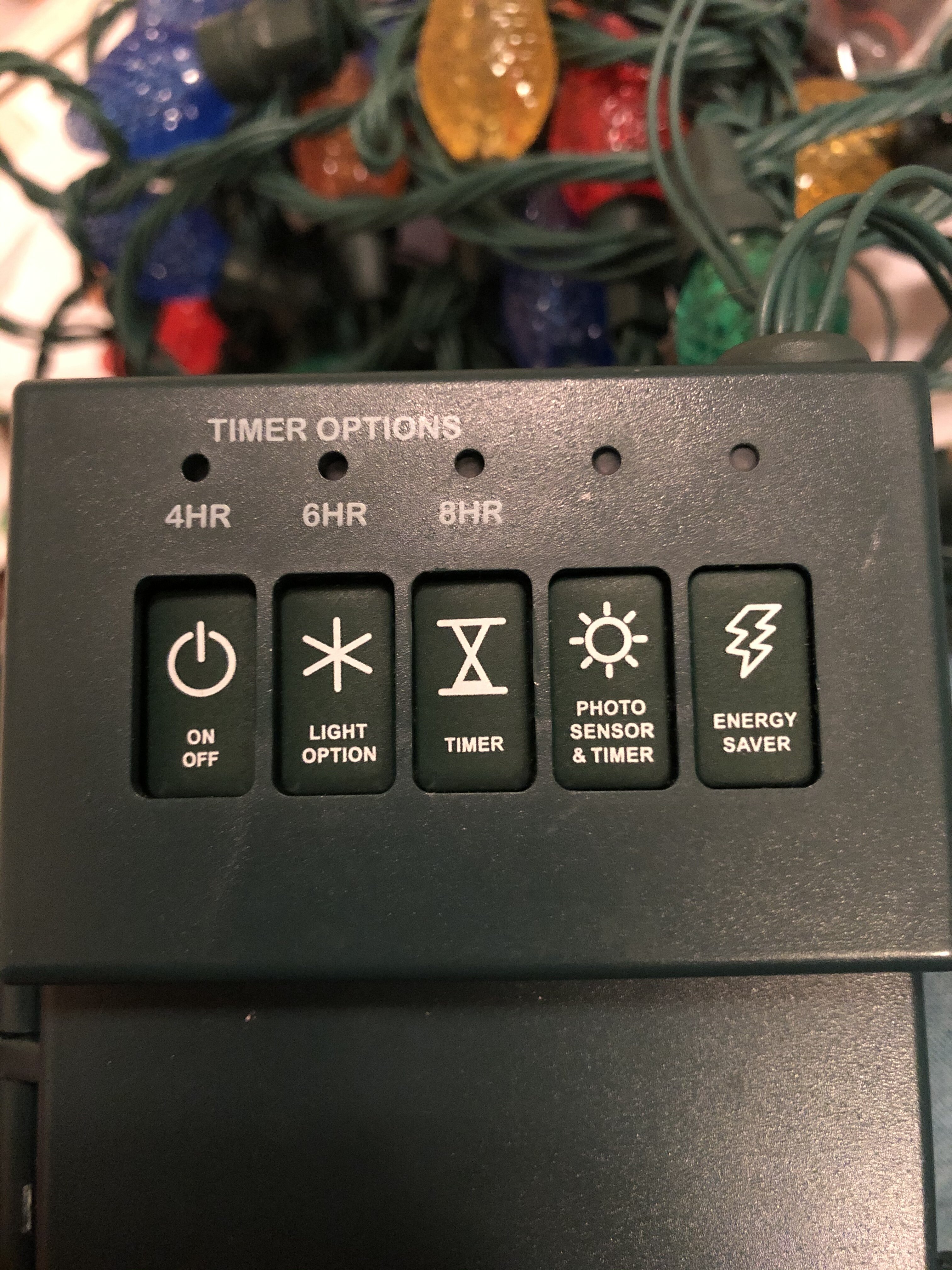

I purchased this to go outside my wife’s room at the nursing home for Christmas. Since covid we aren’t allowed inside so it needed to be battery powered and weatherproof. Since it has a timer triggered by a photo sensor it’s also very efficient. Ran almost 3 months on three D cells.

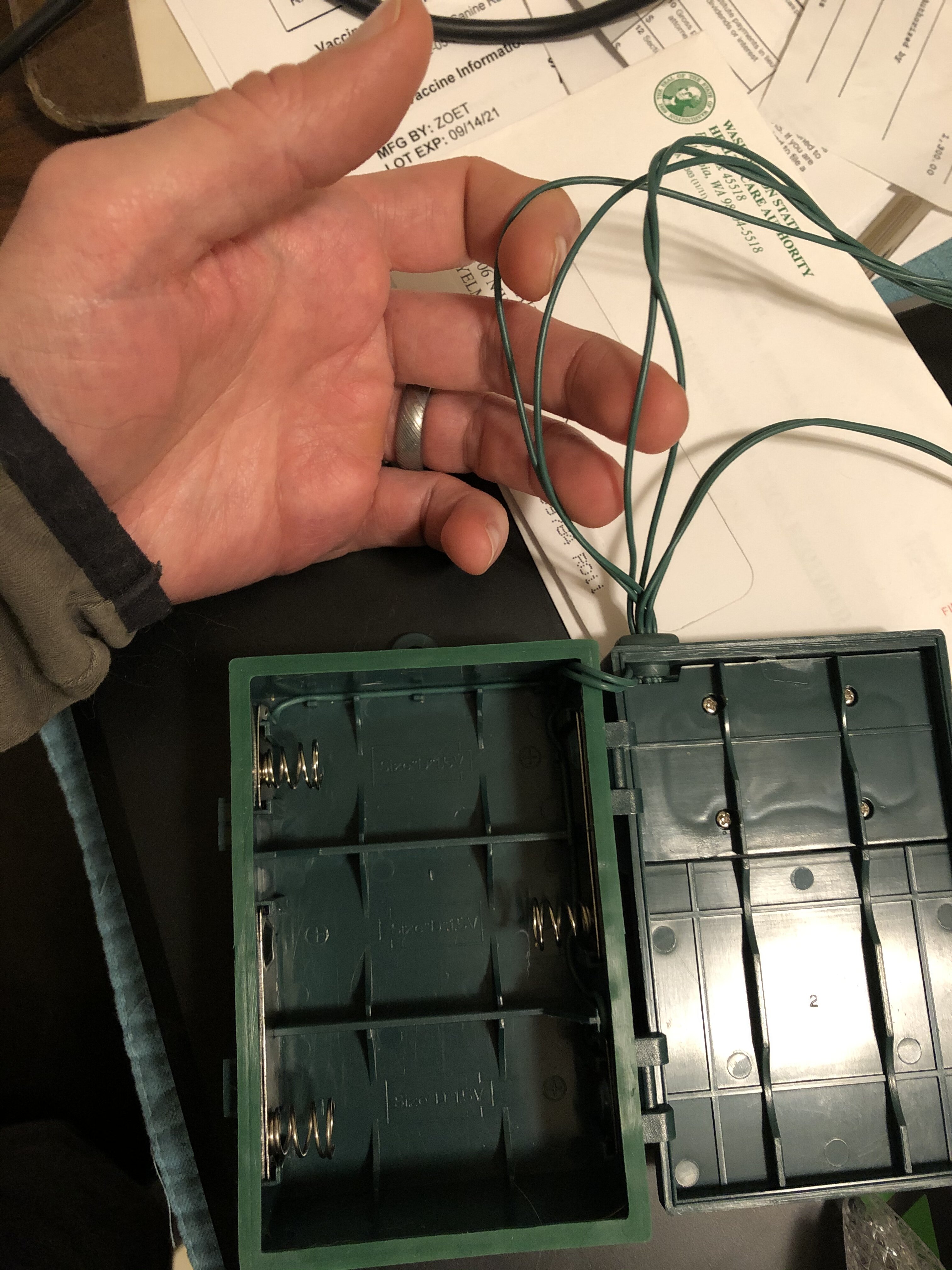

I’m hoping to be able to change the lights out to run holiday appropriate colors throughout the year or just purple, her favorite color. The light string itself however has four wires (another two go out separately to the photo sensor). I suspect the extra two wires on the lights carry the signal for the timer/sensor. Unfortunately I’m not finding any stand alone string lights with four wires I could swap and crimp 1:1.
Can I somehow hook up a standard two wire string and cap or jump the other two or would I have to pretty much make my own string with 4 wires?
To me, it looks like the lights are arranged in three strings or chains, to allow different colours or flashing patterns & sequences?
One common positive power connection (VCC) and three separate returns that each have the negative switched to control them; LD1, 2, 3.
The CDS1 terminals look to be for a light dependant resistor, the photosensor.
