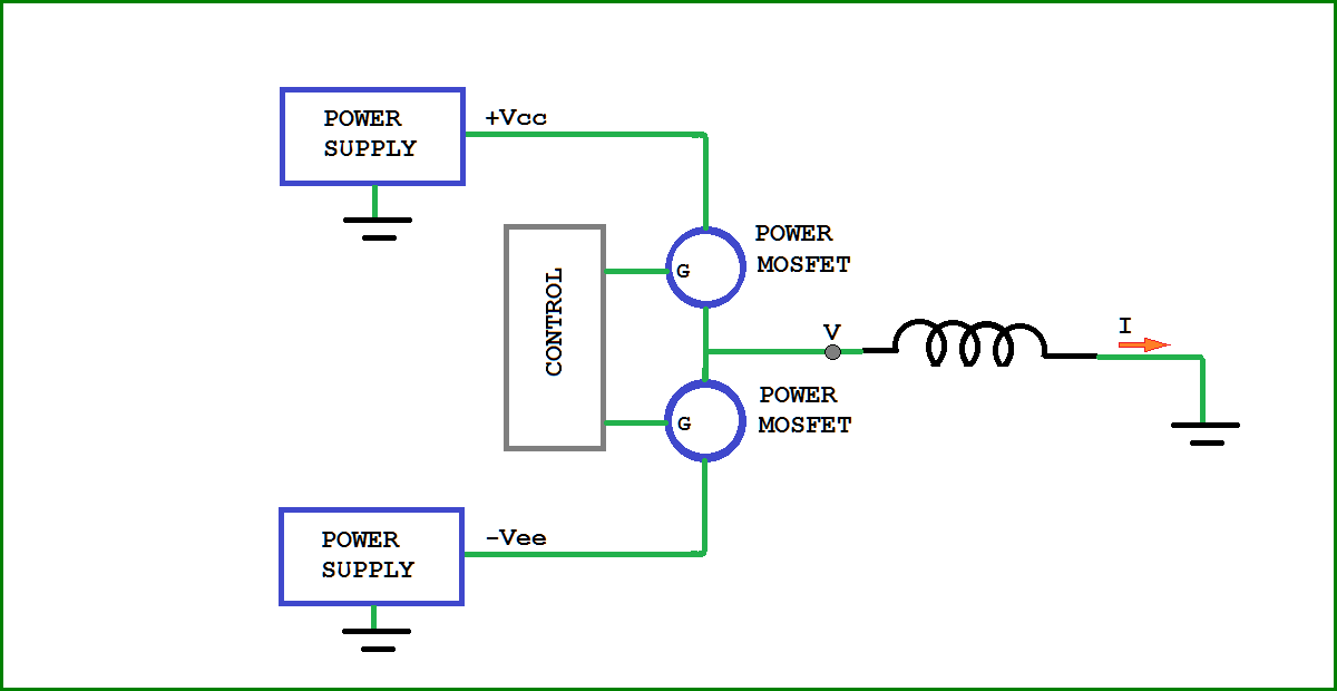

Anyway, here is the drawing i mentioned. As you can see it is just a basic block diagram showing how the components would be connected together. The real work to be done is to devise a method that enables setting the required test parameters, and a method to drive the test set up to that test level. For example, if we want to test with a 10 amp DC current we would want to gradually increase the power supply voltages with one voltage higher than the other (one is negative and one is positive, but "higher" here means larger absolute amplitude of course).
Obviously the two power supplies have to be adjustable too, so that their outputs can be varied as needed. I suppose that would be easy enough to measure however. The timing would be set by the "CONTROL" circuit that also contains appropriate MOSFET driver IC chips not a home made driver or parallel CMOS gates or other cheats.
Granted this isnt the simplest thing to build but then again we want to do a good test on the inductor so it takes a lot more than a simple DVM and 9v battery to test <smile>.
If you wanted to try this out first you could build a knocked down version with smaller power supplies and just test lower current inductors. If that works to your liking then you could beef up the circuit. The control would be the same however, it has to be fast and we have to be able to vary the high going pulse and the low going pulse lengths as needed via some control like with a micro controller or something.

Hi again,
Oh sorry i must have been in a hurry and didnt upload the schematic. I am uploading it to this post now.
Take a look, and you can see how simple it is.
If you want to modify that's up to you of course.
Ahh I see what you're getting at I think. yes a half bridge, I was thinking instead of a bipolar supply, the upper switches to +v, the lower to 0v, and the other side of the inductor is fixed on a low impedance supply (say... 2V), but the principle is still the same.
By varying the power supply, or rather (in your diagram) the difference between VCC, GND, and VEE, we will get varying slopes of current through the inductor, but what are we measuring here? If we fixed the voltages and timing pulses for the switches, that only leaves current to be measured. Perhaps with all voltages fixed, if we use current mode control (turn off top switch when current in inductor reaches a threshold) we could measure the frequency of oscillation? That really will be like making a buck, plugging in an unknown inductor, and letting it run. By increasing the peak current we would see it go into saturation, and the frequency should increase non-linearly. Is this what you're thinking? or have I missed something?

Hi again,
Well it seems to me that if you want to test for saturation with a DC current (makes sense to do so) then the power required to do that will be lost no matter how you do it unless you use bootstrapping. The reason i say this is because the DC has to be constant and so it wont be able to supply any power back into the power supply line.
So one way to do it would be to build a variable buck circuit with normal output cap and some resistive load, and then another converter to convert the output back to the power supply level. So it would be a buck circuit powered from the original power supply followed by a boost circuit powered by the buck circuit and the boost circuit would in turn power the original power supply to return some of the energy taken from the output of the buck. Might be a little elaborate though as the boost circuit has to be able to handle the power taken from the buck circuit. There would still be some losses of course due to the inefficiencies of both circuits.
