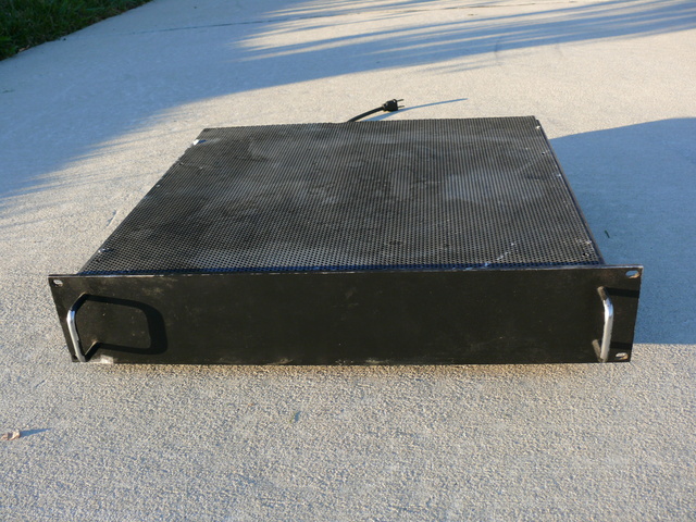

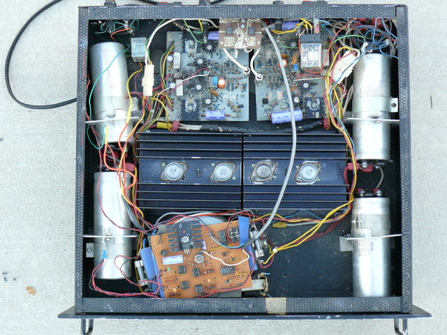

Sunn Amplifier Power Amp Puzzle
Just a thought Bud,
Did the original transistor have an mica insulator and did you recuse it and use thermal grease with the replacement trans. ?
Added: What trans are you subbing with and what was th eoriginal number?
Someone had said the big caps usually don't go bad, and I didn't have any those size, but in looking at them now they are only rated 50V. Not much headroom on a +/- 45 supply. Plus I'm assuming you guys agree that 2vp-p ripple when the supply's not even all the way up is too much, yes?
I think 2 V p-p ripple is too much and I know the "hard way" that 50 V is too little. At 33 years your pushing it.
I'm assuming that the big caps are can type. Mouser has some: https://www.mouser.com/Passive-Comp...0wlgmZ1z0wla7Z1z0wqfaZ1z0wqsuZ1z0x7xmZ1yx4atu
You can always increase the capacitance.

Hi Pfofit! The originals had mica insulators with thermal grease. The replacements came with silicone pads. I decided to use those temporarily since I'm still in troubleshooting mode and I'm not pushing the amp at all as I know it has several unseen issues.
The originals were SJ954's opposite 2n3055's. Now I'm still using the 3055's (new ones) but the SJ954's I subbed with MJ2955's. When the amp is done, I'm going to put better brands in, but for testing I picked up 6 each of them from China. There are 3 power transistors on each side, so I know they do work. I've already blown two of the 2955's but it was my own fault.
Thanks for joining in. The more input the better ;-)
Actually, I had said "can" just speaking loosely, but they are axials. I re-ran your search changing to "axial" and only 2 results, neither in stock, and neither with a minimum of < 1000. I appreciate your checking there for me, in any case.
I think my Digi-Key search was for 3000-4000uF. It's amazing how little comes up for axials in that cap range. You still think 63v is pushing it?

I ordered these and some low-ESR 10uF ones, too.

Well, it's been a somewhat rough couple weeks. My cat's still sick and will likely be leaving us soon. But today I found time to get those big caps in. I'd bought low ESR 3900uF 80V caps. Sunn was cool enough to have holes and solder pads already there for them, so that was a nice surprise.
Replacing C16 and C17 got rid of the 1.5v and 2v ripple. Now the ripple at C16 and C17 measures in the mV range ~200mVp-p on one and ~80mVp-p on the other, which I'm guessing is just fine.
At 75VAC at the Variac, the +/- 15vdc supplies read somewhat close to each other @ +14 and -13. I kept cranking the AC till I got the plus side up to +14.9 with 90VAC (didn't seem to want to go a full +15 so I left it there). However, the minus side still read -13vdc.
I'm not 100% sure I changed C13 so I'll change that soon just to rule it out.
I figured out I could plug my Kill-A-Watt into my variac to measure current (since you had said a current meter at the variac would be a good thing). Amp drew about 110mA in the foregoing situation. When I cranked things up to 90VAC it drew 130mA or so. At this point the 40W bulb in the limiter did get pretty bright for 1/2 second at power-on then continued to glow very faintly (barely perceptible in daylight). I don't like the sudden flash, but I guess that's normal till IC1 kicks in and balances the output transistors?
I don't know why that negative supply doesn't want to move up to -15. The rails read dead-balanced at all voltages tried so far. I don't know what's causing the imbalance in the regulated +/- 15vdc supplies. I've already changed the zener and TIP30 to no avail.
I'll post later as to whether the numbers improve after I change c13 . . .
Check voltage across CR5, Check R25. Check the voltage across C13. The -15 V ripple.
Compare the voltage drop across R23 to R3. For now.
Things don't look too bad.
I'd really like you to place a short across C13 and get the same numbers you got before. e.g. the +-15 V supply values and the line current at 90 VAC The current measured should go down.

Figured I'd do that before changing C13 for a before-and-after. With the Variac @ 90 VAC:
CR5 Vdrop: 13.58vdc
R25 Vdrop: 4.22vdc (resistor measures 132 ohms, which is right at the upper end of its 10% tolerance)
C13 Vdrop: 3.32vdc (C-E of Q13)
R23 Vdrop: 17.2vdc (.1 to .2 a bit jumpy)
R1 Vdrop: 15.05vdc to 15.1vdc (a bit jumpy)
R3 Vdrop: 12.44vdc (Turns on at 11.8vdc. Then, after a 3 sec pause, rises to 12.44vdc over the next 4-5 secs)
Couldn't really bring up a measurable ripple on the -15vdc supply. I will say that it looks "noisy" but I'm using a new digital 'scope, which I'm not used to, so I don't really know what it's supposed to look like. The "measure" function says there's around 20mVp-p, but very jumpy, noisy, doesn't look like a sine or sawtooth, doesn't dial in at 120 hz either.
Interesting that the drops across R23 and R1 vary by about 2.1vdc, which is the same difference by which the regulated supplies differ, just about (+14.9 & - 12.9 unbalanced by 2vdc).
After I found C13, I do think it's one of the few (if not the only) electrolytics left unchanged. I'll do that soon . . .
Thanks for all the input!
Bud
One more voltage at 90 VAC: Voltage across R21 and R50;
R21 Vdrop: .2mV
R50 Vdrop: .lmV
Not sure how accurate my meter is down that low, but with the power off they each read 0.0 and these are the readings I get with 90VAC. That's the last decimal place on my meter, so it could mean .14 & .16 with traditional rounding, but I doubt it's that accurate in any regard. I suspect as long as these voltages aren't very high then things are kosher?
Thanks. The amps has no idle current yet and I think it should by now. R21/R50 should have 90 mV per the schematic. See the 90 mV note in the bottom right corner.
Right now, I think that your -15 V supply is being overloaded because of another problem.
