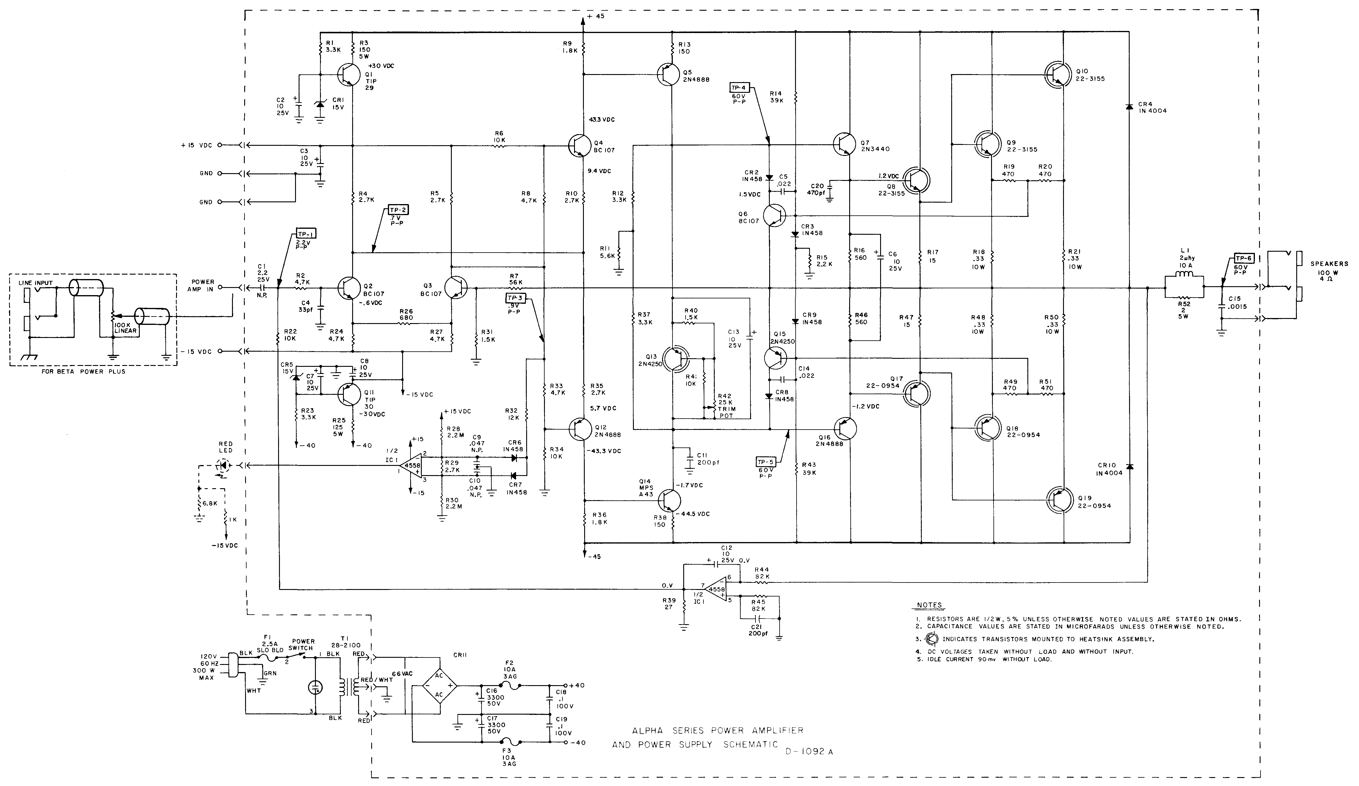

Hi All,
I was working on the Power Amp board of my Sunn Beta lead to find out why the -15vdc supply was only reading -13vdc.
Wondering whether IC-1 might be partially shorted and dragging down the voltage, I pulled it from its socket (see attached schematic) so I could power on the amp for 2 seconds and take a voltage measurement. To me, judging by the schematic, this seemed like a harmless enough move (note: I'm not an advanced tech, maybe a step above a novice).
Well, the second I turned the amp on to take the measurement, I got a horrendous hum from the speaker. I powered down and found Q19 blown.
My question is . . . why? What did removing IC-1 do to the circuit that caused the output transistor to short out? To me, IC-1 seems to be taking inputs for monitoring purposes only.
Thoughts?
Any thoughts/input/ideas appreciated,
Bud
You apparently only looked at the upper 1/2 of IC-1.
The lower 1/2 of IC-1 at the bottom of the page is an integrator in a feedback loop that maintains the DC bias at zero volts at the output.
Without that the bias goes open loop and the output likely slammed to one of the output rails which probably blew the transistor due to excess current.

You're absolutely right. I did initially overlook the 2nd half of IC-1, but being kind of a newbie I still didn't understand why it blew the transistor. In analyzing it after, I didn't see it as part of the feedback loop. I'm learning a lot by trying to fix this amp. I put in a sacrificial output transistor and it blew right away on re-power-up, as I half expected it might. I had tested all the nearby diodes and transistors and had found no shorts. But the bias transistor looked a bit funky testing it in circuit, so I will pull that later and test it out of circuit.
Interestingly, I found Q15 with two cracked socket pins while looking things over. The socket had been loose, I noticed, in earlier tests, but I wonder if the over-voltage finally cracked those pins or if it's just coincidence. Oddly, the transistor itself reads fine -- hfe is within range, etc.
As for the -15vdc supply -- it's generated in the Q11 circuit with its associated Zener. I can "trick" the voltage up to -15 with three 1n400x diodes in series with the Zener and the amp behaves much better, Q11 and its power resistor run much cooler. Nice to know I can do that, but my main reason for working on this old amp it to learn electronics. So I removed the 3 1n400x diodes I had put there and went searching for the real problem a few days ago. That was when I committed the folly of removing IC and now causing problems on my PA board. I think I'll have the PA board back to where it was soon, but I'm still curious about what might be dragging down the -15vdc supply. Disconnecting the preamp board has no effect, so it's nothing there. That's why my eye landed on IC-1 (well, HALF of it!)
I have a LM1458 I can put it its place once I get the PA board back to where it was. Then I can test that -15 supply again and see if it's where it's supposed to be. I also wonder if the cracked socket of Q15 was causing it to read low?
But first I have to trace out why Q19 keeps blowing. I'll update as I go along. In the meantime I'm open to all thoughts/ideas/suggestions. I'm trying to learn!

...........In analyzing it after, I didn't see it as part of the feedback loop.
It's strictly DC negative feedback to stabilize the DC output voltage.
It supplements the AC/DC feedback going to the base of Q3.
Any deviation of the output voltage from zero, causes the op amp integrator output voltage to change the voltage at the amp input in a direction such as to bring the output voltage back to zero.

Thank you, Crutschow, for that explanation. I guess that is the meaning of the 0.v notation at both the output and input of that half of the op-amp. I had been wondering about that.
I must admit I get pretty disheartened when I blow something up, but I do always seem to learn something from it.
I'm going to go pull that bias transistor now and test it out of the circuit . . . along with a few other components that are suspect. I'll post an update afterward. Thank you for your help. I like learning!

I was hoping to find a bad diode or transistor (or something), but did not. I pulled CR4, CR10, Q2, Q3, Q6, Q13, Q15, Q16, and all the power transistors from the circuit. They all checked out fine. Couldn't find any bad caps or out-of-value resistors.
Since Q19 blew the 2nd time exactly as it blew the first time with the op-amp out of circuit, I'm thinking that when I put the op-amp back in the circuit (before I found Q19 was shorted) maybe this blew the op-amp?
I could put in a new op-amp, but I'd hate to blow Q19 again. I have several sacrificial output transistors, so that's not my concern. I'm more concerned that blowing it will take out other stuff. So how does one go about this? Is it possible to power-up this board without the power transistors in place to test voltages on the op-amp? What is best practice here? Or are techs sometimes forced to do a "smoke test" in certain situations?
Thoughts?
It's possible that the op amp was damaged since there's no particular protection against input overvoltage.
Powering up a circuit without all the components is problematic, as you found out.
The way such failed electronics are often tested is with a Variac variable AC transformer.
That way you can slowly bring up the AC power while watching the circuit voltages and current, and hopefully find what is wrong before blowing something.

I'll find and build a simple circuit that tests op-amps
All you need is a simple follower circuit with the (-) connected to the output.
You then put a varying voltage into the (+) input.
The output should then follow the input over the op amp common-mode range, if it's working properly.
You can even do this test with just one power supply and ground.
Thank you, Crutschow. I breadboarded this one: https://www.diystompboxes.com/smfforum/index.php?topic=63394.0
I built it with a known working LM1458, then tested the op-amp that was on the PA board when the output transistor shorted. It tested perfectly with a 9V source. The numbers were dead-on.
At this point, the only known failed component when Q19 shorted the 2nd time is Q15, which I later found had two cracked socket pins. I've since soldered this directly to the board, but I don't think it was the problem, esp. since the 2nd failure of Q19 was exactly the same as the first, making me think something in that DC-feedback circuit is still not right. As I await the variac, I'll study the schematic and try to see what else might've been taken out. A bit stymied at this point . . .
