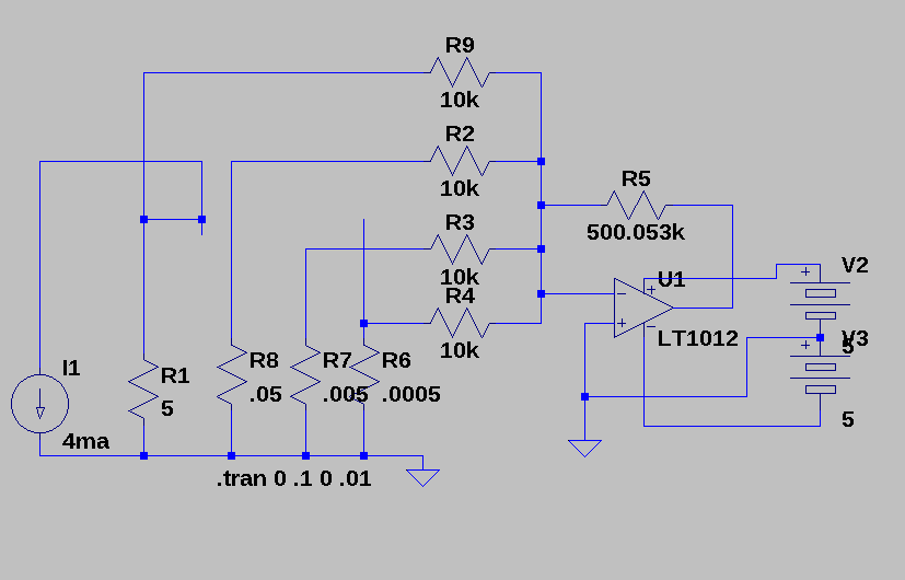

I am thinking of using a summing op-amp to connect maybe 4 alternative current shunts to a single output, instead of using some kind of switches. Since each input will have a very low resistance source, will this affect the accuracy of whichever shunt is providing the signal? (Since as far as any input is concerned the other input resistors will effectively be creating a potential divider to ground) Lowest value shunt is 500μΩ, largest will probably be 0.5Ω.

If one end of every Shunt resistor is to 0V and the 'high' end of each shunt resistor has its own input resistor to the common OPA input it should be OK.
Such a configuration will give a high gain for the op amp offset voltage since the gain for the offset is the sum of all the (non-inverting) gains. You thus likely want to use a precision type op amp with very low input offset voltage.
Gain will be either 20 or 50 depending where I connect the output to.
So, it will work ok but the signal could potentially be swamped by offset? Time to fire up LTSpice...
A true summing amplifier has near zero impedance at the summing junction, so it really doesn't matter how low the source impedance of the different signal sources are. They won't affect each others gain.

Actually, now I've said that, with the largest shunt at 5Ω and the smallest at 500μΩ, each input resistor is 10K, the feedback resistor is 500.137K, with -40A through the 500μΩ shunt I get 1V on the output, but with -4mA through the 5Ω shunt I see 19.99mV on the shunt and 999.905mV on the output. Wher'd my millivolts go to??? Is this the offset you were referring to, crutschow?

Could opamp input current flowing through the highest value shunt (5R) give a significant voltage drop?

So in the simulation I calibrated the feedback resistor to give correct values on the highest current shunt, and it's linear when the current is changed, but when the other shunts are tried the voltage across the shunt, and the output voltage get more inaccurate as the shunt value is increased. Just tried a different amp, LT1012, same sort of error.
The bias current is negligible, but the current in the feedback resistor is 2μA - this could account for it, and in fact most of it does flow though the input resistor. How on earth do I compensate for that then?
I used the LT1001 because it's the first one on the list. But surely for a true summing amp the error would be the same for all inputs, so it wouldn't make any difference? Even a 741 should be able to do this?
The offset is the same for all inputs but each input amplifies the offset by a gain of 1+500k/10k = 51 at the output giving a total output offset gain of 51 * 4 = 204.
2μA through any of the shunt resistors has negligible effect on the shunt voltage.
How accurate do you need the measurement to be? The error you mention back in post #7 of this thread is off less than 0.01% of the 1V nominal.
Ideally I'd like it to be within 1μV or better when it reaches the ADC - so as far as the output from the summing amp is concerned that would be within, er, 400nV. The trouble is, every stage introduces some kind of error, and whilst I hope they cancel out, they are just as likely to add. So I want to understand every error so I can minimise it. As I will have no standard against which to calibrate this beyond what I can build (unless I can find a friendly owner of something!) my options are more restricted. My budget is practically non-existent, which brings it's own limitations. The 95μV error in post #7 is just too great. It wouldn't be so bad if all the shunts produced the same % error. Thinking about it, it's a moot point anyway since I'll have to trim each input resistor. Still cheaper than using relays though and ultimately more accurate.
