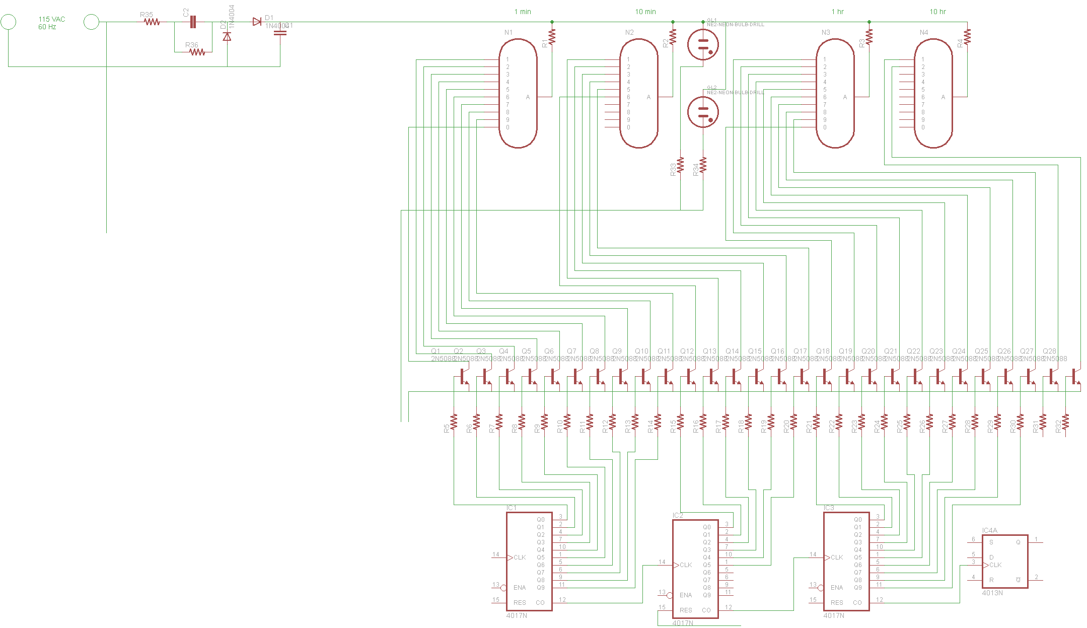

Hi crustchow,
I have been looking at nixie clock circuits. I am modeling mine on Mike Harrison's. I am attaching what I have so far. I am pretty much following his design but I want to understand what each part is doing instead of just throwing it in there.
It is a little more tricky than I had first assumed. Especially the hours. I have settled on using 4017's for the minuets and one's of hours and a 4013 for the ten's of hours. Reseting the one's of hours still eludes me but I am fairly certain I will figure that part out pretty quick.
The part that I am avoiding for right now is the input signal. I am still weighing my options. I have been reading for about an hour about using crystals and dividing the signal down which in my mind would have a cleaner signal (square wave). The other option seems pretty straight forward, use the 60hz the city supplies me and divide it down with a couple more 4017's (which would make adding seconds almost automatic). My major concern with this option is how clean and accurate the signal is. I assume but don't really know that the 60hz signal that comes out of the wall is sinusoidal and would need to first be squared off... I guess that doesn't sound all that bad. I will have to read up on it tomorrow.

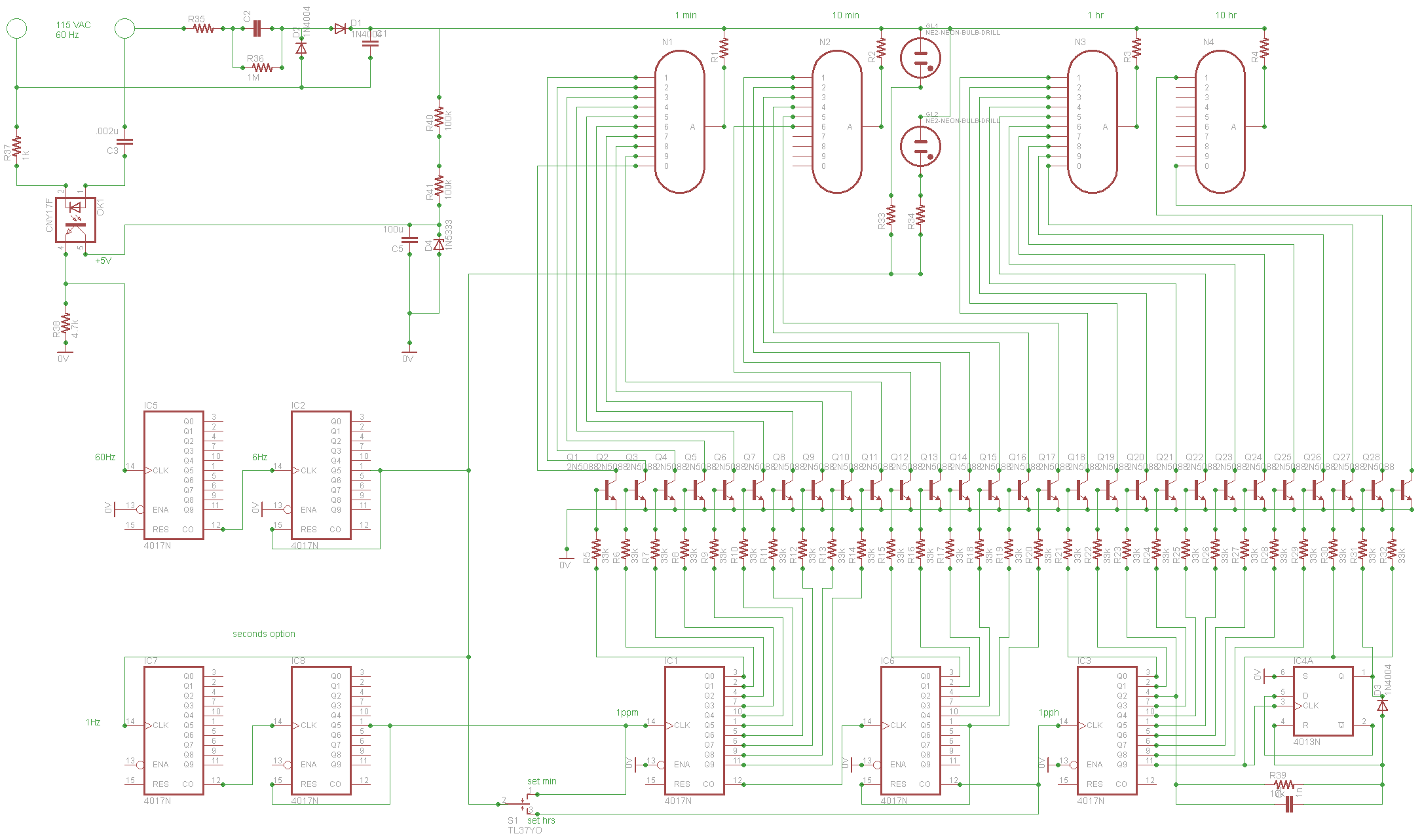

Alright, I downloaded Eagle and played around with it this week. I have what I believe is a complete schematic but almost none of the components are correct (I couldn't find the correct components in the Libraries). Can I post what I have here and get some advice from everyone?

I have used a number of place holders here in order to be able to draw the darn thing out. I will now have to go back and replace them with the actual devices assuming they can be found. Here is a list of items I couldn't find.
OK1 should be NEC2502-1
Q1 through Q28 should be MPSA42
N1 and N2 should be B-5440 (Nixie tubes with 2 anodes)
N3 and N4 should be B-5441 (Nixie tubes with 2 anodes and 2 decimal points)
S1 should be a momentary toggle or rocker switch attached to the back of the clock to set min and hrs. any suggestions concerning alternatives would be more than welcome.
I don't know what part numbers (taking into account tolerances, volts and all those considerations) to use for any of the capacitors, resistors, diodes and the zener diode (D4). As a matter of fact I don't even know what values I should be using for the diodes. I know their function and I kind of know how they work but I have no idea how to give them values. Also, the capacitors my be in the wrong orientation, I wasn't aware until yesterday that cap's had pos and neg sides (I guess I should have though).
The Power supply scares me so if someone would give that some special attention I would appreciate it. Especially where I am trying to supply +5v to OK1 and how to get the 0v's tied back into the circuit.
For the 60hz clock I used Dave Johnson's drawing from over at Discovercircuits.com and the rest I got from Mike Harrison over at Mike's Electric Stuff I tried to use only the parts that applied to a 115vac 60hz supply.
Thanks in advance and if this is to involved for a forum let me know what I can do on my end to make it less complicated.

This is it.
S1 should be a momentary rocker or toggle switch that will get attached to the back of the clock housing
N1 and N2 are B-5440 (Burroughs nixie tubes with 2 anodes)
N3 and N4 are B-5441 (Burroughs nixie tubes with 2 anodes and 3 decimal points)
All the values I have for resistors, capacitors, and diodes were swiped from the drawings I am referencing but I don't know if any of them are correct and a number of them aren't given so I don't have a lot of the values. Also, I relearned today that capacitors have a + and - side. I had forgotten that so some of my capacitors may be oriented incorrectly.
I used Mike Harrison's schematic for the large majority of mine and Dave Johnson's schematic for the 60hz signal.
I can say with some confidence now that I know the difference between designing and engineering.

I have one additional question. How do I tell Eagle that I am plugging this thing into the wall? I keep getting the error NO SUPPLY.
Regards,
dale
It means that one of the chips has a pin designated as class 'power' (ground is also in this class) which is not connected (Eagle knows it has to be connected to something.). Usually it's sufficient to attach a net to the pin and give the net a name. Some chips have a separate symbol for the power/ground pins. If some of the chip isn't anywhere on the schematic, use the 'invoke' command to make that section appear.
Do the 4017 and 4013 chips need power? It makes sense to me but I was talking to one of the guys at work and he said they probably don't. I don't mind invoking one but what then? Do I supply 5v to that pin? Am I doing anything right?
The chips aren't connected to the mains, but they don't work on air. They have a power and gnd connection.
Look in the Help section for the 'invoke' command.
OK, I invoked PWRN which gave me 2 pins, VDD and VSS. I connected +5v to VDD and 0v to VSS. That eliminated all my errors, now I have a bunch of warnings on those same pins.
I can live with that. Can someone look over my schematic and help me solve the numerous problems with it? Specifically the values for the resistors, capacitors and diodes.
Ok, I think I have most of this figgured out. I am still not sure about the circuitry surounding the 10hrs nixie ( that's a jumbled mess I need to spend time on. And I don't know the math to find the appropriate Resistances for r1-r4, r33&r34. The schematic I am using says there should be 230v on that top line. I only need 170v to rum my tubes. What is a function that I can use to find these resistance values?
