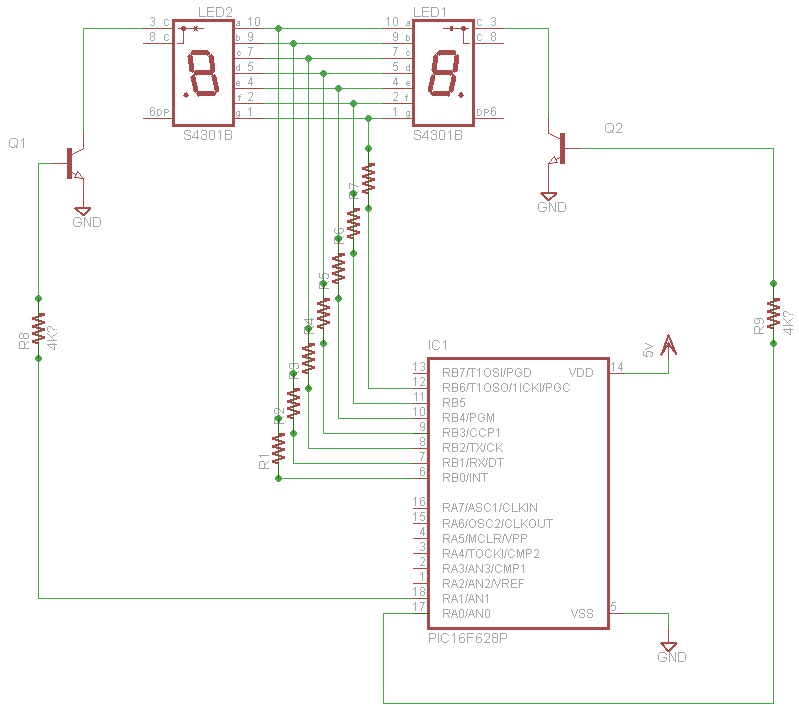

My problem now is that there is a 'ghost image' on the 7 segment displays.
For example:
Segment 1 is displaying a 3 brightly, and segment 2 is displaying a 5 brightly, but segment 1 is also displaying a faint 5 and segment 2 is displaying a faint 3.
So I'm guessing it's the same issue I had with the resistors and the LEDs. So each segment is connected to a NPN transistor, and I'm providing a HIGH value from the MCU to the transistor to ground the segments (common anode). So I started increasing the resistance between the MCU pins and the transistors, all the way up to 4K. And although the ghost image fades, so does the bright image. What should I do?
Here ya go:
You need to turn off the segments before switching the transistor outputs. I'm guessing you switch outputs and then set the segment data or the other way around.
It it still ghosts then you need to post your code.
Don't think that is the issue. The segments are switched via the transistors before the new data is moved to the displays:
That's excatly the problem. Like Pommie said, you must turn segments off before switching digits.
Imagine it, old segment info is active, you switch digit, the second digit gets this old data, then you change segment data and only now second digit gets this new data.
