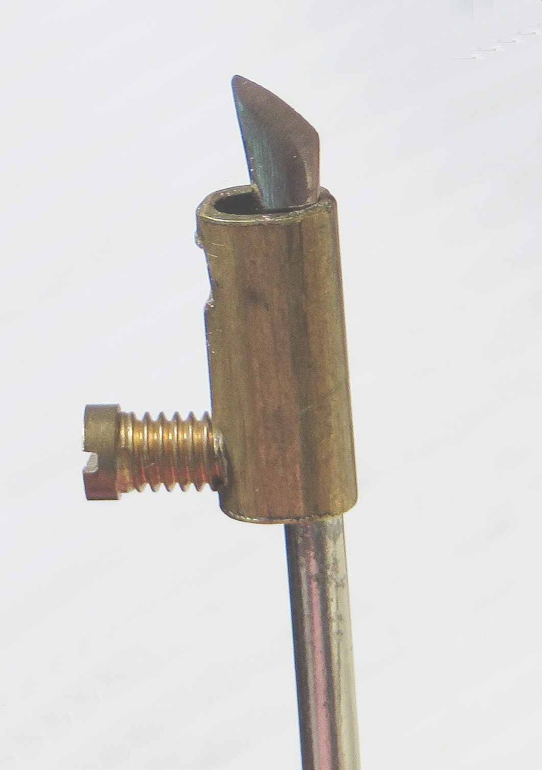

Here's what I use for cutting the outer sheath :
It's a cheapo screwdriver blade with the end ground off at an angle and sharpened. The brass terminal from a chocolate-block connector makes an adjustable depth-stop.
