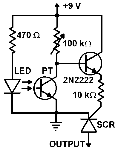

hi all i need help again!!
i have this circuit drawing, which im sure is really easy to put together but i just cant workout the stripboard layout!! im new to electronics and have read a few sites about how to read a circuit drawing but i just cant seam to get my head round in when i come to making. i get the thory but the practical is ....well crap!!
can someone please show me how this circuit should be layed out and how to connect up the scr.
also are there any good websites or books that actually teach you how to read and understand circuit drawings, every site iv seen so far say "join the dots and there you go!!!" which is not much help.
thanks for the help

hi eric,
its just a simple photo flash trigger, the beam is broaken which sets off the scr and in turn sets off the flash light.
thanks for the ad on to the circuit
newbie73 said:
hi eric,
You do realise that once the SCR is triggered it will remain ON?
The only way to switch it OFF is to interrupt the Vload voltage.
If its still not working, measure a few voltage points on the circuit, add them to the drawing and post it.
Eric

Copy and use this strip board GIF.
Eric

Does this help as a starting point?
Eric
thank you eric, that helps a lot. i just wish i could work out how to lay it out on my own. do you know of any good books or sites i can learn how to do that.
cheers, and thank you once again

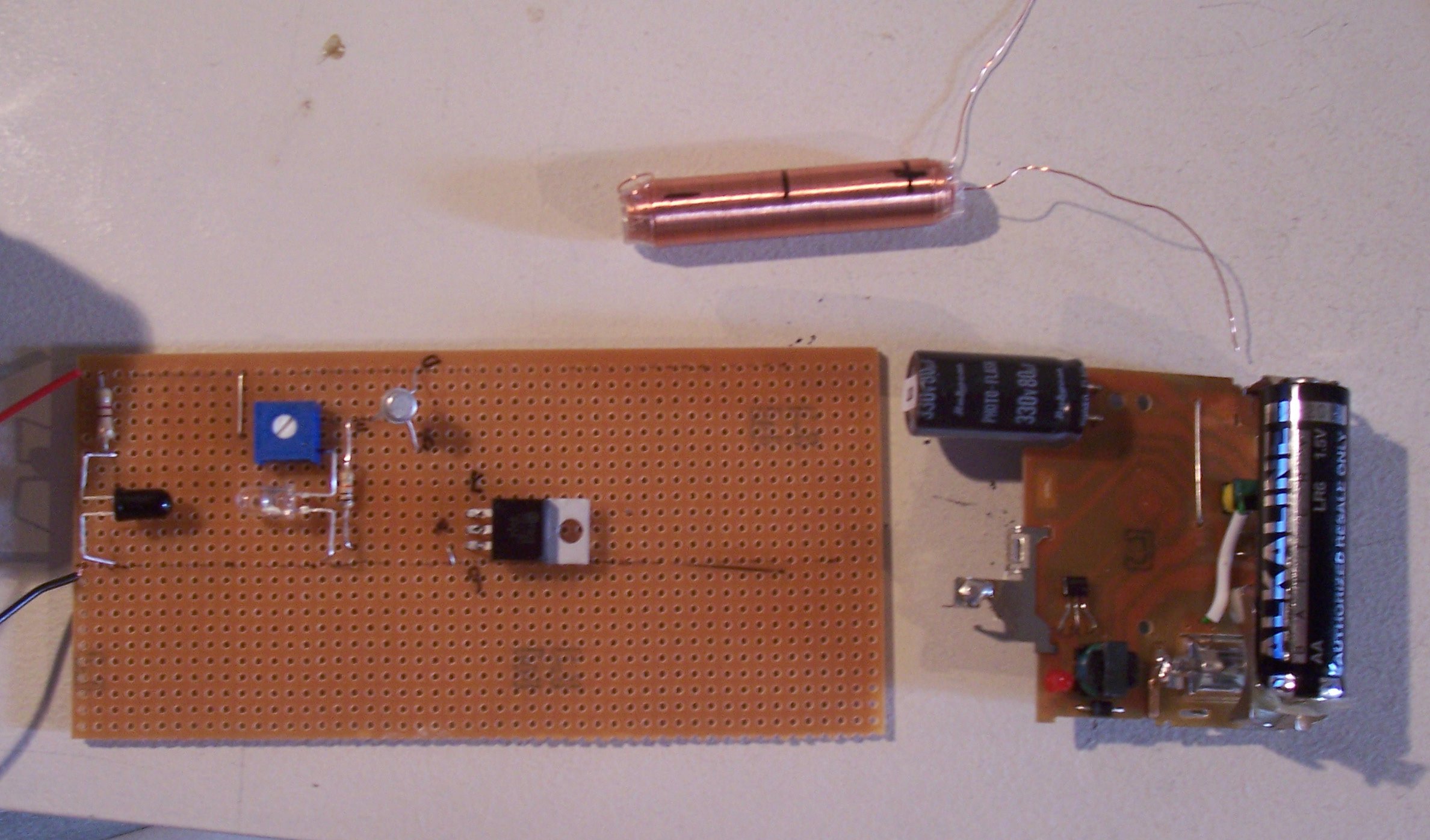

hi
right iv built the circuit but it still wont work. im not sure if i got the pot mounted correctly but the rest is set up exactly the way it is in the layout any idears!!!!!
cheers
ok here are some pics of my set up.
i need the circuit to , when the beam is broaken turn the flash unit on = the flash unit then powers the EM coil or at least dumps its power through the coil.
can some one please tell me where im going wrong, and please use very basic terms and drawings as i really cant get my head round electronics, but i will!!
break beam fire coil from flash unit, thats it!!
any help would be very gratful,
best regards
The resistor on the right ( in your picture ) goes straight to the negative side of the battery, and it shouldn't.
If that doesn't help, post a picture of the other side of the board.
newbie73 said:
ps the red and black fly leads on the left of the pic go to the +9v power, the flash unit has its own power
Look at this pic.
Eric
hi eric,
doh awnsers:
1) the c of the transistor is connected to the + power
2) yep i need to keep out ambiant light - doh will do
3) gate was grounded..
thanks
