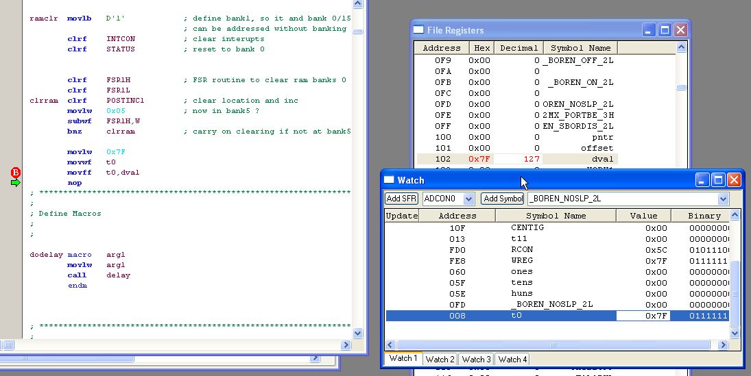

The picture shows the two View windows, in the Watch window you can view selected System Registers and User Registers/Symbols.
Hope thats clearer ?

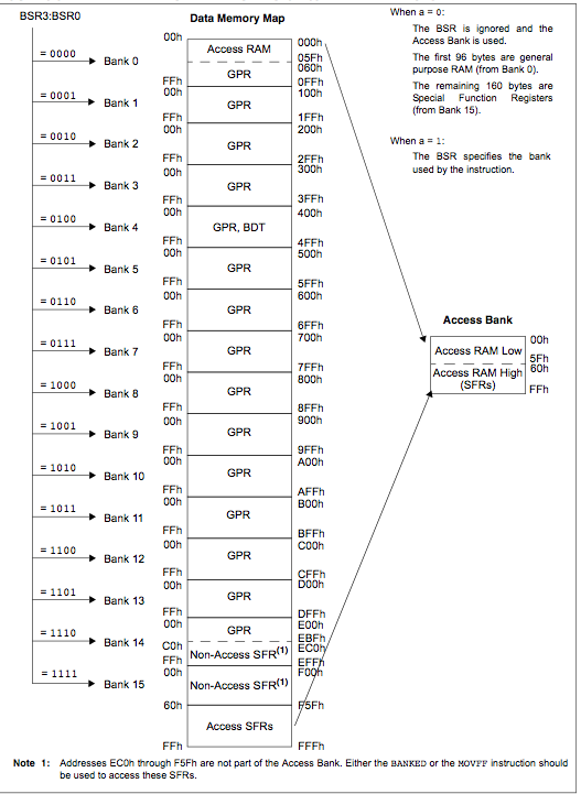

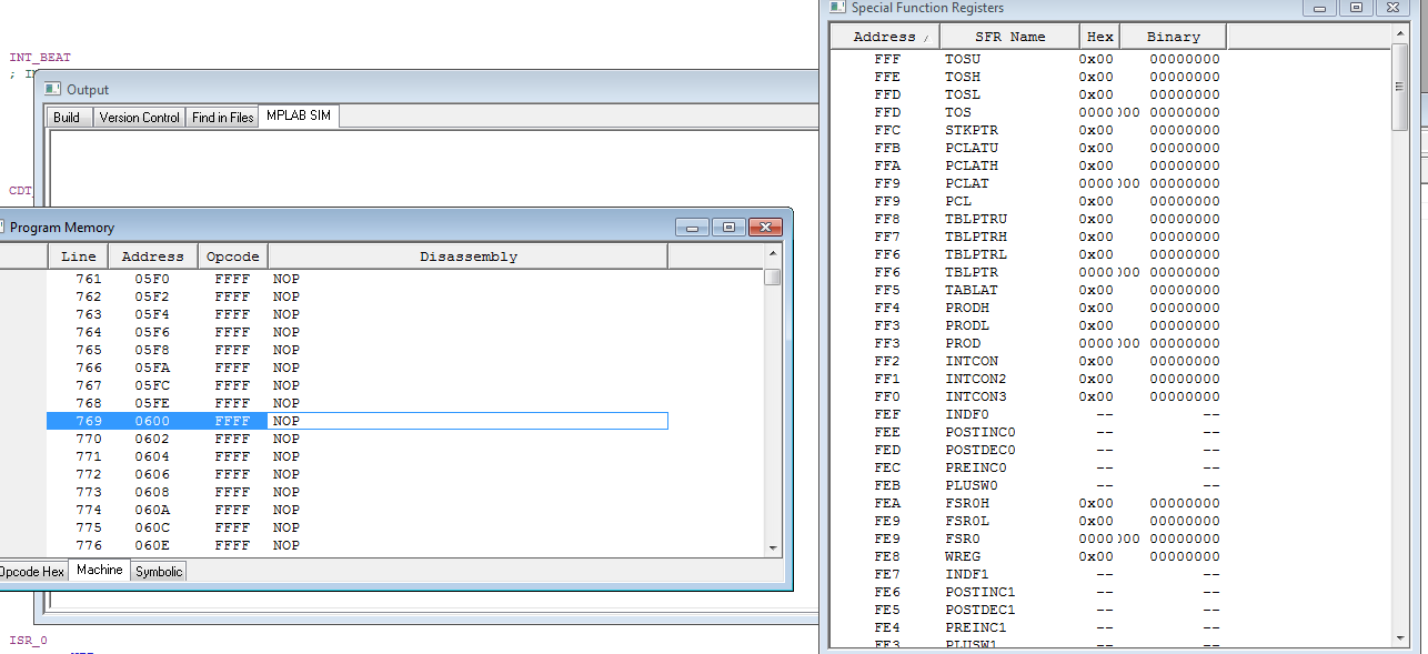

Thank you SO much, you have been exceptionally clear, and i 100% understand what you are saying to me, however what i am asking is (and i am aware even while typing this that it is a probably terribly trivial question, and i do ask with much trepidation) your vectors with custom assigned labels i.e. "tens", "huns", where were you able to understand/find the address of the vacant location of which to store these variables because the SFR window shows addresses of registers used for program functions intrinsic to the pic but if i wanted to reference a vacant location in a general register, where would i find the address of that such a location
the screenshot of the data sheet shows GPR from address 060h, would that refer to
this 600 i have highlighted in program memory, and then to address 3 adjacent registers for instance it would be the addresses on lines 769-771?
and if thats the case how would i then assign my own labels to these registers and add them to the watch window
since watch window only allows me to "add SFR" in the top left, and these addresses are not included in SFR rather program memory.
thanks
When the pic starts all the RAM is empty.
One of the first lines of your code is the Include statement - see code below.
This is the complete list of the Pics own system registers that it loads into those dedicated RAM locations, typically the high bytes on the 18F chips.
Everything else below them is still empty.
To run your program your need work files / user registers.
You can address the RAM directly by is location like movwf 0x101 and movwf 0x504, very confusing .
So you assign a label / name in Assembly to the RAM locations, the Assembler then converts your labels into the direct addresses to go into your completed code.
Like the system registers, you have to load in your Users registers, this is done by a couple of methods, but I prefer the Cblock directives, again see the code example.
Its up to you to enter these labels and keep track of them.
In the disassembly listing what you are seeing is the Program Memory, the actual program code instructions, this a memory area called PROM and is totally separate from the RAM data memory ( and also EEprom)

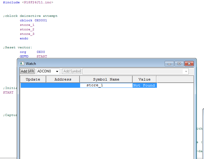

Im sure im now using the cblock directive correctly because im able to compile with no runtime or debugging errors so the syntax is seems correct, my only concern now is that i am unable to see the contents of the addresses i have just specified in the watch window, as you showed me earlier. when i type the name into symbol name it gives value "Not found".
In the assembly window it has the newly defined address label names the same colour as the labels i use when combining, is that to be expected.

Your user registers should show up in that blank dropdown box next to the 'add symbol' icon; you do not need to type in the name.
It did work for me last night and does work on my other projects but it will not do it on that example I gave, even after adding in some Config paramenters.
You can see your User registers as direct addresses by viewing the 'File Registers' and either single step or Animate though your code.
You could try creating another new Project and see if that allows the Watch window to work.
Think either there is some parameter we have missed or its a quirk of Mplab, of which their are a few.
Hopefully some other member might come in with the answer...
Hi, i think i have found the answer, just thought id share it as it may be beneficial to you in the future also,
https://www.microchip.com/forums/tm.aspx?m=147648
from project>build options> project>MPASMC17/C18 Suite i was able to verify that i was using relocatable code as oppose to absolute. Im going to rebuild the program and that should rectify the issue.
