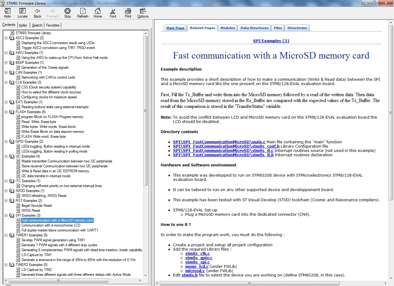

There are a ton heh... there is more down the list. with lots of info in there:
