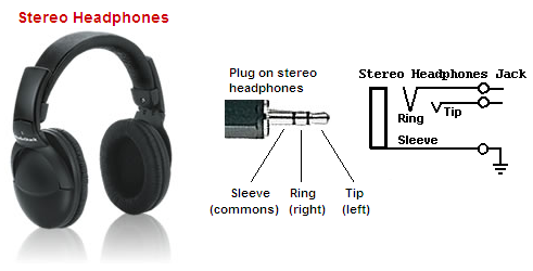

The right channel goes to tip, the left to ring, and the common side of both channels to the sleeve. You will be soldering a total of four wires to three contacts. Can you tell which contact on the plug is tip, and ring? Sleeve should be obvious.
Usually, a two-conductor cable goes to each speaker. There is usually a tracer on one of the speaker wires to identify the polarity of each speaker. The conductors with the tracer usually go to the sleeve.
Computer speakers usually have a built-in amplifier. So the input cable has a left wire, a right wire and a shield wire which is the common ground.
The connection for the TIP runs down the center of the plug.
A photo of the plug and jack might help identify which terminal is which:

Considering that one of you said the tip is the right channel and the diagram included by the other of you shows the tip as the left channel, I'm concluding that it's a toss up and it probably won't really matter which of the colored wires I solder to which contact.

On your computer you have an audio mixer. Adjust it to only play the right channel (balance). Play a longish mp3. Connect the sleeve to the plug and try the other two wires one at a time to the other two connectors on the plug. Just use your fingers. You will work out which connector on the plug is "right" and which speaker is "right". Right?
I have disassembled and repaired dozens of cables. You will also see this on the RCA connectors on the back of your stereo, VCR, TV, etc. I have found no exceptions.
Red == Right == Ring.
If you find an exception, then move the speakers.
