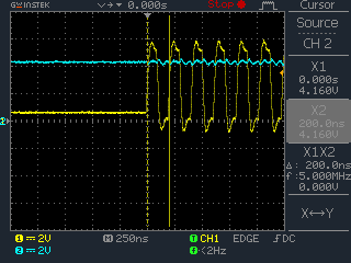

I have tried making a small circuit using the LTC3122 and the application example on page 19 in the datasheet (http://cds.linear.com/docs/en/datasheet/3122fa.pdf), however, with a slightly larger coil. The circuit is supposed to source 833 mA @ 6V, but 70 mA is the max current I can draw from the circuit with a small servo motor or a resistive load. The voltage input is a couple of AA batteries.
How is the current limit controlled by the circuit, and why is the current draw so low before affecting the voltage?

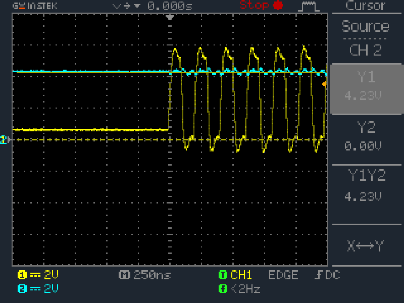

I have scoped the VIN pin in different configurations:
No load
50 Ω load (4.23V and 5MHz)

What duty cycle are you mentioning? No outputs seem to output any logic switch signal with a duty cycle. It will have to be expressed from the inductor voltage then.
The duty cycle is the duty cycle of the output transistor when it is working at least somewhat normal.
But yikes, is that really the input pin going from some max to zero? That's nasty and surely something is wrong with the feed or the load, or the inductor still doesnt work right.
But it's hard to tell what we are looking at here. Is this the current or voltage?
Also, if the pics where about 2 times larger (wider and higher so 4 times the area) i could see them better. Those small pics are hard to view.
If you use gif files they dont take much space (low byte count) so you can make them a little larger.
Be as detailed as you can with the pics. Tell us exactly what we are looking at. This will help speed the process.

MrAl : Here are the scopes in a larger and readable size (resolution is scope limited)
No load configuration
Yellow: Converter switch pin voltage (SW pin 1), a max of ≈7 V
Blue: Converter output voltage (VOUT pin 11), 5.76 V
It shows a strange repeating pattern of around 1 MHz
50Ω load configuration
Yellow: Converter switch pin voltage (SW pin 1), a max of 6 V
Blue: Converter output voltage (VOUT pin 11), 4.23 V
The oscillation is more stable with a frequency of around 5 MHz (even though it shouldn't be that high, IC has a max of 3 MHz)
