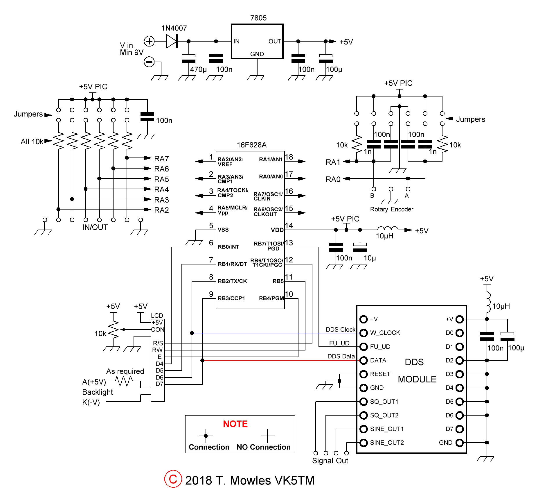

Well, I have isolated the weirdness to the encoder polling section, why, when it has absolutely nothing to do with the display routines, is beyond me at the moment.
Still works fine on a 16x2 but throws a hissy fit when the 20x4 is plugged in.

Just so we are all on the same page, I am in the process of getting the basics to work first - LCD display and loading the right data to the SAA1057 and am using my DDS test bed to do the initial testing/development of the software - so in the schematic below - where it shows the DDS module the FU_UD line - RB7 - is DLEN (enable) for the SAA1057 and clock and data going to the DDS are clock and data on the SAA1057, but note that while trying to sort this problem, the SAA1057 is not connected (and it doesn't make any difference connected or not, to the problem).
The encoder is on RA0 & 1 with 10k pull-ups and 100n caps to ground.

I am using my DDS test bed for prototyping - the DDS module is removed and the clock, data and enable lines are connected to the SAA1057.
And the SAA1057 is an old PLL chip once commonly used in FM transmitters - this project is the control and monitoring part for a FM transmitter.
