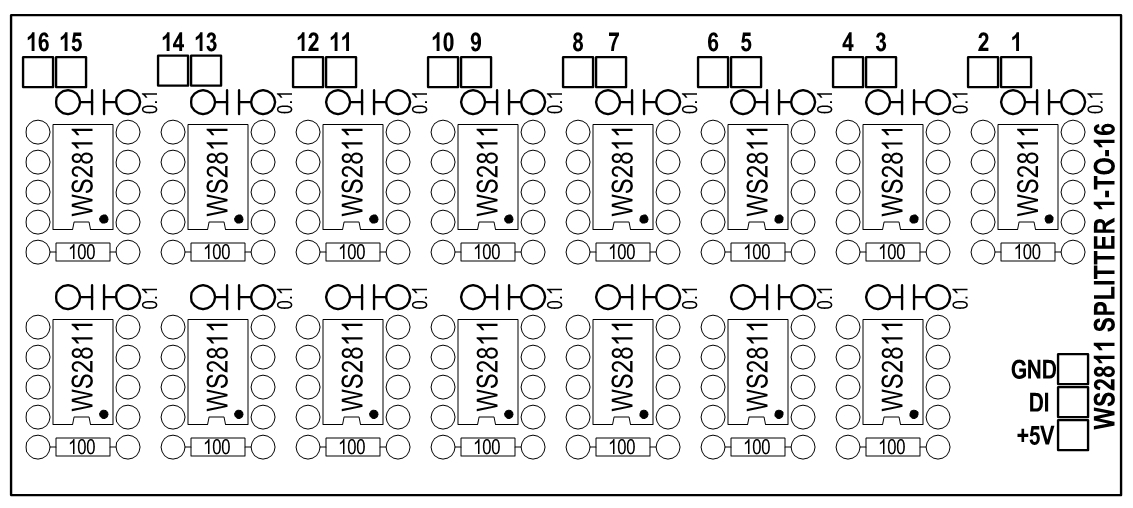

I am still going to work on the op-amp solution but meanwhile I came up with a simple solution using WS2811 itself to split 2, 2, 2.
Signal arrives at the first WS, splits into 2 WS, then splits into 4 WS, then finally splits into 8 WS which provides 16 outputs. I used 15 WS2811 chips with supporting o.1uf caps, and 100 ohm resistors. This allows one data in and 16 parallel output.
PCB footprint: 1.6" x 3.7", with estimated cost of parts at $6.90 plus $2 for pcb for total of $8.90 for a professional board!

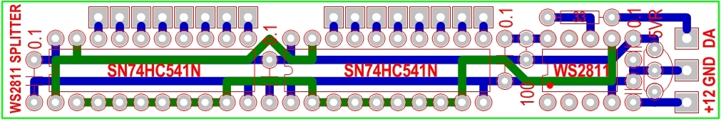

Here is the board layout for this device. It consists of a WS2811 to condition the input signal, and two Octal Buffers to create isolation and to split the signal to 16 channels. The board is designed for 12V power supply system with an on-board voltage regulator to convert it to 5V to comform to TTL output. This device can be connected to 16 strings of smart pixels. For example: a large tree with 16 branches expanding radially outward 15 feet in all directions. Happy lighting!
1. You need a decoupling cap near pin 20 of the left 241.
2. You need a decoupling cap on the 2811 pin 8.
2. If you change to a 541, all of the inputs are on one side and all of the outputs are on the other side. This makes it *much* easier to add output connectors rather than direct-wire to the board.
ak

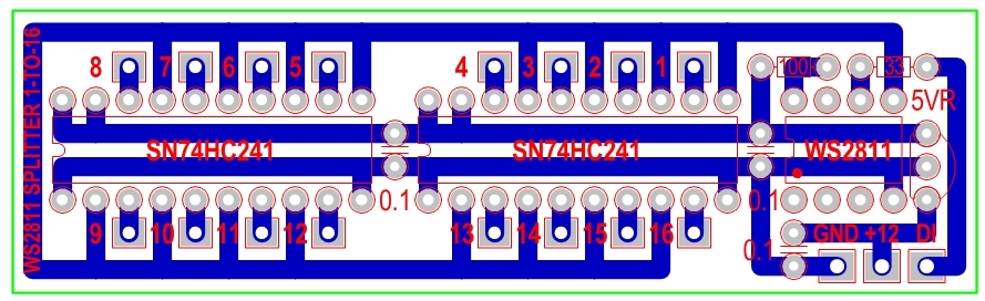

The capacitors are there, they just needed to be rearranged. Here you go.

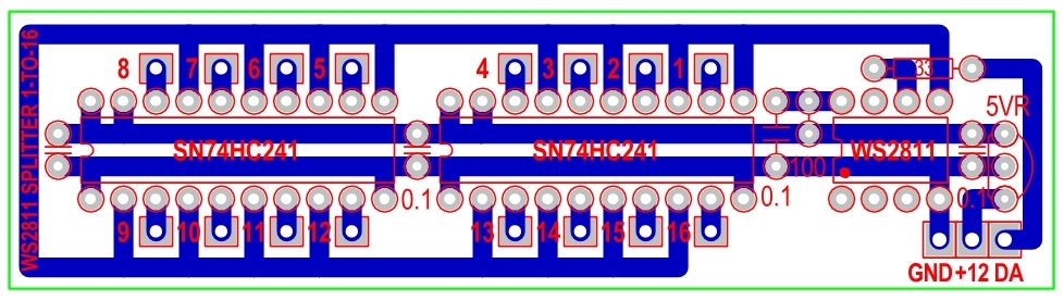

Here is another version with all outputs on my side with double sided copper.
