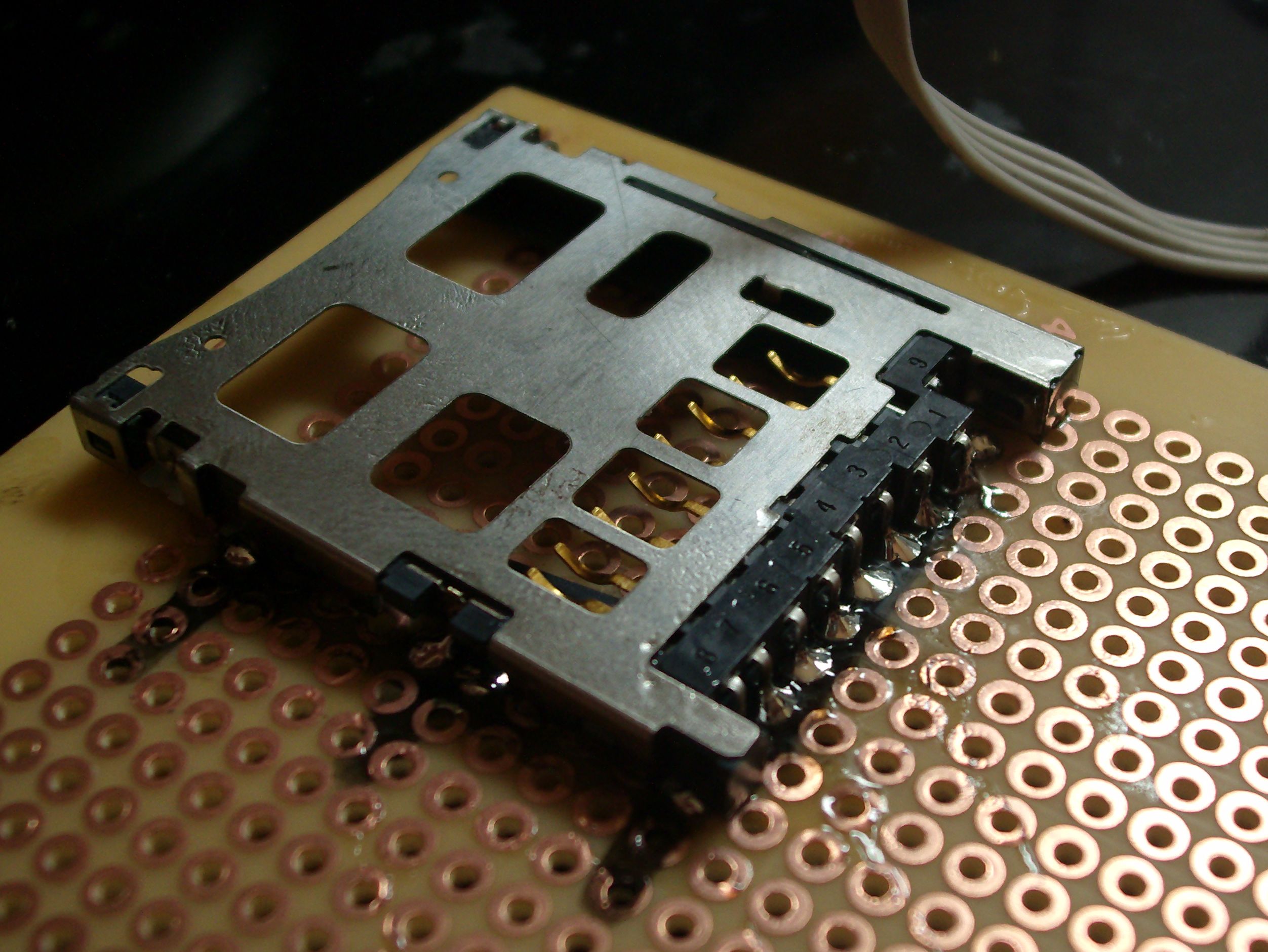

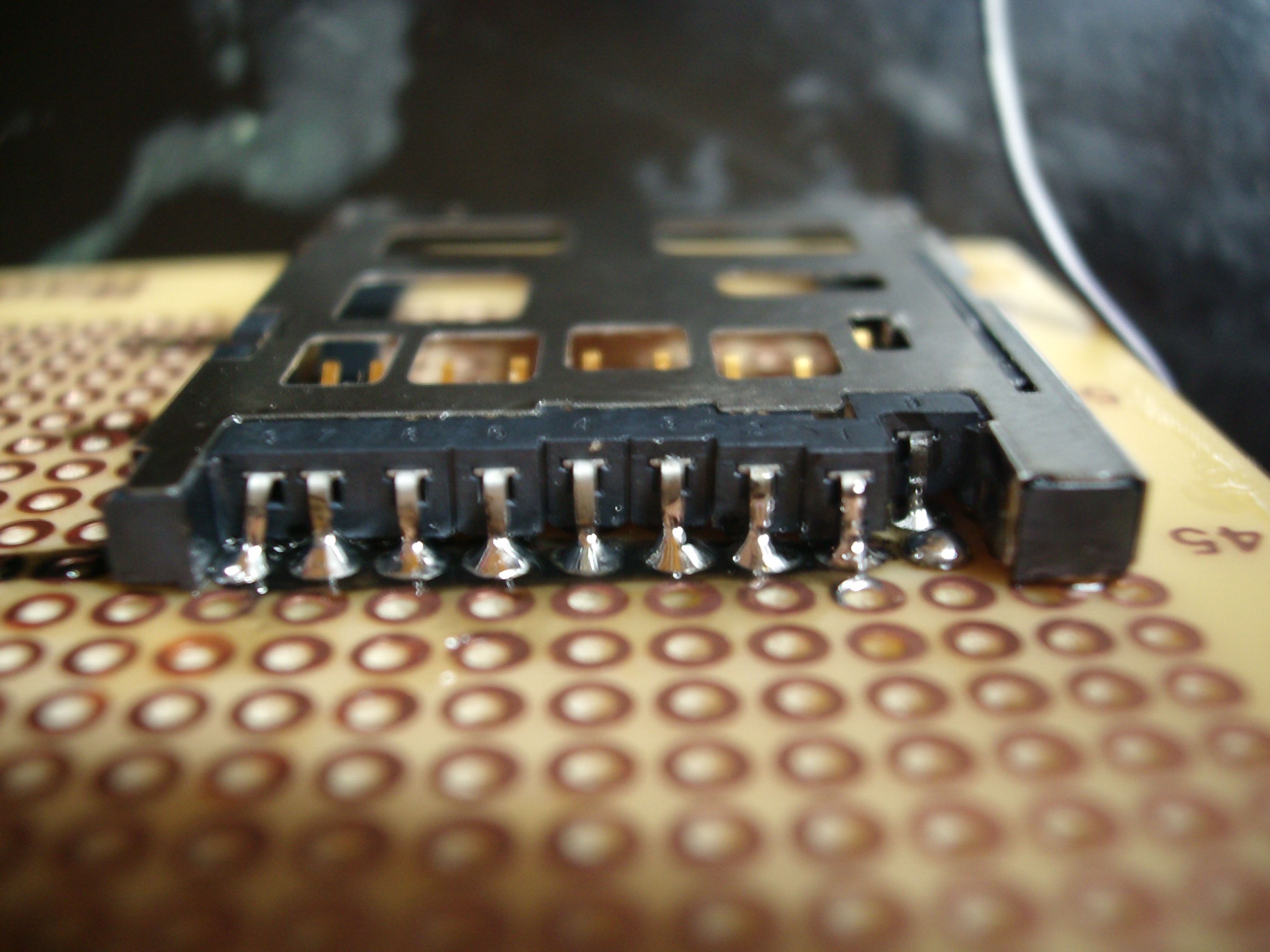

Here is a picture of my sd card it was a smd part but i bent the pins and they fit a .1" spacing :D:

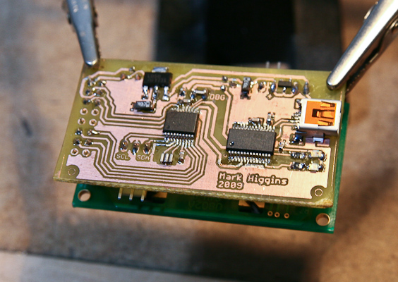

I posted both these in other threads, but these projects use the FT232RL. I wrote a Vis BASIC program a long time ago to control the fan controller, and I played around with a C# program to do basic read and write to the LCD controller, but Windows programming isn't my thing and I'm not very good at it. pics attached.
