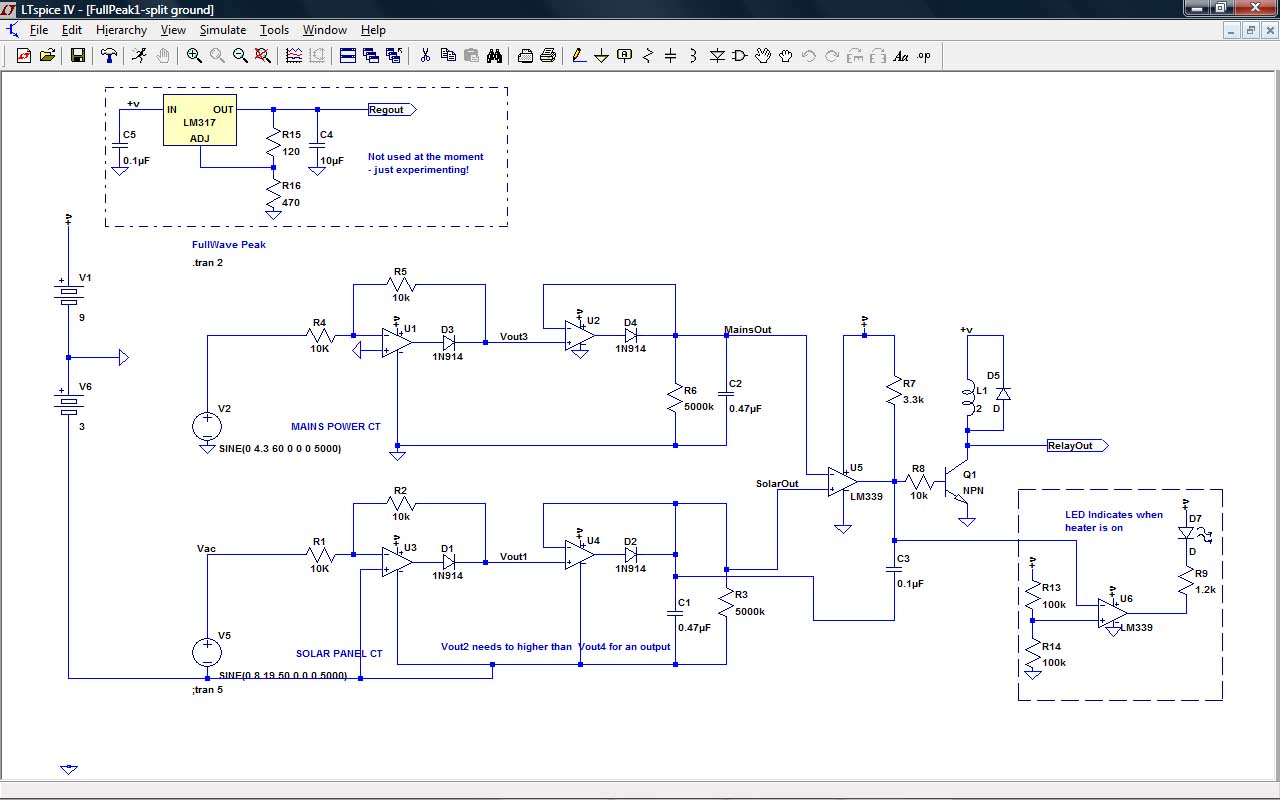

In another post, I have been trying to apply a voltage bias to one of two inputs fed into active bridge rectifiers, and into a comparator and have thought of a solution.
If I had a split power supply (as per screenshot), I could feed the first circuit using the 6v supply and the other via the 8v supply, which would give me the necessary bias.
I have created a sim and it works fine.
However, I havn't a clue how to build the split supply.
I have a DC 9v supply, which I wish to split as 0v - 2v - 8v (the 2v will be used as a ground for part A circuit, whilst true ground will serve as ground for Part B.
I tried resistors but it didnt work well and would prefer a regulated circuit.
Part A draws about 60mA whilst part B draws 10mA
Advice would be appreciated

Do you mean to use the stabilised output from the LM611 as the ground for circuit Part A and the 9v +ve supply as Part A's +ve?
Also, if the 9v is not regulated, and the output from the LM611 is, then wouldnt the 2v differential would vary under load?
If the 9V source is not stabilized you won't need a stabilized reference voltage.
I'll be able to tell you more if you post a schematic of your project.
Ok, here it is. As you will see the ground on U3 and U4 is higher than that of U1 and U2, which enables me to maintain a bias voltage at 'Solar Out'.
The 2 inputs (V2 & V5) are Current Transformers, and the circuit is designed to switch on a water heater IF solar generated power exceeds what is being consumed.
  • FullPeak1-split ground.asc

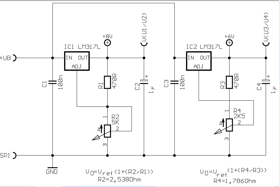

Hi Rosso,
this would be my approach.
Use common ground and two different supply voltages.
That's a cheap and reliable method.
Boncuk
