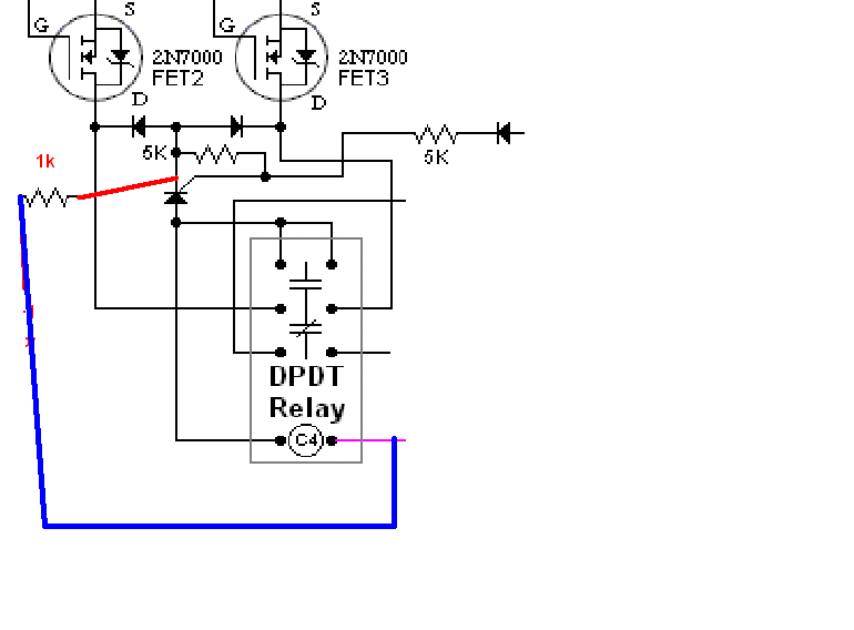

Yes sir, one side controls C2 and the other C3 and when the over current Opamp fires at end of travel, SCR fires, C4 activate and It drops out C2 or C3, (Both) and the power that was going to C2 or C3 now goes to C4 until the Strain gauge is relaxed, then Fets 2 &3 shut down and SCR is supposed to Shut down.

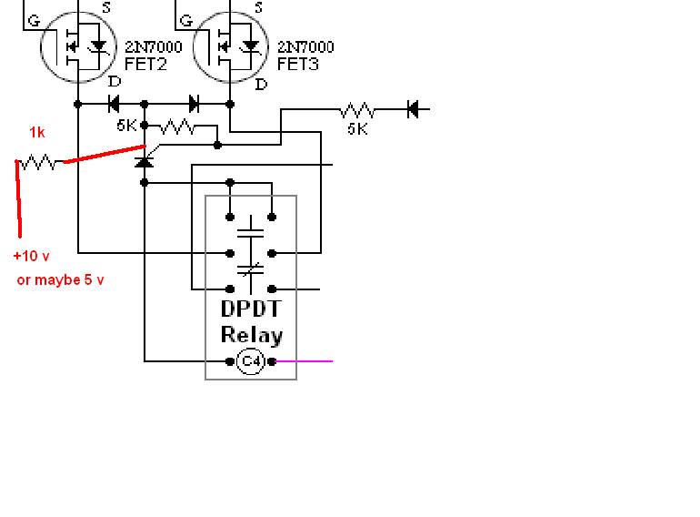

Ok, it may be simply leakage then, assuming the scheme works as is anyway.
Did you try a resistor, like 1k from the cathode of the SCR to +12v (+Battery) ?
Not yet, take a look at this drawing, I have 10 v regulated and 5 volt reference and yes everything is work quite well except for the SCR shutting down.

Here is the correct connection...
(goes to other side of coil C4)
Oh hey you dont have any inductive kickback diodes installed?
Where? on the coils?
Yes. They have quite a high voltage kickback when they turn off
unless there is some way to prevent that.

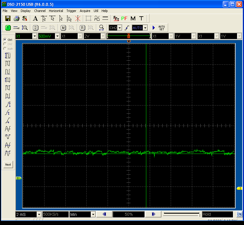

Got things straightened out, I think there may have been an invisible solder bridge firing the SCR, it now turns off with FETs 2 & 3, however, it turns right back on when relays close, too many spikes in the system.

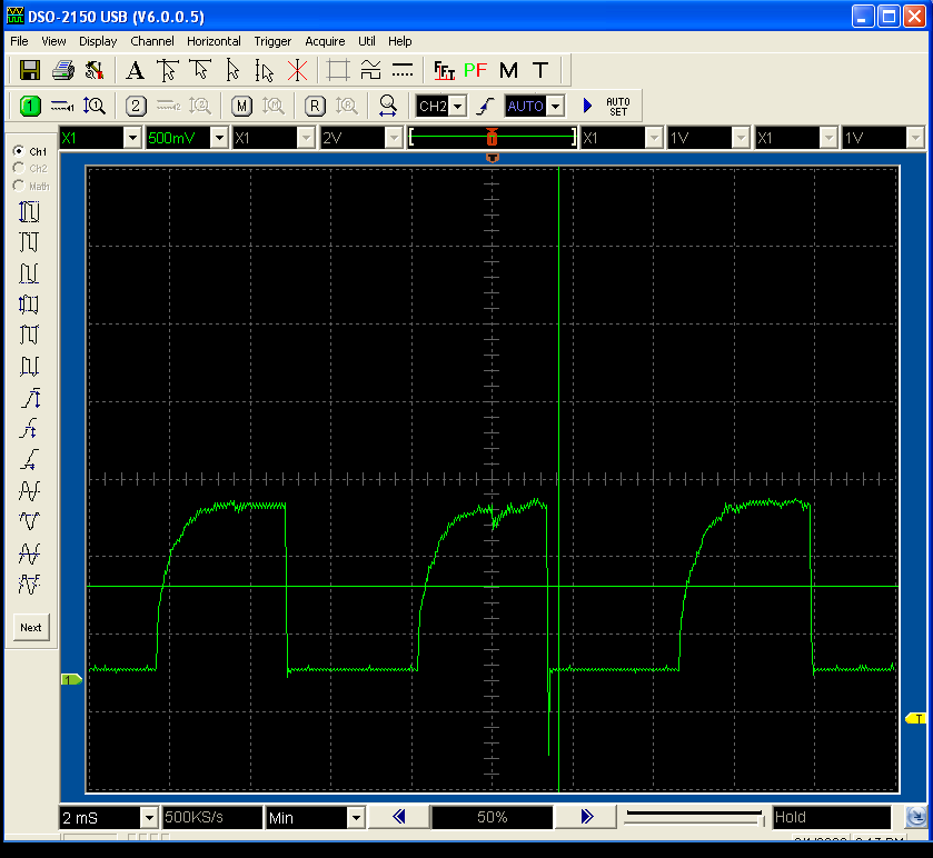

I was watching the current on a .1 ohm resistor and when a motor is driven by a square wave, the amperage during the on time is higher than when the power is 100%.
Any way, this has been a very educational project, but I don't think it will work for my purposes.
