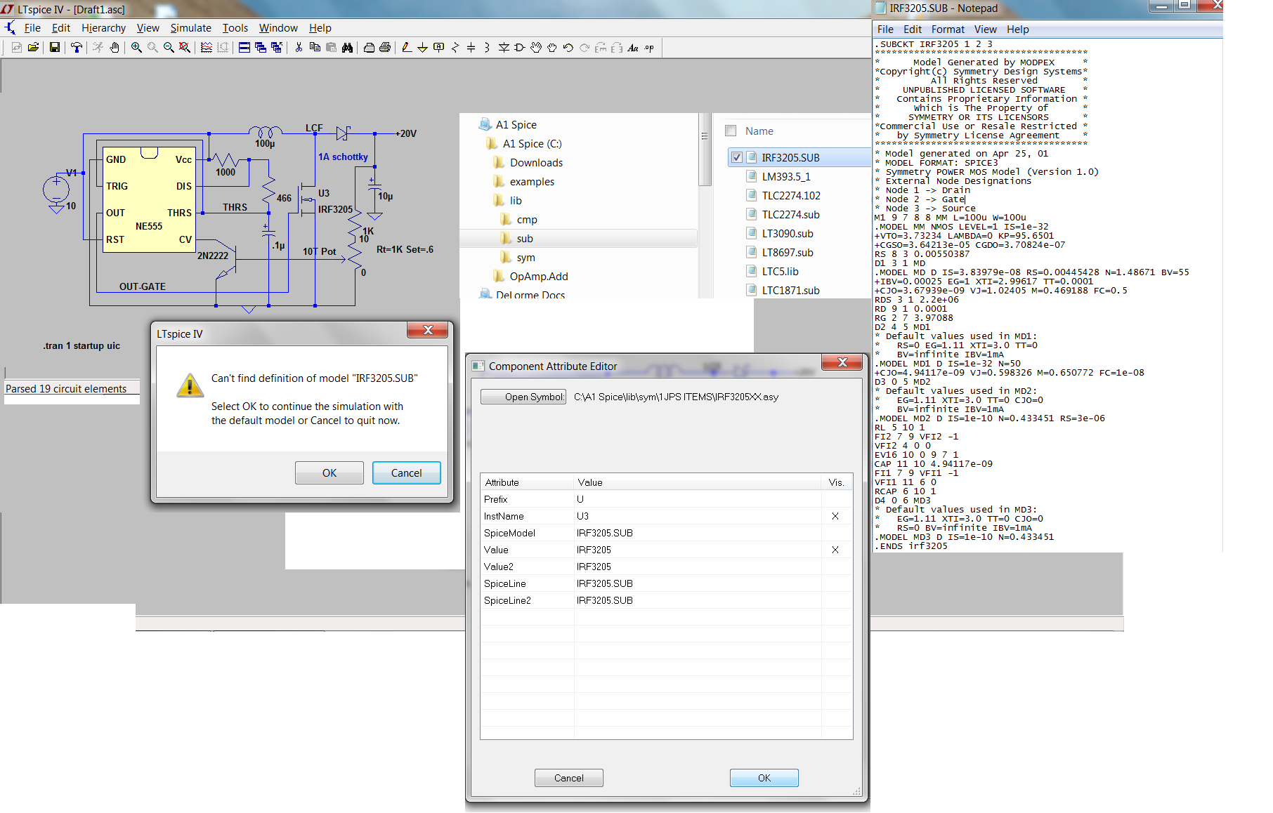

I like to build my own .asy and import .sub's from places like http://www.irf.com/product-info/models/SPICE/irf3205s.spi. I did this and tried to run it but I keep getting the can't find definition of error. I made a composite .png of all the pertinent screens. Can anyone suggest why it fails or what I'm doing wrong.

hi K,
Have you tried .include IRF3205.sub on your schematic.?
E
yes, also tried including the text of the sub in the ascc.

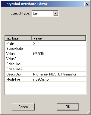

The attribute values are not correct.
1. When editing the symbol, use the Symbol Attribute editor. The values shown below are all you need.

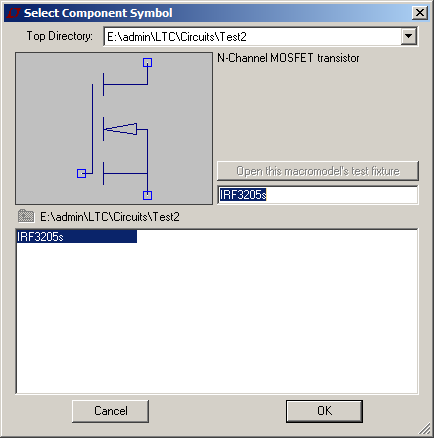

2. To test the symbol, copy the .asy and .spi files to a folder, then copy the schematic to the same folder so they are all in the same folder.
Open the schematic and select the symbol from the component menu. See below. Run sim and test for error.

I finally got it, read the help, changed the prefix to x, saved the .asy but it was still messing up, then I saved the .asc and it worked. Now it works on all my designs. On occasion, when I can't get spice to fly right, I close the program and then reopen it and it will work, guess that makes me do the save which is probably what gets it working.
