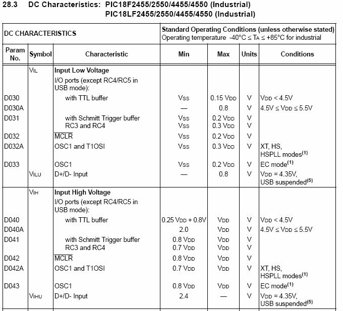

Well you will need a level shifter when using the SPI in hardware for the SDI pin. 3.3V is just not high enough for the Schmitt inputs on a 5V PIC. I'd have to check the datasheet but I recall it's something like VCC-0.8 (4.2V) is a 1.
Hi Bill,
I have had a look at the data sheet but the page doesnt make a lot of sense.
What does it mean?
Mark
To better explain that page. It basically shows you the voltage at any given pin (left side aka characteristics) .
So you look for the pin in question in this case I/O PORTS (Except RC4/RC5 in USB MODE)
Then you figure out if its a SCHMITT PIN or TTL or is it RC3 and RC4
If its a SCHMITT pin then the LOW = VSS to .2 from VDD (1v)
The SCHMITT pin HIGH = .8(4v) from VDD to VDD itself (if a pic with 5v source then 5v)
As bill said below:
.8v * 5v = 4v (HIGH)
.2v * 5v = 1v (LOW)
