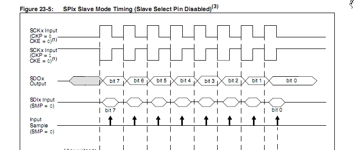

I've got tangled up with SPI in Oshonsoft again!
I recall that when writing to SPI 0X80 must be added, in other words the first bit of the address must have a 10000000.
I need to READ from on address and WRITE the RESULT to another.
e,g READ ADDR 0x01 and WRITE the RESULT to ADDR 0x02

hi C,
You have answered your own query.
A Write Command on SPI has Bit7 SET to '1' and Read Command has Bit7 set to '0'.
Is that what you mean.?
Eric

Good morrow, Eric,
It's a bit more complicated than that, I was getting what I call W_ADDR (WRITE to SPI) mixed up with what I am trying to WRITE to that address. (I hope that's clear?)
I think I may have figured it out, and I'll let you know post haste :)
C.

Hi J,
You would think so, but in this case there is a WNR BIT to add. So 00000000 now = 10000000. From the SX1278 DATA sheet. So I named the addresses for SPI as W_ADDR and I was getting mixed up with WRITE. I'm even getting mixed up explaining it ;)
I think I've got past this problem now (Time will tell!)
