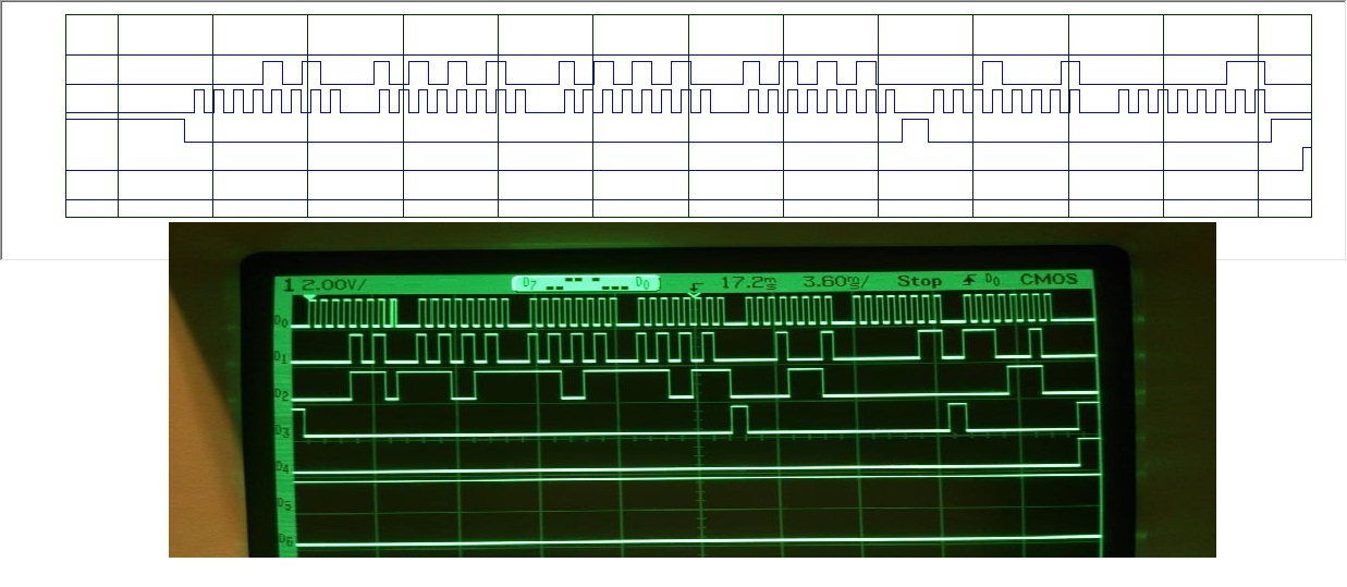

Basically, I have written an SPI routine (never done this before) in assembly for a PIC16f688 and I am fairly happy with it. You enter data in to 4 registers initially, two that contain where to raise CSN, (which are rotated end of each group of clock cycles) then the number of writes in another register, number of reads in a further register, then it's a case of just entering up to 15 addresses / data's and the code does the rest to produce SPI (at the moment, phase and pol are 0-0). MOSI is rotated out of registers 0x6X and in to the end. Thus it is kind of FIFO.
SO I think I have got that bit right. I have got everything moving slowly, as I am based on breadboard for now.
Good News, I do I get a MISO response from the RF unit. Bad news, I can't really seem to make much sense of it or control the modules! I am obviously overlooking something.
I will try to get a trace at work tomorrow, but for now below is an MPLAB sim of the data sent out without obvious MISO, which, like I said above, I do get.
I have skipped the majority of config in this example as I thought I would show how I am setting a receive address in Data Pipe 0. I am sending [CSN LOW] 0x0A followed by 0xAA 0xAA 0xAA [CSN HIGH]. clock is approximately 500uS each cycle, 1mS rest between each byte of data, CSN highs are 760uS. At the end of transmitting this I then set to expect 3 bytes in RX_PW_P0 with [CSN LOW] 0x11 0x03 [CSN HIGH]. You can see the CE pin going high at the far end too.
The MISO data I am getting back I am struggling to understand, and I have tried transmitting (I put it off as long as I could!) to no avail.
Please can someone put me out my misery and shine some light on where I might be going wrong!!!?
Thanks.
*Managed to get old scope behaving (nearly) so you can see the output! MISO is showing 0x0E although in this case I have not set any config registers other than you can see. Will address that tomorrow as I am tired!

It would help if you labelled the simulation and the traces.
There could be something different happening at the last clock bit of the first byte. If the clock isn't changing cleanly it may be seen as more than one pulse.
What are you trying to send to the nRF24L01+ ? . The commands are on page 51 of this:-
https://www.nordicsemi.com/eng/cont.../file/nRF24L01P_Product_Specification_1_0.pdf
I think that you should be sending 0x2A in the first byte, so in binary 00101010. Commands that start 001 are to write to an address, while commands that start 000 are to read the address. You sending 0x0A, so in binary 00001010, so that reads register 0x0A, and the answer from the nRF24L01+ appears to be 0xE7E7E7, which is the first three bytes of the default for register 0x0A, as it says at the bottom of page 59 of that data sheet. Only 3 bytes were sent by the nRF24L01+ as CSN was taken high after that.
Also, I suggest you avoid receive addresses like 0xAA AA AA. It is really easy to get you or the data receiver confused as to where the bytes start and finish in a data string that is only alternating 1s and 0s. I would used something like 0x90 A5 0F (binary 1001 0000 1010 0101 0000 1111) just to break things up a bit.
Thank you Mike, I had completely overlooked that bit! I will make the change, write, then read in the same manner, and change the values to something a little less ambiguous. The AA string was only ever for test purposes to be honest, will have individual commands in finished idea!
Regards the glitch, the scope is old, it was far worse before but I tried one last time. I will use our works one soon.
Quick question then, I assume this 0x2# applies equally before writing to Config too! - How stupid I feel, not sure I'd have figured this out!

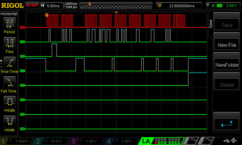

ok folks, I have made some changes, attempting to program it into constant carrier mode (test) spoke nicely to someone at work with a spectrum analyser. Not seeing anyting on the output centered around 2.4Ghz with 150Mhz either side. Zilch.
THis is what I have entered, in the order of the instructions..
Config
0x20
0x52 =PWR_UP, PrimRX=0
2mS CSN high
RF REG:
0x26
0xB6 = 256kb CONT WAVE PLL LOCK PWR 00db
RF CH
0x25
0x06
Then I have set the CE pin high
I also send 0x06 and 0x05 at the end hoping to read the contents I have just entered but getting nothing back....

Can I suggest you write a routine that writes 1 byte and reads one byte at the same time. Use the timing diagram on page 52 of the data sheet.
Then, when you need to write to registers, set CSN low, call the routine with the command and data bytes and then set CSN high again.
Start with a command like flush_tx that doesn't have any data and see if you get the status register returned.
I cannot follow your code above which is why I'm suggesting this.

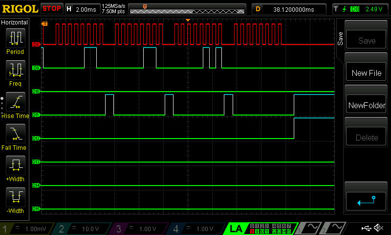

Thanks Mike, I had to walk away for a bit as it was doing my head in! Turns out there were some little niggles that needed ironing out. I am now talking to the module, getting expected response, and have even seen the output of a module on a spectrum analyser at work so things are looking positive.
As an experiment, I set up data pipe0 with 3 bytes of data, requested a check of FIFO status (x17), enabled CE for 10mS then checked status again and first time round Fifo status showed 0x01, after CE on for 10mS I get 0x11. This is great news, as it shows it has offloaded data. I just can't seem to receive anything arghhh!
Keeping things really simple, following the procedures outlined for communicating with the older non + (I am commanding many modules at once so cannot use ACK etc.) so all bits in EN_AA of 0, retrans all 0, no CRC and all data in and out of a 3-byte address assigned to pipe 0. Such a shame there is no LED that shows operation directly from the chip!
I know this has to be down to something stupidly simple now!?
BTW I do know my SPI code is bang on now, really happy with it! Might be a bit spaghetti junction but it does the job with minimal setup each time.
