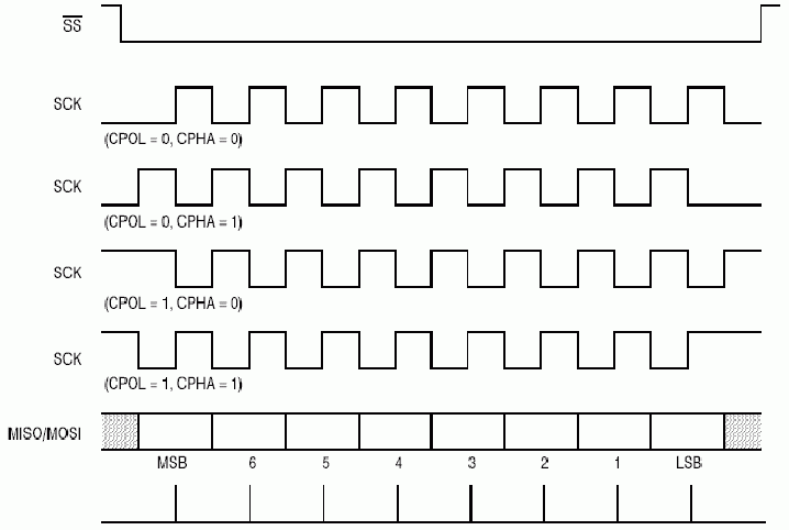

Hi Eric,
Thanks for the PDF, but I found it difficult to read as it uses different sets of words for SPI. I have attached one I find easier.
See #2, I tried and failed with Define SPICLOCK_STRETCH.

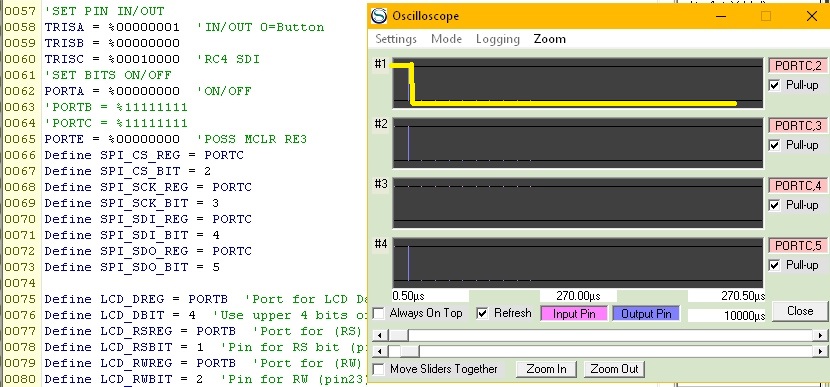

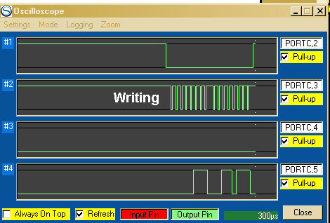

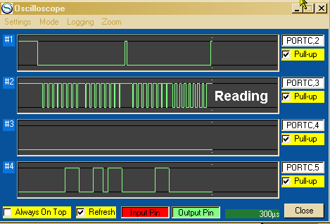

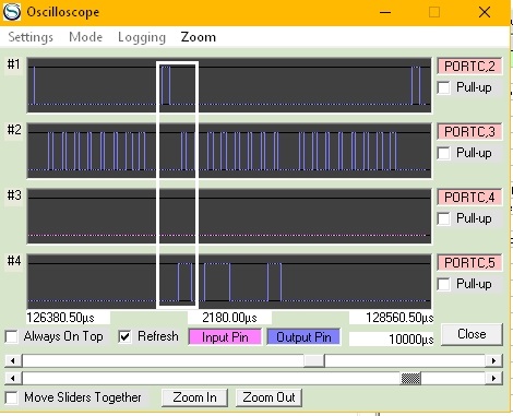

I have attached images from Oshonsoft showing SPI Prepare-SPICSon-SPICSoff. Note the first write address is 0x31 Or 0x80, and 10110001, then 0x00 so 00000000.
I don't find that the rising falling signals aren't lining up for easy checking.
I'm now going to try SPICLOCK_INVERT.

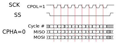

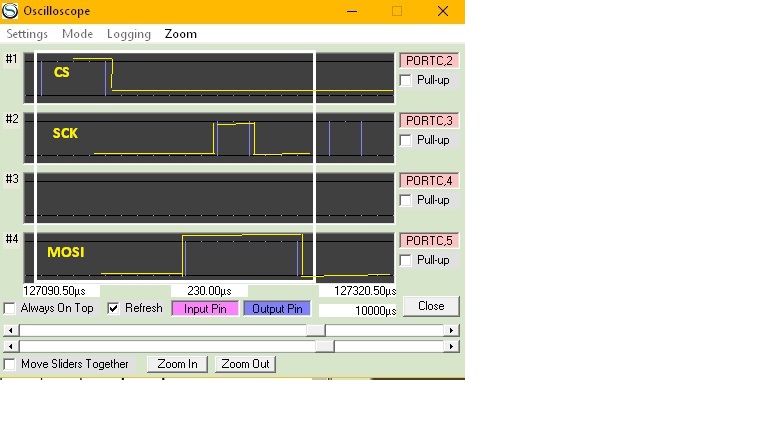

hi C,
The SX expects CPOL=1 and CPHA=0, the Scope Plot is showing CPOL =0 [ Idle LOW going High].??
E

Hi Eric,
CPHA is not clear to me.
I see that CPOL (SCK) = 0 (Do they use all these different acronyms, to confuse people like me:confused:)
As mentioned, I've tried Define SPICLOCK_STRETCH up to 20, with no affect.
Also I've now tried SPICLOCK_INVERT also with no change. e,g, the signal runs low till a write, then goes high then low. It may have shifted a little?
hi C,
CPHAse=1 means that the Data Bit being transferred is clocked into the buffers when the Clock pulse goes High.
CPHAse=0, means that the Data Bit being transferred is clocked into the buffers when the Clock pulse goes Low.
E
Your SX states: synchronous full_duplex protocol corresponding to
CPOL=1 and CPHA=0

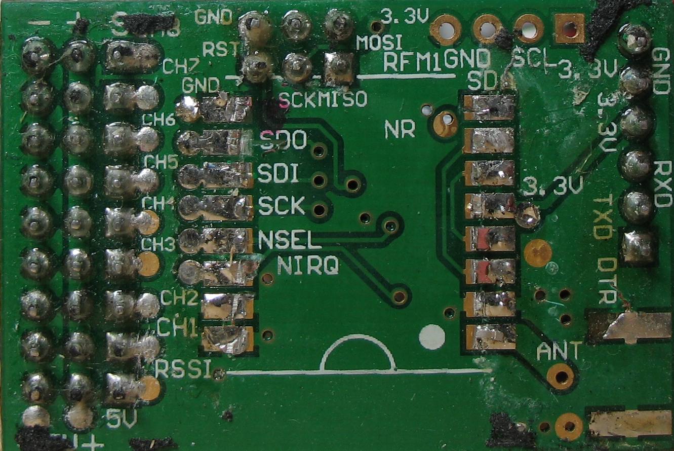

Hi Eric,
Assuming that I have made the second circuit correctly?!?! and looking at an Orange module with similar chip-module see attached, where the radio is on the other side of the board to the controller, I'll work on the idea of wire length and make another circuit.

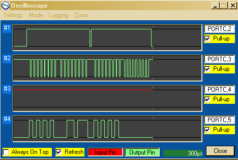

I've tried both Define SPICLOCK_INVERT = 0 and 1 Also Define SPICS_INVERT = 0 and 1
Each time the same, see image. The signals drop at Line 61.
What's going on:banghead:

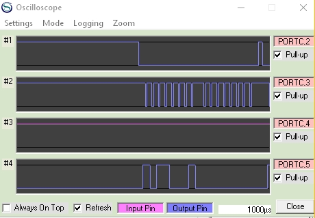

Hi Eric,
I'm not particularly trying to invert CS, just trying everything programable, that may get Circuit 2 working.
I was adding the invert lines at the top of the program (OOps) once moved to where you suggest, it now inverts. See image.
I've now tried the speed and invert, and all work in one circuit and not the other, so it must be something else.

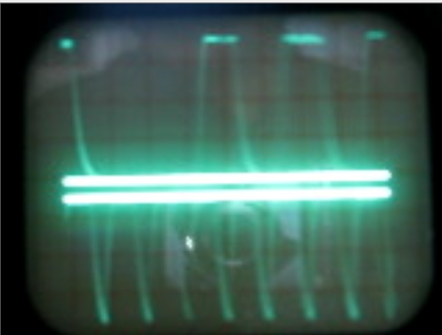

I've attached a screen shot from my oscilloscope showing SCK and MOSI, and it shows pretty poor square waves, connected to circuit 1.
Circuit 2 doesn't appear to have the SCK working. I'll investigate!!
Thanks, C.

Ref the OSC scope image, are you using a decent scope probe.?
What make of scope is it.?
E
E
Hi Eric.
There's no name on my probes, and they don't look expensive.
The Scope is a Hameg HM512 with dodgy switches. I would prefer a £1000 upgrade:)
