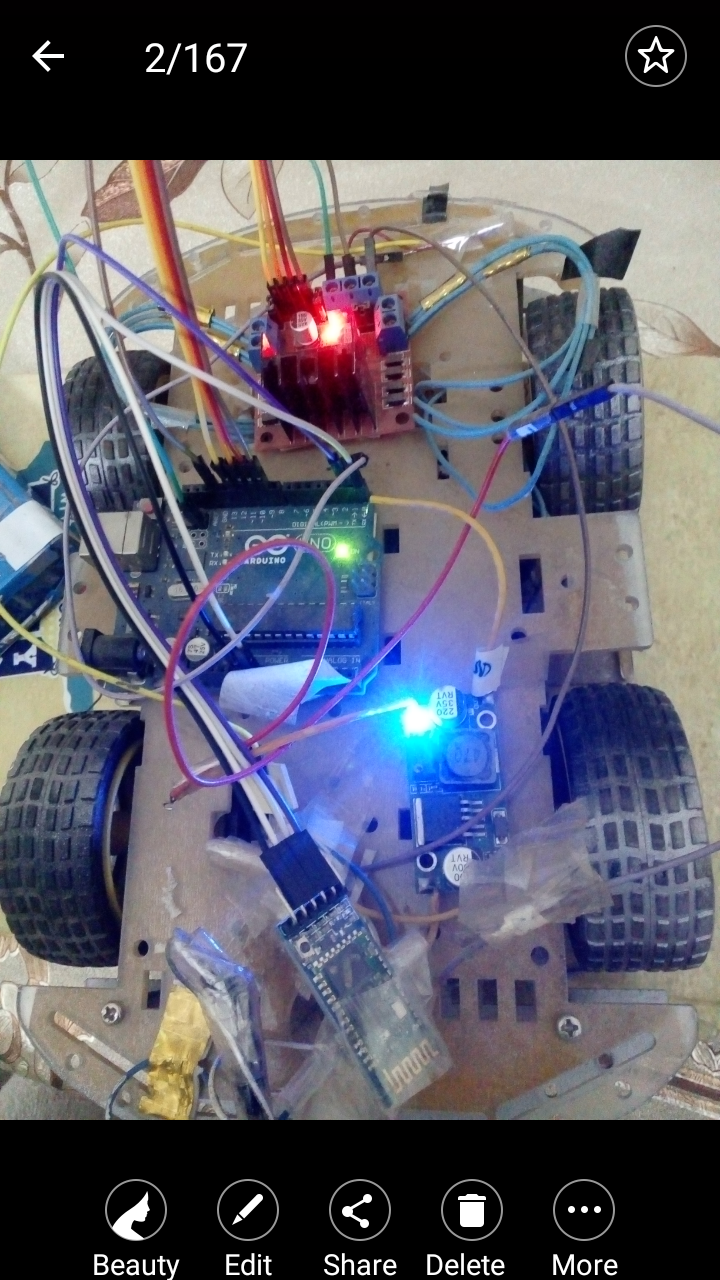

See I am using H bridge, Arduino Uno and a Bluetooth which will transfer the voice command from mobile to arduino and the motor driver(H bridge) will run motors..... according
ok. Tell us about the bluetooth part. Are you speaking into a phone and have a bluetooth speaker on the car?
Yes I speak on my phone in an app using the google API so that voice is transfered to Bluetooth module on car chasia

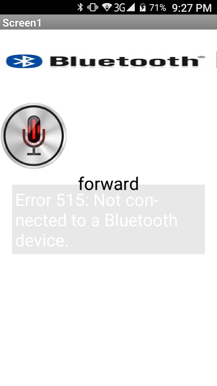

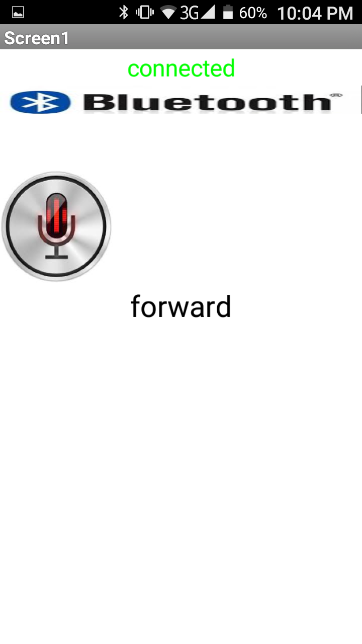

Its HC-05 Bluetooth module and it gets connected easily the wheels moves forward when I give "forward" command but I want the functions as mentions should move a few seconds then right for dew seconds then should stop...
I want to run this robot chassis car for a predefined time in particular directions.
