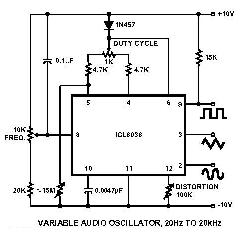

was wondering if anyone could point me in the direction of some sound generating cuircuits .... i would like to be able to produce tones like from musical keyboard .... triangle wave / sawtooth / sine / etc

Have you tried using a 555 timer, setup at a high frequency (eg 256Hz for middle c)?
Try it with old 8038...
