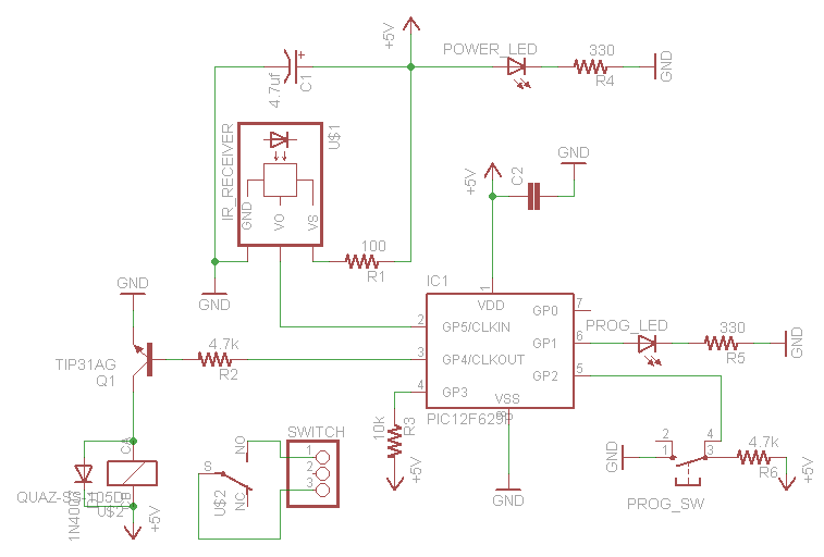

here is a schematic now:

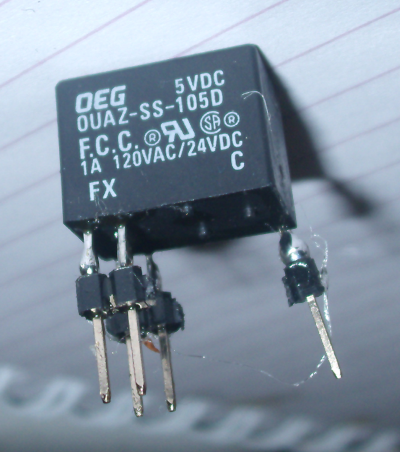

Hey guys im having a RELAY issue or at least i think it is a relay issue...
For some reason the light stays on even if its supposed to be off.
This is the relay im using:
relay-png.30343
This is my Ballast info:
ballast-png.30342
The relay is supposed to be 1A which should be fine since ballast calls .8amps aka 800mA...
is that too close? should i just use a higher relay? or do you think its the transistor switching it? ima use a multimeter now to test that.

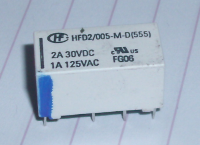

im using the below relay for now. Its 125v @ 1A. At least its holding well for now. Until i can order new relays.

so a 3A+ relay should be perfect right? I need to order one so i want to make sure i get it right :D
I don't know, but it stands more of a chance - you've probably seen light switches arc inside when you turn a flouescent light off? - that's due to the inductance of the choke.
Just like why you have to have a protection diode with a relay driver (I'm presuming you have that?), it's the back-EMF from the inductance.

3 amp would work fine When your light first comes on it will pull 1.5 amps till it lights the bulbs. there always a inrush of current with fluorescent light bulbs till they fire
