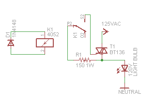

Would this work? Remember look at the labels i couldnt find the parts in EAGLE for a LIGHT BULB lol or 125V mains... so bare with me lol

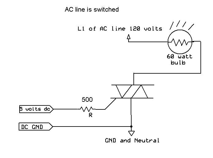

Just get a logic level TRIAC and it easy to flash a light bulb I posted on there how about eight weeks ago This is what I use
Fagor
TRIAC, Logic Level; TO-220AB; 8 A; 600 V; 8 A @ 95 degC; 1.6 V (Max.); 1.6 degC
Mfr's Part#: FT0816MH you can turn it on from the pick I use a transistor just because
I can't see hooking a pic to one chip that has 120 volts running in it This is ac bulbs bing flashed with a pic and triac

of resistor on the gate it takes 10 to a max of 20 ma to turn the triac full on I had a used
a 1k resistor on the gate which made it blink.
heh i dont trust bread boarding this kinda stuff. I have proteus on cd around here gota look through draws but will it simulate AC and stuff like this?
I might just use a RELAY and a TIP31A(G) for switching my light on and off. Im sure i can make the board nice and small to fit inside the switch box in the wall. Of course ill protect the back of board since its all metal.

That's why if you look in the video you see a transformer I lowered the Ac line down to what a bread board can take
