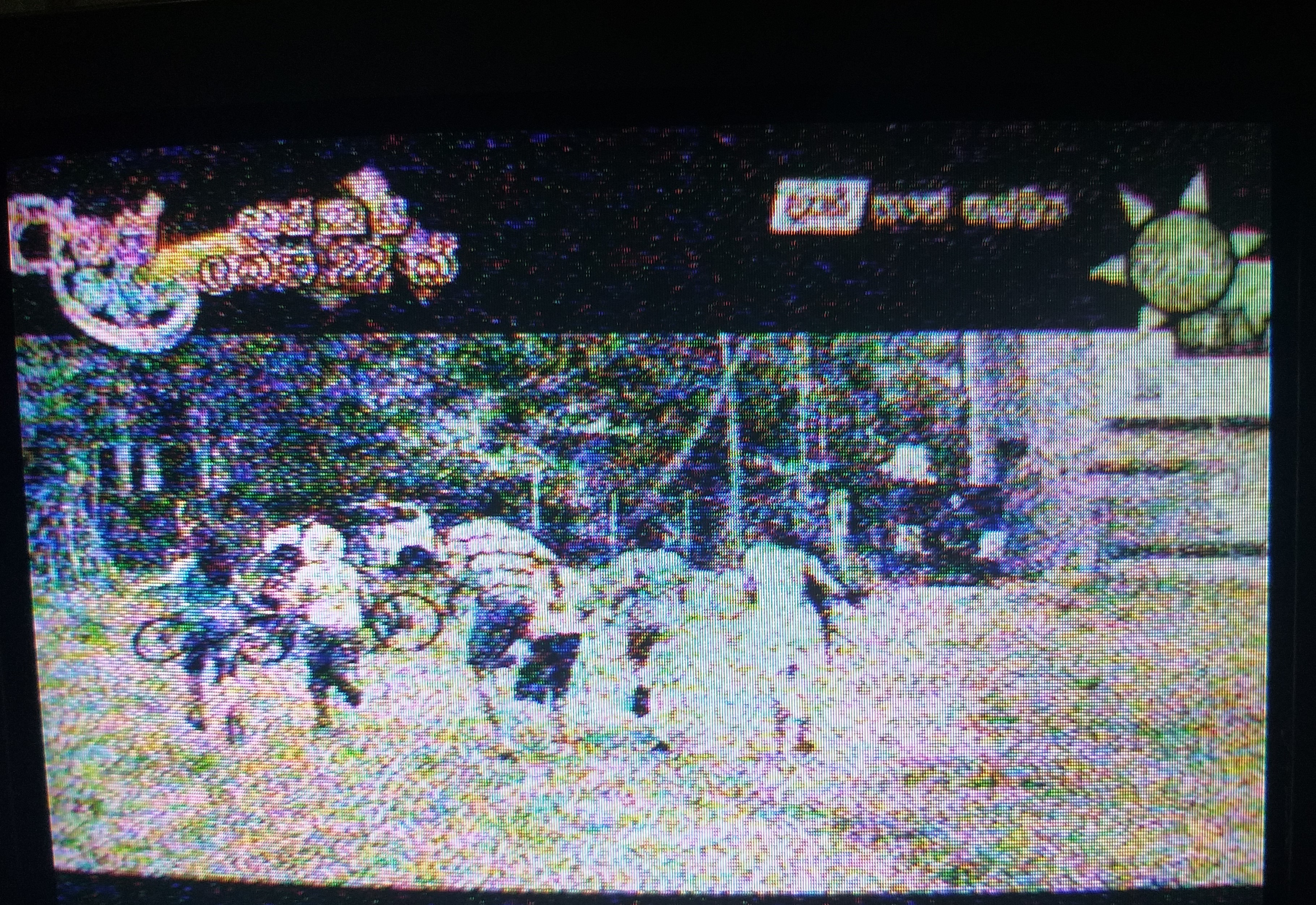

I got Sony TV and when i switch off it there will be a white spot on the middle for less than second. how to fix this issue. this is KV-J21

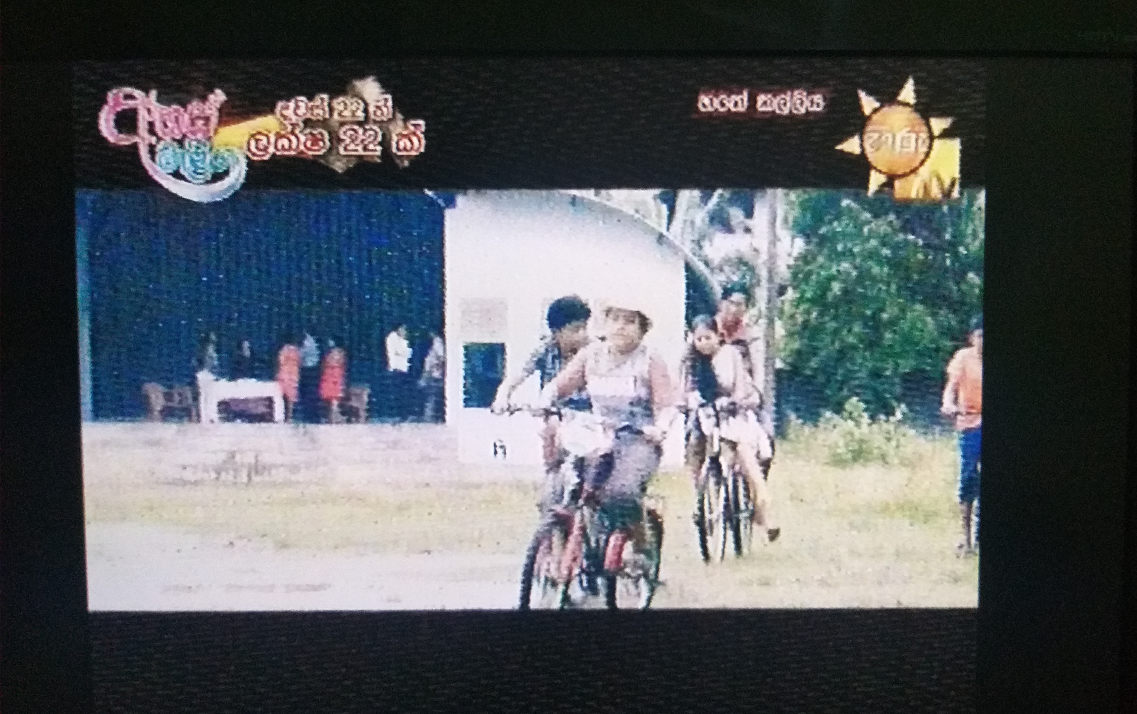

Thank you for the update. this is the similar diagrams as this uncommon model - KV-J21 MF1. recently I replaced the fly and TDA 8375A as both faulty, and ABL resister as well. The TV looks very colorful and bright now. small color patch on right side - see CRT.jpg. and LCD show the correct color . issue is the blue/white dot during shut off
