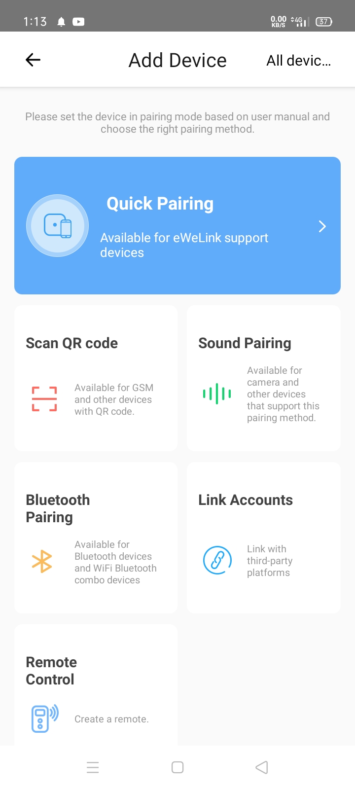

Now comes the puzzling part. It's about the app eWeLink.

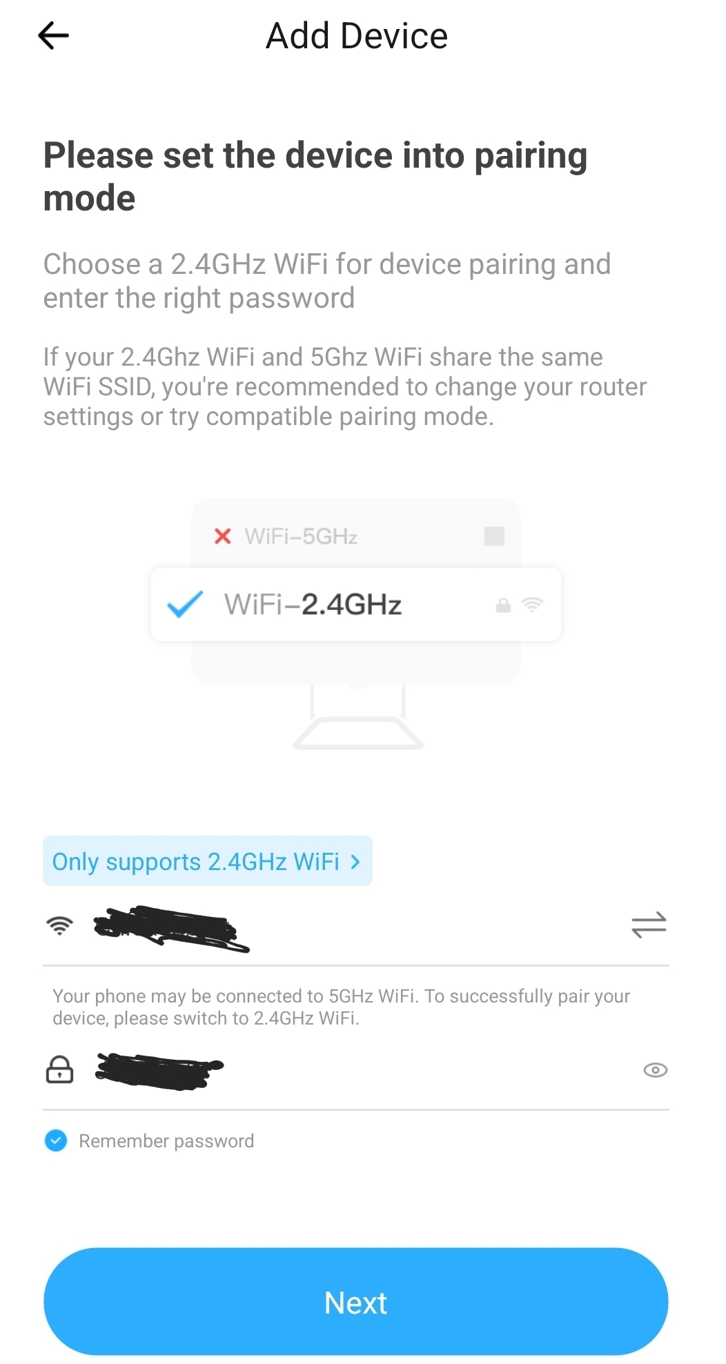

I select Quick Pairing (because the device supports eWeLink) and I get this:

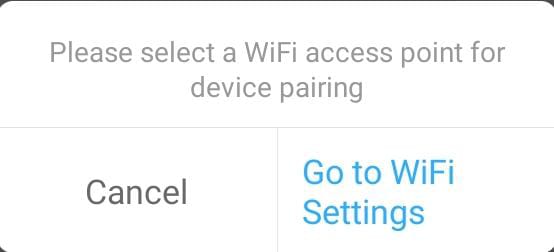

This takes me to my phone settings and no matter what I click or select, it never successfully finds an "access point for device sharing" (whatever that means).

When you get the screen shown in your first post on your phone you select Quick Pairing.

When trying to pair with it through ewelink, it demands a "WiFi access point" and wouldn't let me be content with using it offline.
And I don't know how to connect to it through my home WiFi (because I can't "select" the home WiFi when demanded to. It simply disconnects the sonoff wifi and my phone connects to the home WiFi).

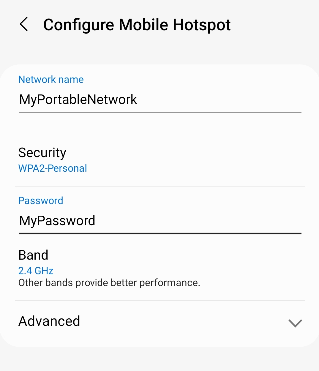

Since you don't want to use it at "home", don't set it up with your home wifi network.
If your phone supports being a wifi Hotspot, do this.
1. Set up your phone's Hotspot. The pictures are from my Android phone.
Be sure to choose the 2.4GHz band.
2. Open the Ewelink app, click the plus sign at the top to add a device, and click quick pairing.
Fill in the network name and password from step 1, make sure you phone Hotspot is enabled, and follow the instructions from here.
After this is done, you will be able to use the Sonoff device any time your phone Hotspot is on and within range.
If your phone does not have the Hotspot feature, you're out of luck if you want to use the Sonoff away from whatever network it's configured for.

I am already doing all of this.
The problem arises after I hit "NEXT". It demands to be shown a "WiFi access point" and won't add the device until I do that.
I'm stuck at this stage

As I have explained twice now, the phone Hotspot IS THE WIFI ACCESS POINT to allow you to operate away from your home wifi. Perhaps I don't understand your use case.
