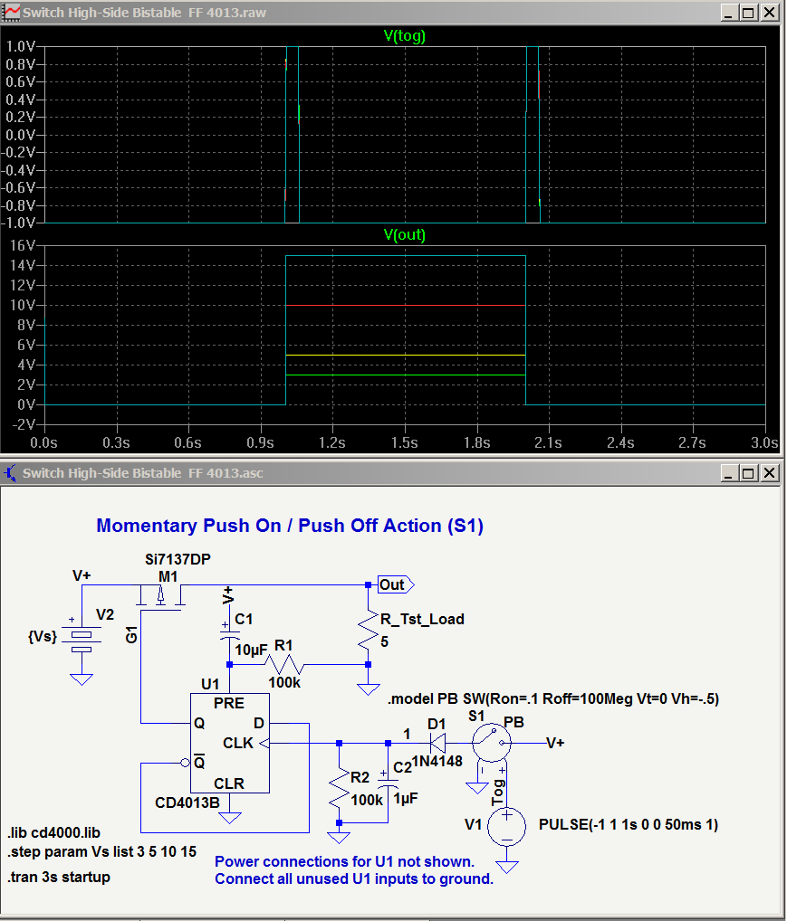

Below is the LTspice simulation of an alternate action high-side MOSFET switch that should always come up in the OFF state.
V1 with S1 simulate your reed switch.
It's shown operating for voltages from 3V to 15V.
Edit: After further simulations, I determined that my original circuit would not necessarily come up in the OFF state.
The alternate circuit below uses a CMOS flip-flop with a power-on reset so it always comes up in the OFF state (Q output high).
Note that to operate at a supply voltage of 4V, M1 needs to be a logic-level type MOSFET the fully turns on at a Vgs of 4V (specified for the Rds test voltage in data sheet).
  • Switch High-Side Bistable FF 4013.asc

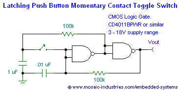

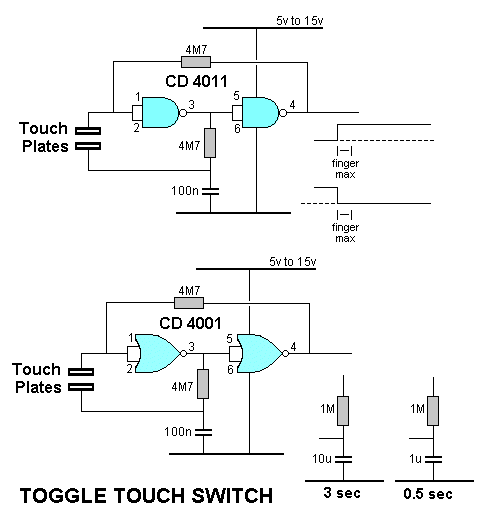

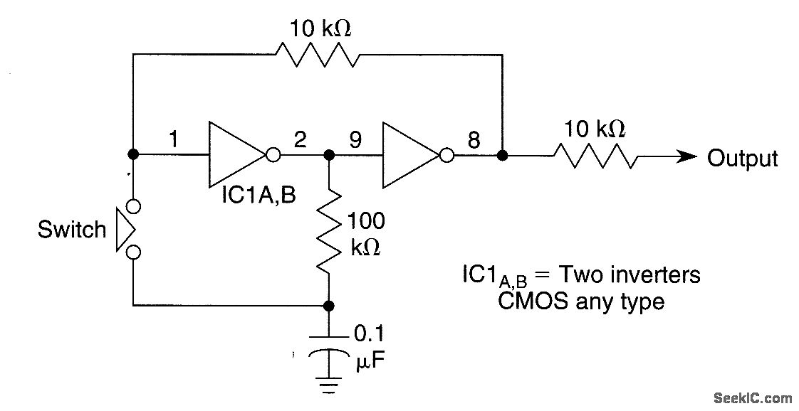

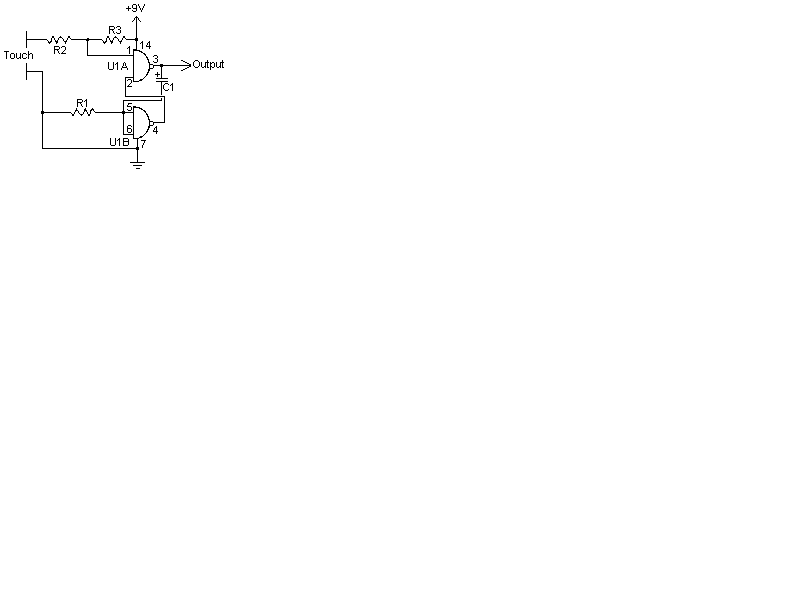

Here are a few examples. All of them present power up consistently in the same state and have complimentary outputs, so your output FET can be connected to either power-on state. A common feature is that the next toggle action is not available until the capacitor has charged up or down, but this delay is milliseconds. My fav is Toggle-20096.
ak

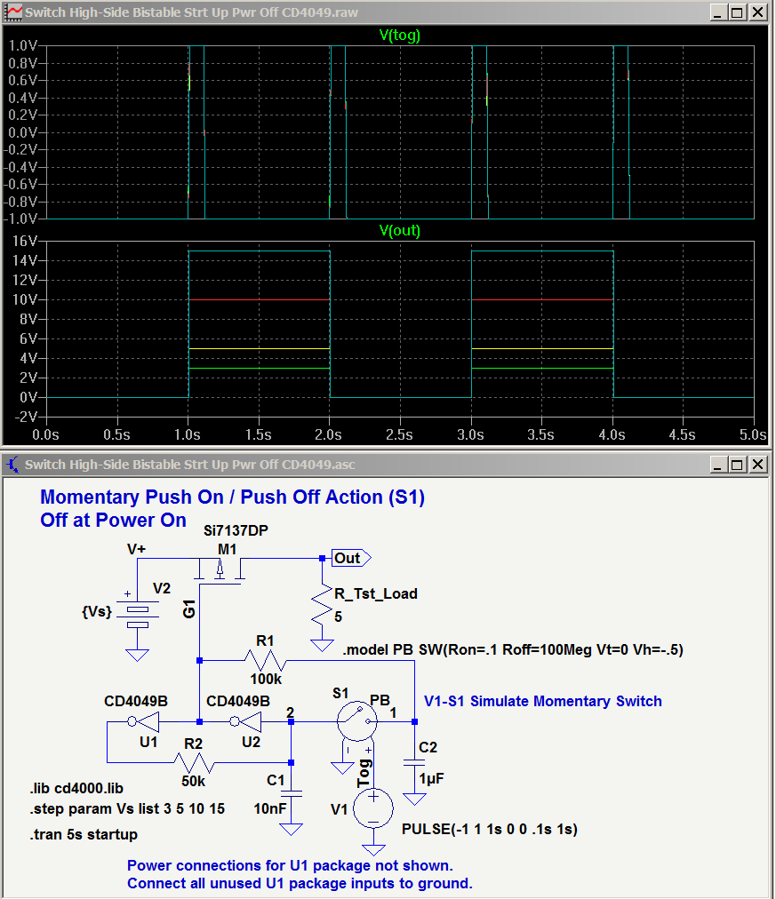

Here is an LTspice simulation of AK's circuit as shown in his attachment, connected to a high-side MOSFET driver for supply voltages of 3V to 15V.
C1 pulls the input to U2 low at the start which insures that the circuit always powers up in the MOSFET OFF state [V(G1) high].
(It's not clear to me that the other circuits that AK posted will reliably come up in a known state, expect perhaps the first one). :confused:
  • Switch High-Side Bistable Strt Up Pwr Off CD4049.asc
