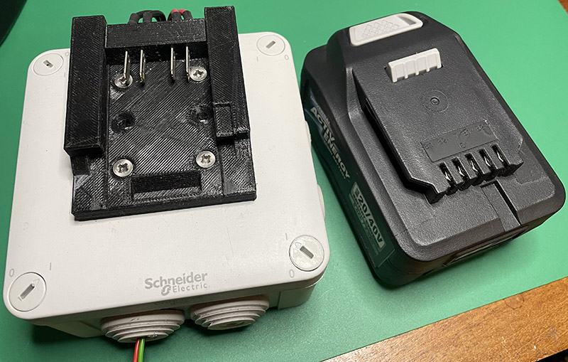

I also use power tool batteries for some things, with 3D printed "sockets" to mount the to whatever they are powering.. The Aldi 20V & 40V batteries are cheaper than buying good quality loose cells; I put the connector design for those on Thingiverse. The box in the photo is a regulated 15-0-15 supply for testing analog gear.
