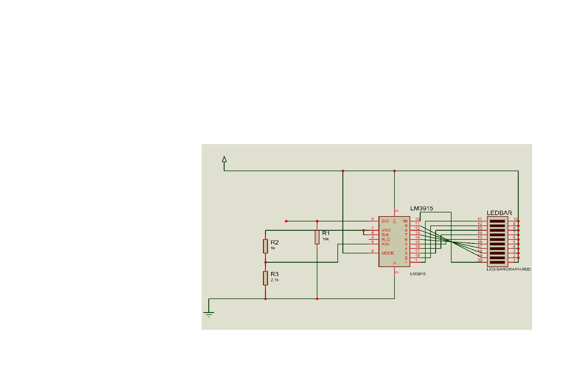

simple TL071 Circuit with an lm3915.
1)I wanted to know how to connect a tl071 mic amp like the one provided in this thread to an lm3915. Is a rectifier circuit need? That is done.
2) The main problem lies with pins 2 thru 9.
I have;
v- pin2 to ground
v+ pin3 to vcc
divider low end pin 4 to ground
signal input pin 5 from mic output.
diver high end pin 6 tied to pin pin7
ref output pin 7 r1=1k, r2=2.7k, to ground
ref adjust pin8 tied between r1 and r2 above
mode select pin 9 to vcc for led selection
anyone see any fundamental flaws here or any suggestions?
It works a lot better with a peak detector from the preamp to the LM3915. But you did not post your latest schematic so I don't see your rectifier circuit.
The datasheet and my circuit shows what to do with them.
I have:
No.
The signal level from the mic is much too low. It needs a preamp to increase it to a few volts. Pin 5 needs a resistor to ground so that it is 0V without a signal that is fed through a coupling capacitor.
divider high end pin 6 tied to pin pin7
Then all the LEDs will try to light when the input is +4.625V which is not possible when the supply is only 5V. The max reference voltage is +3.5V when the supply is only +5V. Your reference voltage is set wrong.
The current in the LEDs will try to be 12mA each.
No capacitor to leds.
Without a schematic then I do not know what you are talking about.
schematic
Below is what i have built on breadboard working.
I added a 100k resistor so its 0volts with no signal, is that too much resistance? Also either all lights turn on or they all turn off when mic is getting signal.
the input to pin five is the output from half wave peak detector.
Where is the 100k resistor?
Then something is wrong.
All LEDs should be turned off without a signal.
The first LED should turn on with a low signal then more LEDs should also turn on as the signal gets louder. All LEDs should turn on when the signal is 30dB louder than when the first LED lights.
Connect pin 4 of the LM3915 to 0V.
You show a 1M resistor at the output of the peak detector which is correct. But you also show a 10k resistor at the pin 5 input of the LM3915 to ground that should be removed because the 1M resistor is there.
r1 = 100k resistor sorry
with pin 4 to ground I have only the last two leds flickering and the other eight are on. I removed the r1 = 100k at pin five becasue of the 1M resistor from the ouput of the half wave peak detector. How do I get the flickering to start from the least significant led(say led 1 or 2) instead of almost the most significant (led 8)?
The led light intensity is nice and bright...

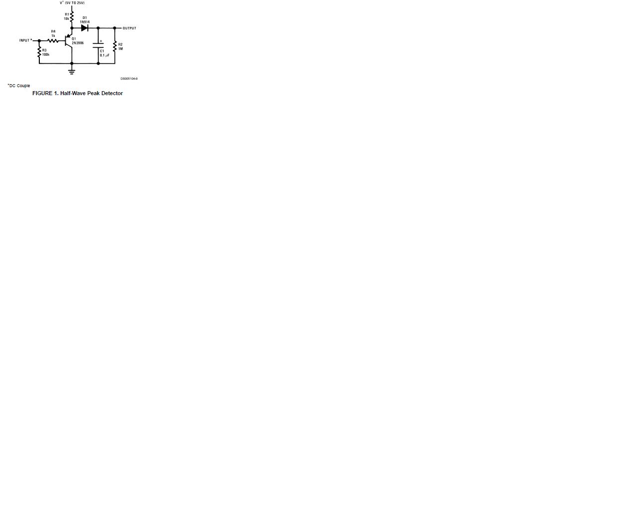

The half-wave peak detector has too much offset voltage.
Use the half-wave peak detector circuit that I use using an MC33171 single or MC33172 dual opamp and a transistor.

Scrooge, Its not that I dont like your mc33172 circuit. I built it and it got messy on me and I have no idea weather my chips are dual or single.
Is there any way to lower the offest voltage from what i have? Heres what I figured out puting voltages instead of the signal from the mic amp.
Look at the datasheet:
The MC33171 is a single opamp.
The MC33172 is a dual opamp.
LED1 0.2V
LED2 0.4V
LED3 measurement not taken
LED4 0.6V
LED5 0.9V
LED6 1.1V
LED7 1.4
LED8 2V
LED9 3V
LED10 4V
It looks like the base-emitter voltage of the transistor does not match the forward voltage of the diode when the current in the diode is almost nothing.

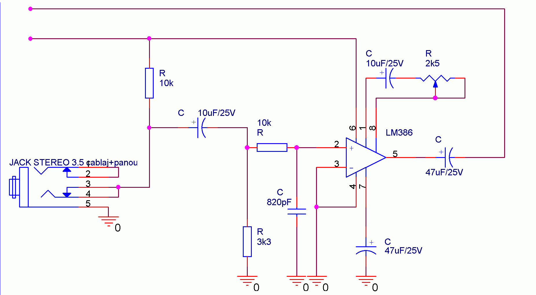

audio decibel meter lm386
Hi I wanted to create an audio decibel meter using an lm386 with an lm3915.
I can connect a speaker to the output of the lm386 and hear the input at the output with a speaker. I need to know what i need to merge the two IC's so that they can work together. I have a decibel meter for calibration but at this point it is useless. I connected both grounds together as to make a common ground. Input to Pin 5 on the lm3915 is the output of the lm386 but I'm really not getting anything..Any ideas or help would be greatly appreciated..Thanks..

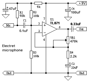

Hi i'm new on this forum to, and i whant to create the same project but onlie whit LM 386 **broken link removed** . I must display the sound intensity from input(from microphone) in dB. I must use ATmega64 which is included on a test board (CEREBOT). I must read the signal from preamp output and display'it in dB, of course using ADC (I dont know how i must programm the ATmega64 to do this ). Can somebody help me. My preamp is one board and the CEREBOT is another one. I must use the Code Vision AVR HP InfoTech, Development Tools for Microcontrollers, C Compilers, In-System Programmers programming environment. My project is simplyfied and attached below.
