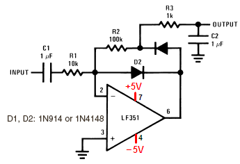

Which do I need for the input to the a/d on an atmega32 microcontroller from above;
1. Half wave peak detector
2. precision half wave rectifier
3. precision full wave average detector
4. or a precision full-wave peak detector?

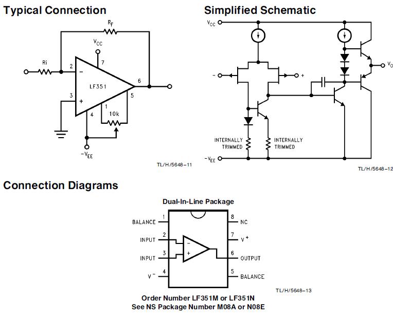

vee and vcc
what can I do for v+ and v- for an LF 351? V+ say straight to 9v what about v- ie pin 4.. I dont want to assume its like the typical connection below in the picture becasue thats not a precision half wave rectifier like the data sheet from the lm3915.
Thanks in advance.

The LF351 needs a dual-polarity supply in that circuit.

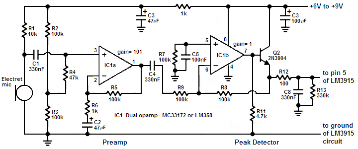

In my Sound Level Indicator project (it is too complicated for you since it has an automatic gain control) I used an MC33172 dual single supply opamp and a transistor as the rectifier diode like this:

My MC33172 circuit is a mic preamp (like the TL071 mic preamp) plus a precision half-wave rectifier circuit but not needing a negative supply voltage. That is all you need.
Or instead you can use a TL071 mic preamp plus an LF351 precision half-wave rectifier that needs a negative supply voltage.
Both circuits will perform the same. Select one.

Why don't you like my MC33172 circuit? It does not need a negative supply and it works perfectly in my project. It has more than 50dB range.

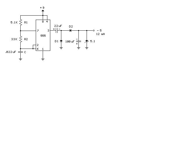

negative voltage
i dont have the parts in yet but i will. In the meantime,
for a negative voltage here is what i found. I tested it im getting negative 1 volt not negative 5 which is what im looking for. I found this schematic online through google.
My question is, what value of diode is supposed to be used based on the schematic any suggestions?
I would greatly apreciate it..
The 555 oscillator/rectifier circuit has two rectifier diodes and a 5.1V zener diode that limits its output voltage to -5.1V.
Maybe you connected the zener diode with backwards polarity.
-5
I tried the 1n4001 diodes again and im still getting -1 volts or so. what would you suggest to do to get a negative voltage?
Do you have the 5.1V zener diode connected with its cathode to ground?
What is the load on the -5.1V supply?
