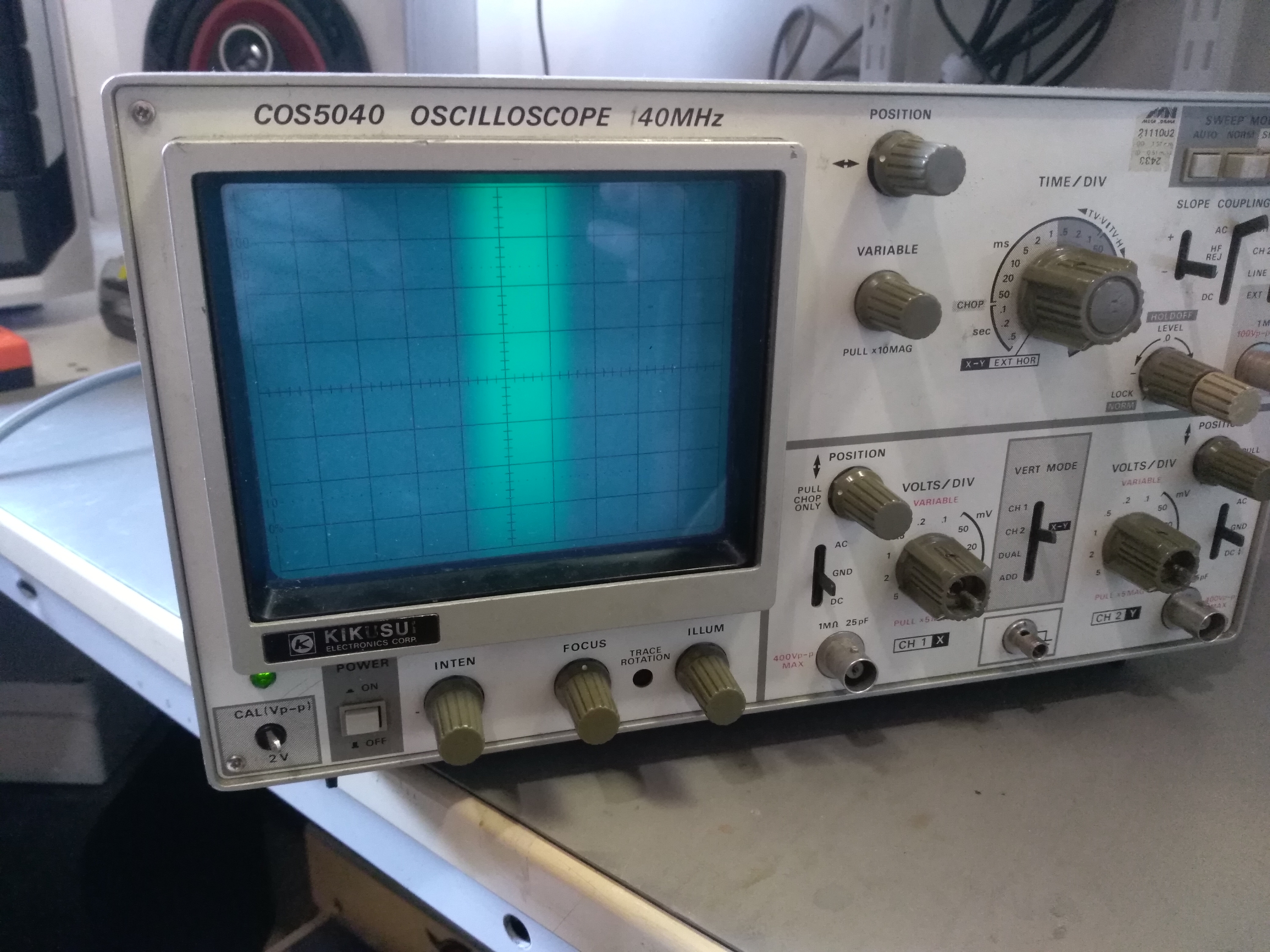

Initial problem with this oscilloscope, was gone channel 2. It was super dim at best, barely seen as best described "overshot noise". This happened just few days ago.
Now today, I took vertical amplifier board out to troubleshoot components. Suspected components were ok (tested out of circuit one-by-one.
Now then, when I placed board back in place, BOTH channels are gone, beam is stuck on place with full intensity (intensity knob doesn't do anything). Obviously I thought bad contact and started fiddling knobs (vertical intensity knob on channel 1 did make beam bigger in vertical direction, but time/div and horizontal position were stuck). Making matters worse, smoke started rising somewhere....no idea where, but smoke is smoke.
'scope in question is kikusui cos5040, and I do have schematics available. Although I have bad feeling about this repair attempt!

Ok, slight progress.
Channel 1 back online. Didn't take anything out of circuit, but took pcb's out for visual inspection. After putting all together, channel 1 works.
Loose connection?
Channel 2 is still dead, both visual side and triggering.

More odd stuff:
vertical=dual
Up to 0.5ms (until tv-v/tv-h) no dual traces, but channel 2 position also affects channel 1. Offset caused by channel 2 position knob is always one reticule with some noise on top, not affected by volt/div settings.
Bit more info: since triggering doesn't work either with channel 2 to display channel 1, measured points at vertical amplifier section, where also is internal trigger output. Diodes CR108, 208, 107 and 207 are acting as switches that are controlled by U301 (pins 5 & 6). Channel 1 triggering signal comes just fine, but channel 2 is way too much attenuated.
U202 input from attenuator resistor thingy (...) comes at pin 9, both channels show same signal there. Using external function generator feeding 'scope in question. Signal is attenuated between channels when comparing voltages at bases of Q205, Q206, when comparing channel 1 Q105, Q106. There's around 50% difference. Difference with Q208 and Q108 collector voltages are even more, 52mV vs 540mV.

Ok, previously mentioned 0.5ms time/div problem is not tied to time/div, but alt/chop. In dual operation mode, chop mode causes channel 2 position knob to affect channel 1 position. There is something really weird stuff going on.
Found good source of information, which has part discussing vertical part too.
it mentions commoning push-pull amplifier section and by using that trick of shorting bases of push-pull pair, I got second channel on screen (channel 2 position knob however still affects channel one position on chopping mode, but progress anyway)
Shorted first Q301 and Q302 bases, beam centered, so fault is before those. Previous push-pull is made by Q205 and Q206, again centered.
I also noted quite high voltage differences between right side pins of U202 and U201, both in DC and AC region.
Also, when short in place, XY-mode works as intended too, even if combined with line-trigger. Line and/or dot can be moved with position knobs.
Found one faulty part, and even it is only partially broken. U202 pins 1 and 2 show infinite, tested both DMM and octopus tester with another 'scope. All other pins function. Makes me wonder what has killed those pins. I tested it out of circuit.

Intesity problem sorted itself out (poor connection?), since channel 1 came back alive. Channel 2 only comes as horizontal line when those transistor bases are shorted, what I mentioned earlier.

So it sounds like channel 2 beam is missing either because there is no trigger pulse getting to it, or it is being pushed right off the screen by a DC voltage occurring before those 2 transistors.

Haha! I was going to flip video around before upload. During troubleshooting it also had to be upside down causing slight confusion using controls. Thankfully isolation transformer switch is nearby if things go sour. When you see second channel, that's when I short those amplifiers. I checked that busted part and thankfully It's not expensive. It's back in place now to hopefully prevent furter mishaps.
Ok so what does pulling/pushing the position knob supposed to do? Seems like a nice clearly defined fault now.
Pulling postion knob changes chop sweep only with dual trace operation. Normally It's either chop or alternating, but position knob can override that setting, so only chop is used. Without it, chop/alt is chose from time/div setting (<0.5ms is alt).
