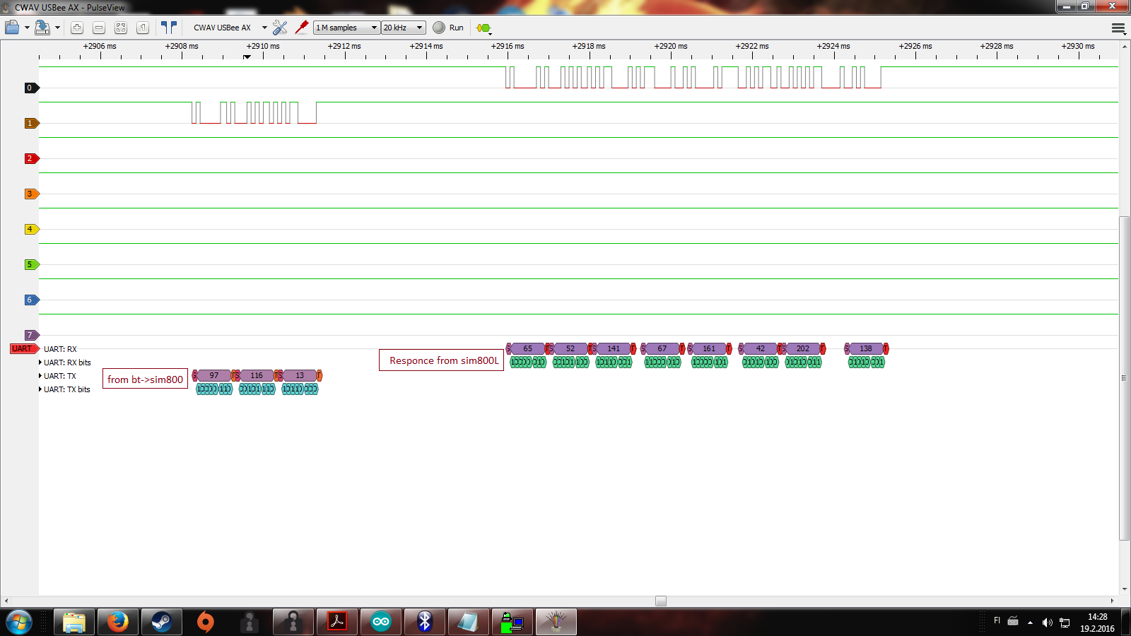

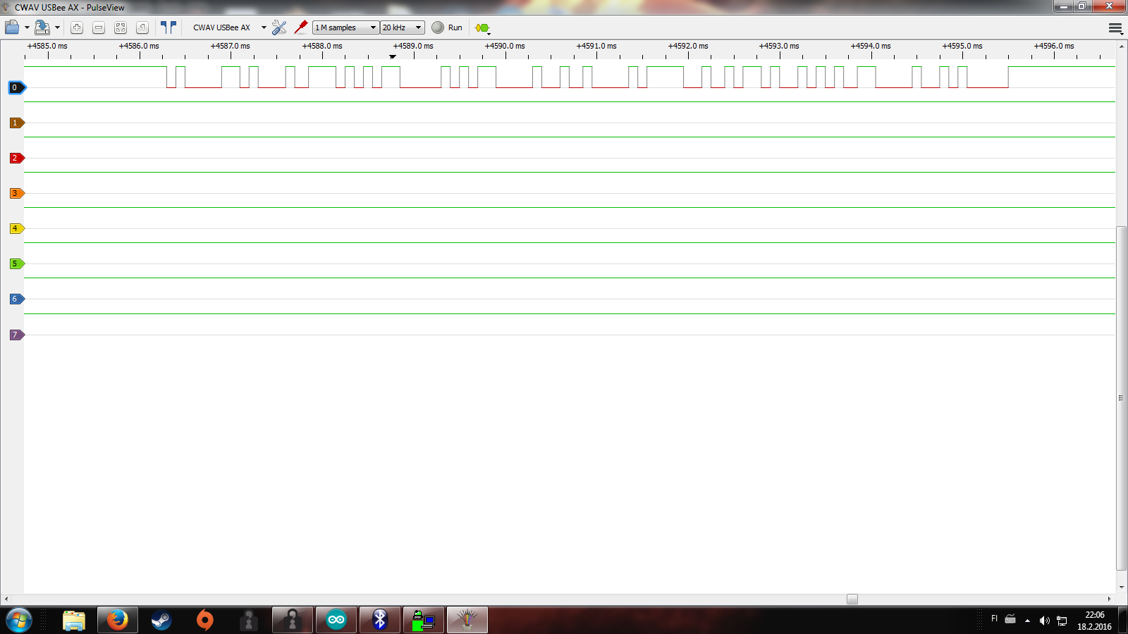

hmm led blinks 5 times at first, then even without even input it starts blinking again at same frequency....
Here, took output with analyzer, any help?
Channel 0 is RX, forgot to rename labels...
For reference, here is \r\nOK\r\n, sent from bluetooth, earlier was from SIM800
Here is decoded output, responce is indeed strange from sim800

hmm, serial shoots carbage out in arduino serial, baudrate matches though, it shoots out ÿÿÿÿÿ, if receives "OK" from sim800L, if I send "<cr><lf>OK<cr><lf>, output is ÿÿÿ
yes, they all match,9600 baud, none parity, 1 stop bit, 8 bits
IPR returs 0=auto baud, ICF returs 3,255=8 data 0 parity 1 stop (none parity)

So far I haven't changed anything, it was 9600 from the beginning; only boot-data is send at higher baud, 115200 that tells sms ready and stuff like that. Normal data is then sent with 9600 baud, or whatever is set. See AT+IPR from datasheet, that can be used to set baud

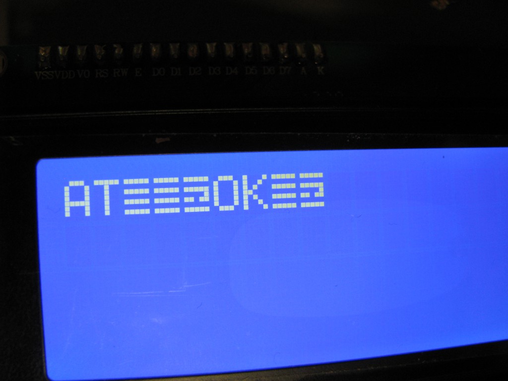

I got it working! turned out, sim echoed command sent to it, and I figured that out by using LCD as translator what it actually sends, so \r and \n showed as random gibberish. So, we were close, here's final code:

and this code I used as translator so to say:
C:
#include <Wire.h>
#include <LiquidTWI.h>
// Connect via i2c, default address #0 (A0-A2 not jumpered)
LiquidTWI lcd(0);
String a;
void setup() {
  lcd.begin(20, 4);
  Serial.begin(9600); // opens serial port, sets data rate to 9600 bps
void loop() {
  while (Serial.available()) {
lcd.setCursor(0,0);
  a = Serial.readString(); // read the incoming data as string
  Serial.print(a);
  lcd.print(a);
  lcd.print("  ");
and lcd's output
Thanks for help! :)
