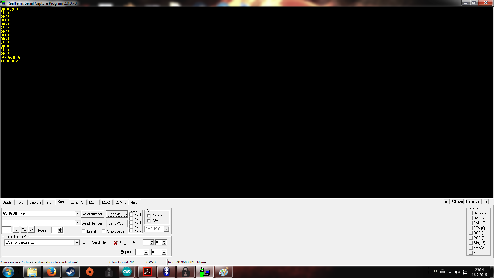

Ok, so the problem now is this:
I have sim800L module, that i've succeded to get working, was quite chore to program....but now I'm trying to implment it to arduino/teensy!
And in case someone wonders, this is not part of any project yet, just learning how to use it :).
I have code that I'm planning to use as hard-base, but I think carrion return and/or newline causes trouble, my current code is as like this:
AT-command gives ok as return, and it should light up led, just a test skecth for now (Sending AT-command doesn't cost anything so good for starters)

and this is the output that module shoots out, OK as excpected, and ERROR just for reference
So, how should those CRLF after returning stuff from sim800 should be implemented to code?
Sorry if this was confusing, ask if need arises!
What do you mean by "should be implemented to code"? Serial communications end each line with CR LF. Except for custom protocols. When reading, that character pair denotes the end of line. Println adds those characters to its output.
Your terminal program probably has a setting to display control codes. If you turn it off, it will not look as strange. Normally those characters are there, we just don't see them.
By implementing I meant just basic code, just chose wrong words perhaps. For start all that's needed is like if sim800 sends string "OK", light up led.
Terminal program I use now is realterm. The question is how those CRLF characters should be placed in serial.read(), as even if I read "OK" from serial monitor, led doesn't light up, even thought tested that it lights up, if I send "OK" from any other TTL-serial device, like bluetooth dongle, or USB-TTL converter...did this help at all?
This is first time I see CR LF characters in serial monitor, that might cause confusion here.
On the Arduino, serial.read returns one character at a time. So the first call would return "O", the second would return "K", next call returns a CR and so on. Here is a link to the documentation .
You need a routine to read a line and return a character array or a String.

Yes, and furhter tested, this works IF I send this specific string via bluetooth module, so there's something else tricky here:
C:
if(a=="\r\nOK\r\n") //All 3 combined, works via bluetooth
hmm, my rigol scope has serial decode, perhaps it could shed some light (or logic analyzer) what sim module ACTUALLY sends
