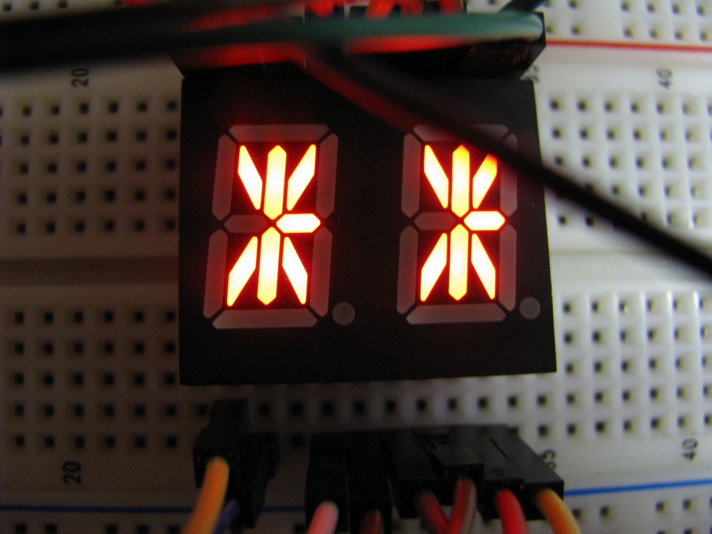

ok, that fixed fontmap error, screeen shows flickery on all second registers segments if I want to show charput(5), but when I place that counter as testing, values 0-9 are seen as coutning goes on, but second register values are still on flickering.

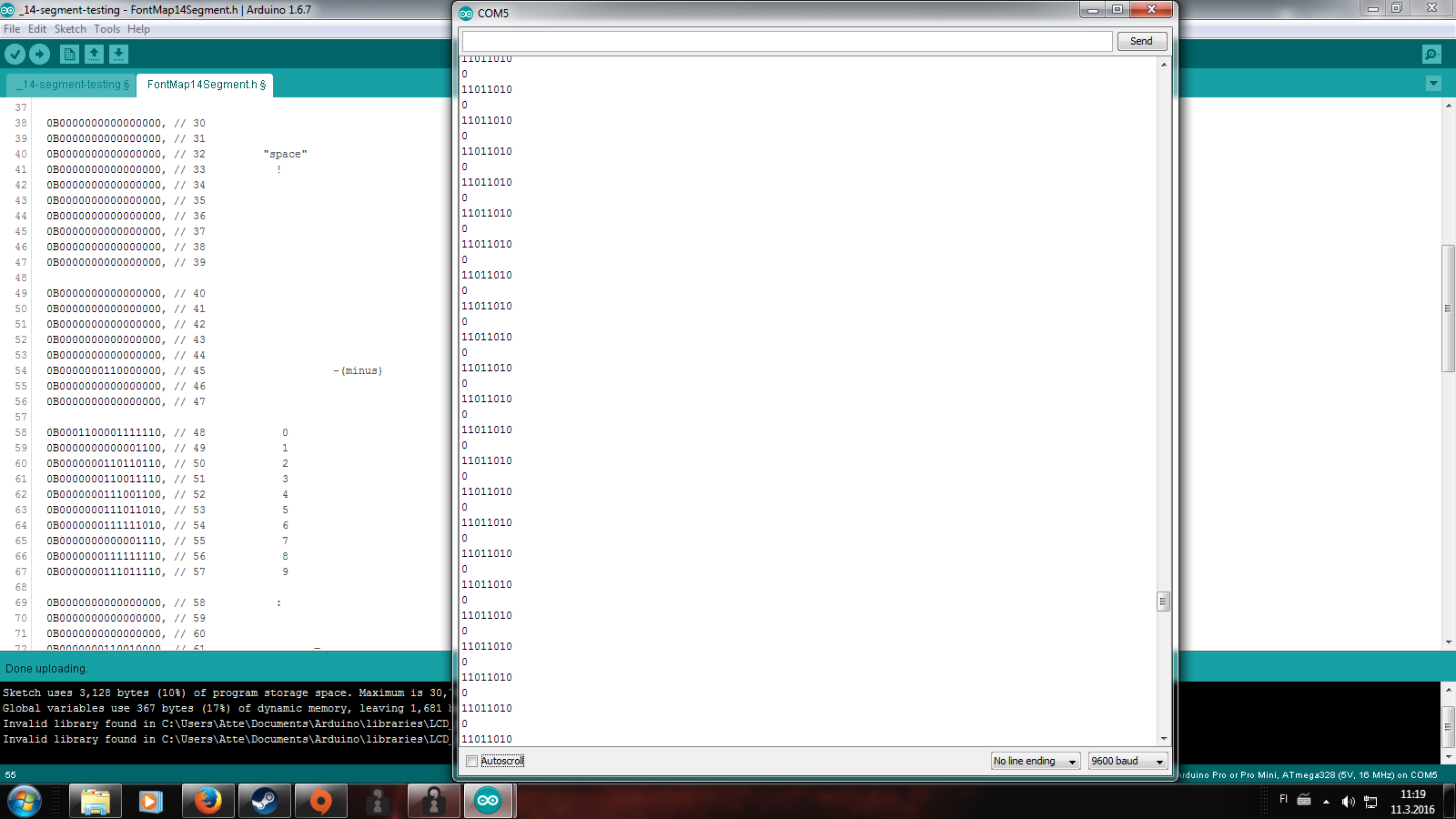

  Serial.println(disp/256, BIN);
  Serial.println(disp & 0xFF, BIN);

and here's shot from serial montior charput(5):
and new fontmap as attachment

Hmm, that test loop didn't effect anything sadly :(
ready to post more vids!? it will help by visualizing which parts are being passed out wrong, feel free to turn delay up if it runs too slow
ANYTHING to help! To give brain little "breather" I tried to combine matrix with 7 segment, so 7 segment shows values/time etc and matrix would work as text display only, didn't work....at least yet.
The video I posted eariler was output for video you asked, same result, only no even flickery numbers seen
post 347 should display 1 pixel at a time, should... ...pls elaborate of flickering, do you mean just like in your post 336? also i edited post 347, pls retry
wait, i thought we were using 14 seg... pls post new schematic if you have them all hooked up, may as well hook up vu meter too if that is what you want to do, also vu datasheet/partno required, we may need to be careful here, since i recall we were short on memory using the 32x8 fontmap alone...
The flicker I mean is overall refresh rate; it's smaller when ISR rate is decreased->refresh rate increases so it's "normal" flicker. At OCR1A value 100 it's barely noticeable. But screen shows nothing like in post 336, only segments that are controlled fromn second shifter are lit. YES we are using 14 segment, but I tried to hook up 7 segment to matrix as daisy chained, as it too used 8-bit values, and I ahve working code for both 7-segment as well as matrix. If we run out of memory we can use teensy, I found solution how interrupts can be used with it and tested with matrix scrolling text+real time FFT, took about 40% of program storage and 25% RAM. So the final project in any way is some-digit 7-segment, OLED 128x32 that shows FFT and matrx that scrolls some random text, perhaps "good morning" and stuff like that.

Quote: Only segments that are controlled from second shifter are lit.
pls post vid, its important to see what code from post 347 does to the output matrix, in order.... unless you are saying its blank?

Still shows that x-shape, and no other numbers or anything. serial gives out fontmap positions as earlier :)

Doggy! I'm SO sorry, I started doing basic tests and send three times 0's (B00000000) and still second set were on, there was ONE wiring error,, I'll re-do those previous codes!
