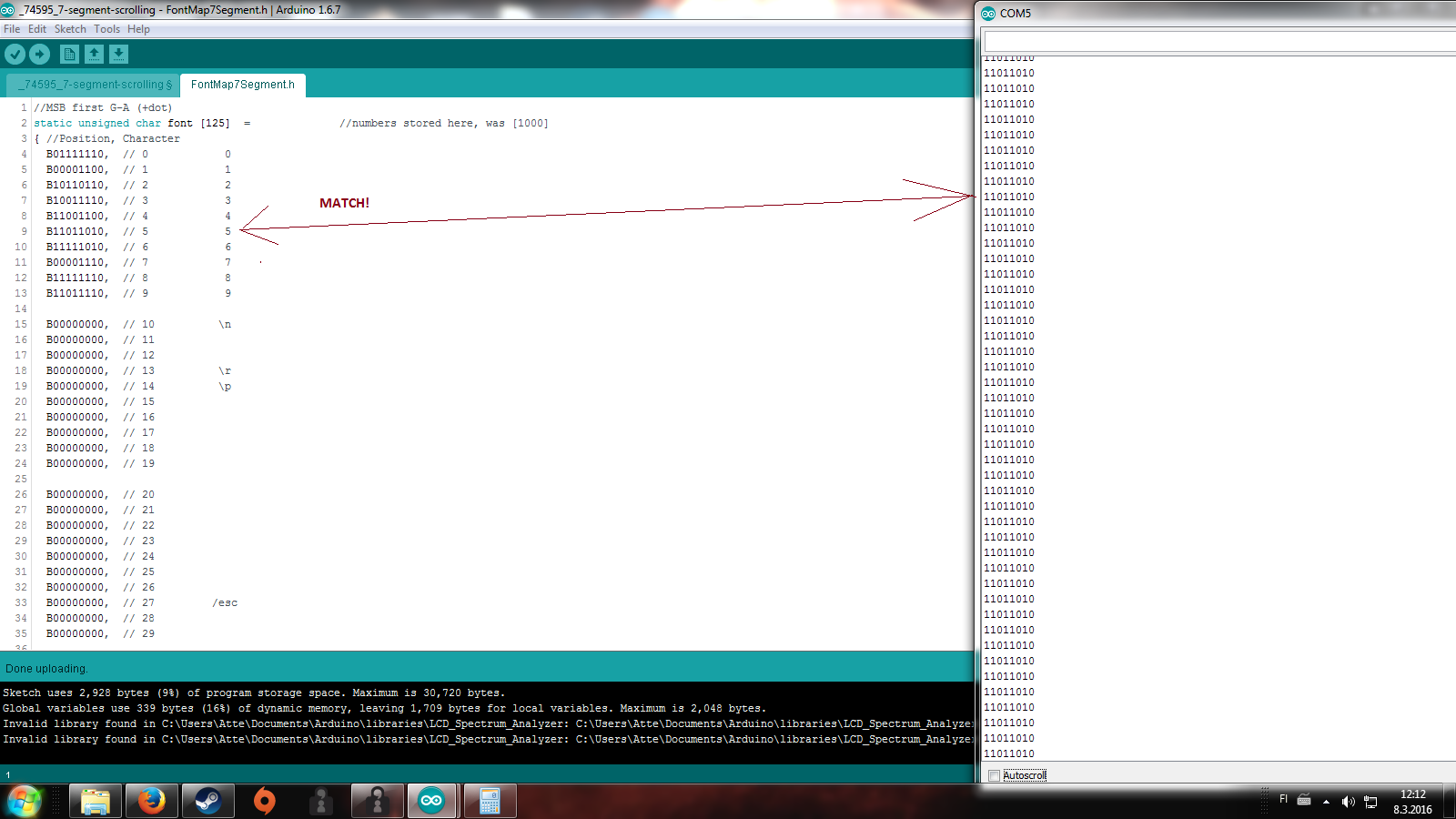

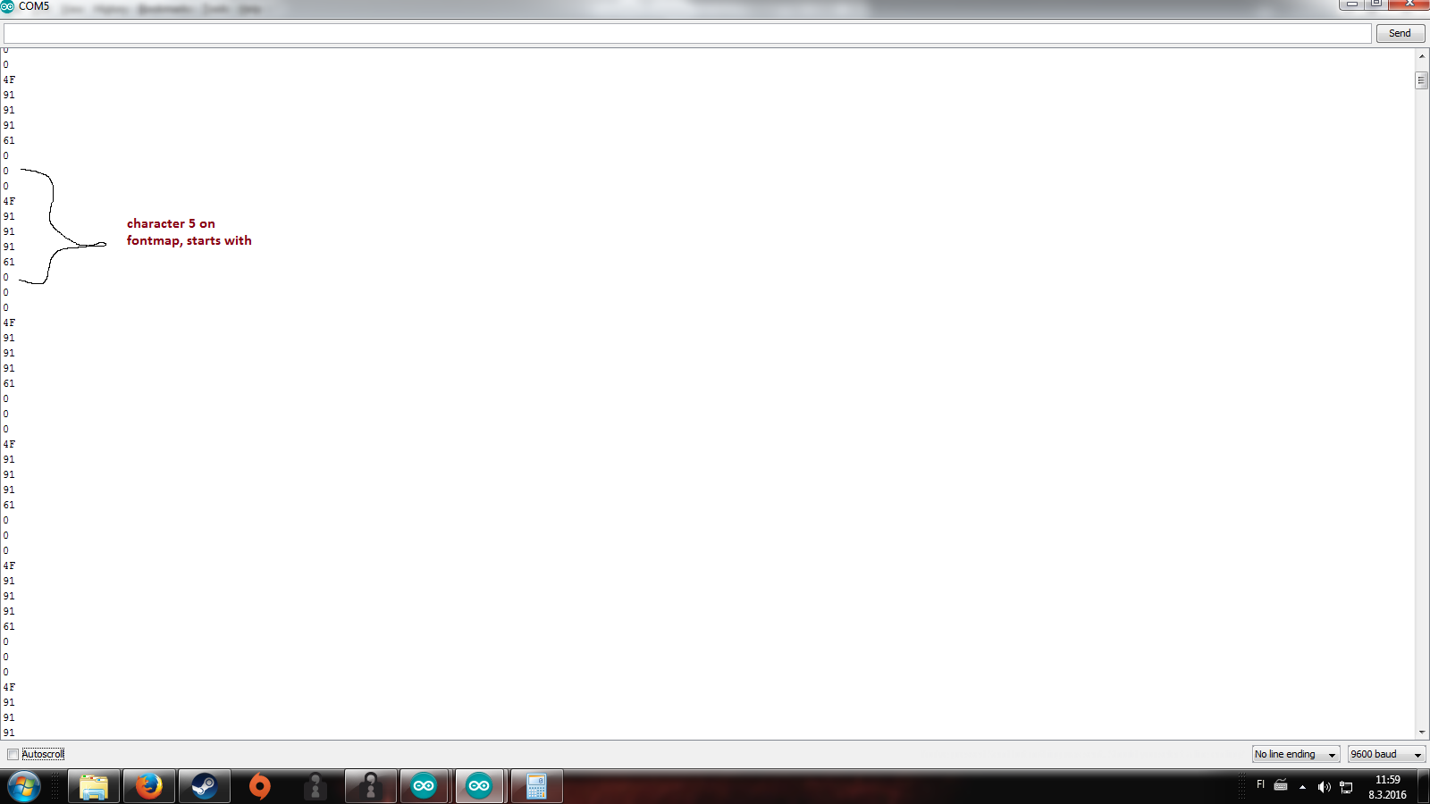

Doggy, I used serial port to debug on where in fontmap is it reading for fontmap: this is from working matrix and indeed it reads like should for character 5:
C:
void charput(unsigned char ch, signed char x, signed char y)
  signed char x1, y1;
  unsigned char disp;
  unsigned char disp2;
  for ( x1 = 0; x1 < 8; x1++) // eight rows
  disp = font[x1 + (ch * 8)];
  Serial.println(disp, HEX);
  for (y1 = 0; y1 < 8; y1++) // eight pixels
  disp2 = disp & power[y1];
  if (disp2 > 0)
  pixel(x + x1, y + y1, 0); // OR the pixel to the display buffer
and output with hex values (as fontmap used also hex so easier to compare)
now then, this new one, it READS from current place from fontmap, but draws 0 on all values between 0-9, but find correct value on fontmap according to serial monitor o_O? so halfway it works, like reading english but talking japanese lol

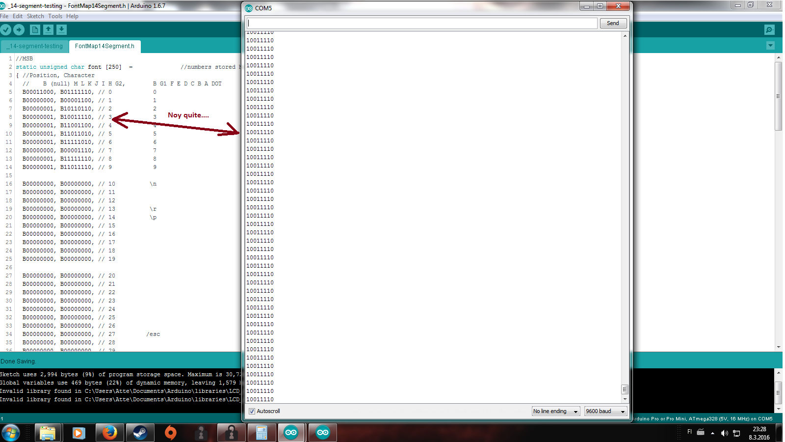

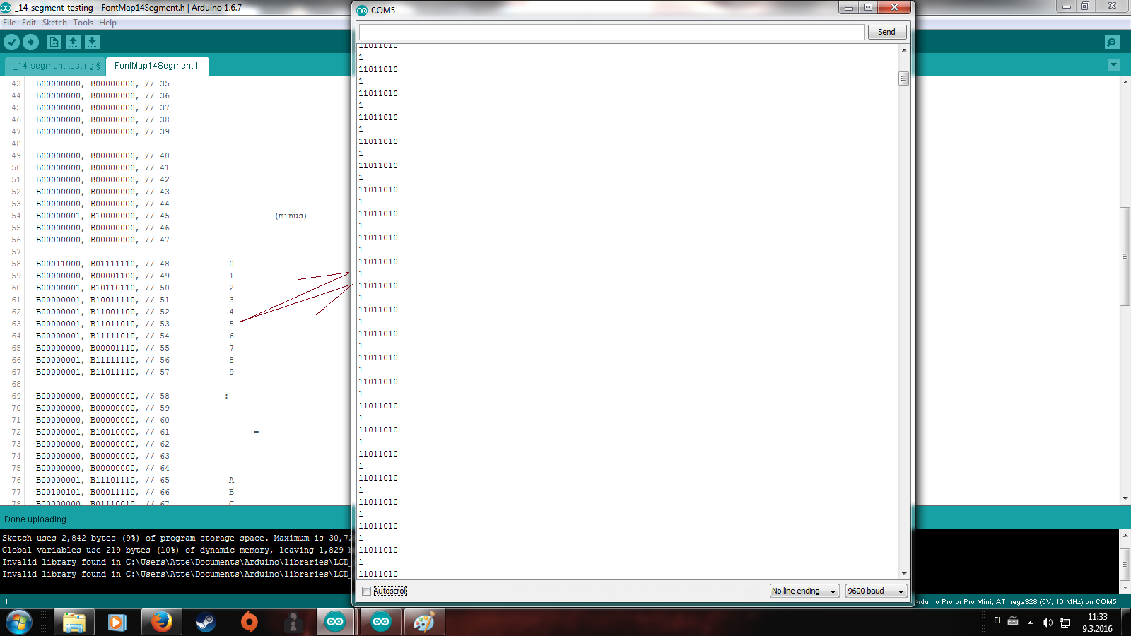

C:
  signed char y1;
  unsigned char disp;
  //for ( x1 = 0; x1 < 8; x1++)  // eight rows, still eight bits to load so no changes
  //  disp = font[x1 + (ch * 8)];
  disp = font[ch];
  Serial.println(disp,BIN);  //display as BINARY format (Bxxxxxxxx) as fontmap is in binary format
  if (disp2 > 0)
  //pixel(x + x1, y + y1, 0);  // OR the pixel to the display buffer
  pixel(x, y + y1, 0); // OR the pixel to the display buffer
and here's reading:

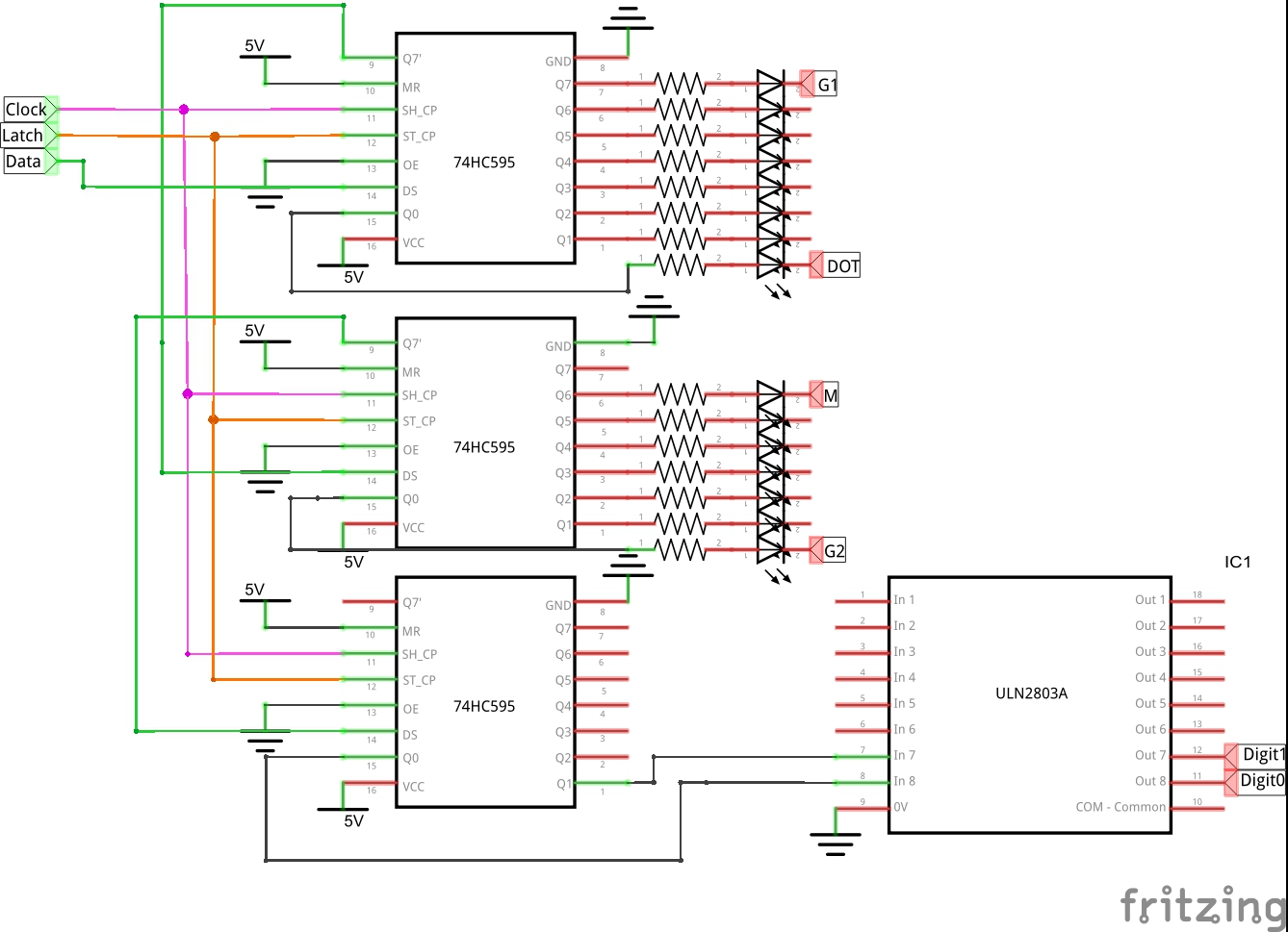

int dataPin = 2; // ic: 14, ser_in Define which pins will be used for the Shift Register control
int latchPin = 3; // ic:12 silkscreen numbers!
int clockPin = 4;
  signed char y1;
  unsigned char disp;
  disp = font[ch];
  for (y1 = 0; y1 < 7; y1++)  // eight pixels
  if (disp2 > 0)

Thanks again doggy, it was close, in fact yet again you made my day, it showed 8, but I tried:
C:
  x += 1;
and that did trick, now it accepts strings, wee! :)
Started similar chore for 14-segment displays, not sure if it's even possible since we were dealing with 8-rows but now there's 14.....then again, matrix worked also (this 14 segments seems to be another chore, but I don't feel like putting 8x8 matrix for my car...(after this I'll drop this subject hopefully....)
C:
#include "FontMap14Segment.h"
int clockPin = 4;
unsigned char displayPointer = 0; // for interrupt use...
unsigned char buffer1[4]; //2x8 bits
unsigned char backbuffer[4]; // Spare screen for drawing on
//unsigned char power[8] = {1, 2, 4, 8,16,32,64,128}; //B00000001,B00000010,B00000100,B00001000 for digits
unsigned char power[8] = {128, 64, 32, 16, 8, 4, 2, 1};
ISR(TIMER1_COMPA_vect) // timer compare interrupt service routine, called every now and then, outside of loop
  if (TIFR2) // Make sure its the timer interrupt.
  setcolumn(displayPointer);  //column scanning
  setdata(buffer1[displayPointer]);
  PORTD = (1 << PORTD3);
  PORTD = (0 << PORTD3);
  //digitalWrite(latchPin ,HIGH);
  //digitalWrite(latchPin , LOW ); // STORECLOCK
  if (++displayPointer == 4)  //4 because there are two digits, each need 2x8 bits
  { displayPointer = 0;
  } // 32 LED row sections in total
  TIFR2 = 0; // Clear timer 2 interrupt flag
void setcolumn(unsigned char col)  //loop that takes care of column scanning
  signed char pos;
  for (pos =8; pos > -1; pos--)  //was pos=32, but again, only 4 columns now so pos=4
  if (col == pos)
  PORTD = (1 << PORTD2);  //digitalWrite(dataPin ,HIGH);  //swapping these reversed unlit-lit digits
  else
  PORTD = (0 << PORTD2);  //digitalWrite(dataPin ,LOW);
  digitalWrite(clockPin , HIGH);
  digitalWrite(clockPin , LOW);
void setdata(unsigned char dat) {
  unsigned char pos;
  for (pos = 0; pos < 8; pos++)
  if (dat & 128)  //these dat were 128, but changed them to 16 as 16=128/8
  dat -= 128;
  PORTD = (1 << PORTD2);  //digitalWrite(dataPin ,HIGH);  //swapping these caused whole screen to be reversed for lit-unlit segments
  else
  PORTD = (0 << PORTD2);  //digitalWrite(dataPin ,LOW);} // PIN1 DATA pin
  dat = dat * 2;
void clr() //clear
  int addr;
  for (addr = 0; addr < 4; addr++)  // Empty display buffer, reduced from 32 to 4
  backbuffer[addr] = 0;
void Blit()  //transfers data between display buffer to screen buffer
  int addr = 0;
  noInterrupts();  // disable all interrupts during setup
  for (addr = 0; addr < 4; addr ++)  //here also changed 32 to 4
  buffer1[addr] = backbuffer[addr];  // put all data from display buffer to screen buffer
  interrupts();  // enable all interrupts
void pixel(signed char x, signed char y, int cond)
  unsigned char pix, msk;
  if (x < 0 || y < 0) return;  // outside drawing limits negative
  if (x > 1 || y > 15) return;  // outside drawing limits positive
  pix = power[y];
  msk = backbuffer[x];  // get exsisting data
  if (cond == 2)
  pix ^= msk;  // XOR data to screen
  if (cond == 1)
  pix = ~pix;
  pix &= msk;  // AND data to screen
  if (cond == 0)
  pix |= msk;  // OR data to screen
  backbuffer[x] = pix;  // apply changes
  signed char x1, y1;
  unsigned char disp;
  for (int x1 = 0; x1 < 2; x++)
  disp = font[x1 + (ch + 2)]; //look data from fontmap,
  Serial.println(disp, BIN);
  if (disp2 > 0)
  void strput(const char* ch, signed char x, signed char y)
  int addr;
  while (*ch )
  charput(*ch++, x, y);  // write a string to the display buffer
  x += 1;
void setup() //setup runs once
  Serial.begin(9600);
  DDRD = DDRD | B11111100;  //port registers used to set pin directions
  TCCR1A = 0;
  TCCR1B = 0;
  TCNT1 = 0;
  OCR1A = 520;  // compare match register value, was 31 for matrix (1920hz= 60hzx*32) but for now there's only 4 columns so: 4*60hz=240hz; 16mhz/256/240=260
  TCCR1B |= (1 << WGM12);  // CTC mode, free-running, clear on match
  TCCR1B |= (0 << CS10);  // 256 prescaler
  TCCR1B |= (0 << CS11);  // 256 prescaler
  TCCR1B |= (1 << CS12);  // 256 prescaler
  TIMSK1 |= (1 << OCIE1A);  // enable timer compare interrupt
} // End main
void loop() //just sitting here
  clr();
  charput(5,  0, 0);
  Blit();
Also, font map isn't read at right position either yet, only one value and wrong one:
It's late here, I'm off, tell if you see any obvious :)...

no worry, its fun messing round with these little things,
should be
disp = font[x1 + (ch * 2)]; //look data from fontmap,
its always something small.....

Ok, that fixed fontmap problem now it looks font at right position, so again halfway there.
But, now issue is that wrong digit is lit, and wrong segment, even thought wirings are correct. To be specific, right digit should be lit, but left is lit, and segment that is wrongly lit is H instead of G1 and if i place 0 in H's place, nothing is lit at all...then I noticed that 5 there is thing in common between 5 and 7 in this case; both have B0000000 as their leftmost value in fontmap, as well as 0 o_O? But, when I place B00000001 asevery numbers first value from left, they all work, EXCEPT for #1 again connfusing....
also, when using this:
C:
int val=millis()/1000 % 10;
  clr();
charput(val,0,0);
  Blit();
numbers 0 and seven aren't drawn at all, blank.
C:

I'm working on diagram, forgot it.....no, I can't affect second digit at all, even with x=1 or x=-1 values at charput().
Here's schematic(bit messy perhaps....):
