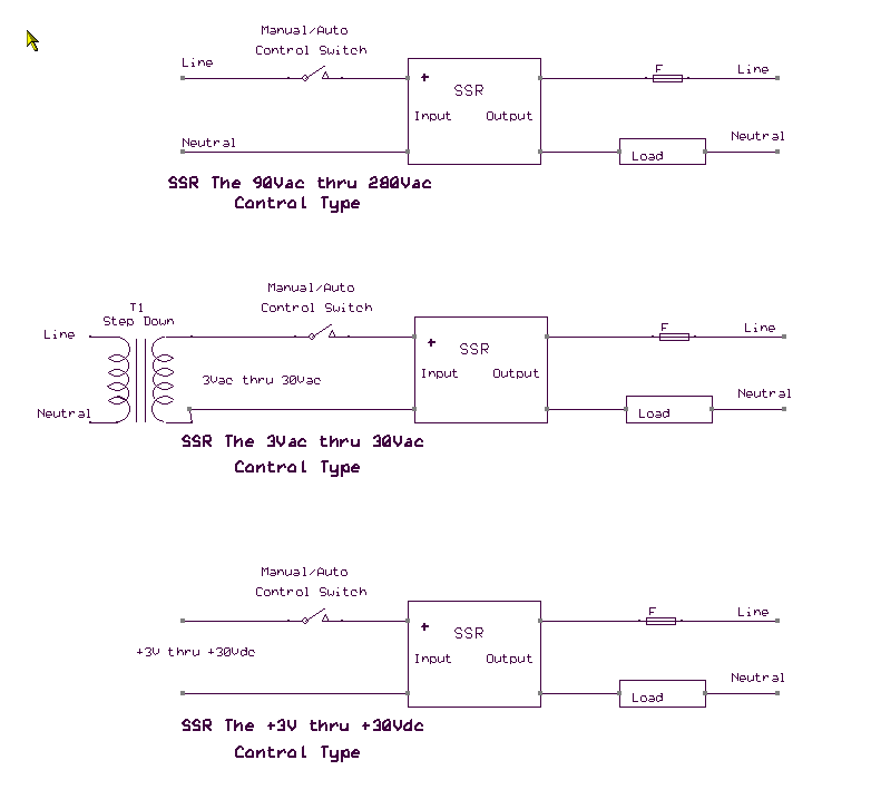

Get a datasheet for the part, otherwise there could be smoke. There are usually two terminals for the "coil" which, is likely and LED or transistor circuit in the case of an SSR and the "output" which, might be a triac or MOSFET structure of some kind.
Sounds like your SSR switches both the HOT and NEUTRAL (?) (That would be the +/- in & out pair)
The replacement of a mech relay with a SSR is not a direct swop.
The SSR expects on the Input a Control voltage. Which would be switched by a remote manual or automatic switch closing.
The SSR only switches one wire of the mains wires, usually the LINE wire.
Do you follow OK.?

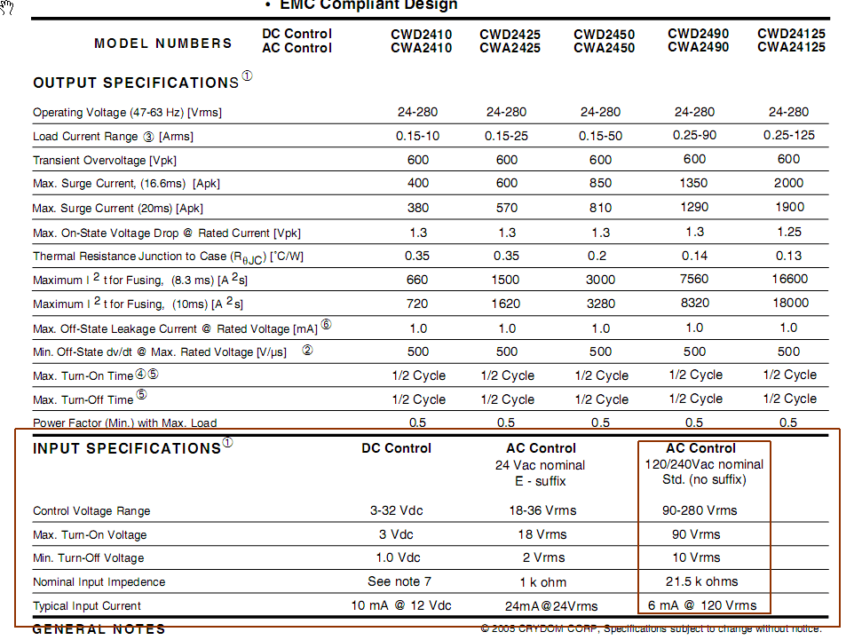

Is the 90v thry 280V 'ac' control input type you are interested in using.?
EDIT: added pdf

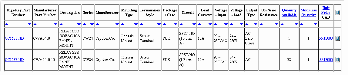

WOW!
very expensive!! (see the attachment)
I was just curious on how to (for example) control a 120VAC appliance with a 3 to 5V microcontroller without using a mechanical relay.

You can get cheaper versions for pcb mounting, driven by a +3V thru +30V dc signal from a mpu or transistor.
Or you could use this type:

Thanks for the help. If the input is the control voltage then where would the line voltage connect to? The input for the crydom SSRs is labled -/+, terminals 1-2.....the only terminals left are the ouput terminals 3-4. If I can't figure this out I will try to find a quieter mechanical relay, or just shield the one I have to reduce/elliminate the noise it makes.
Thanks again.
Look at this image.
Some users put the Load in the LINE side of the SSR, which IMHO is not a good idea, the Load may not be 'powered' but its Live with respect to neutral/earth.
