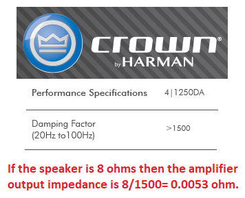

I have been reading too many lies from high-end amplifier manufacturers like Crown.

depends on where the measurement is done..... if it's done at the output connection on the amp board, i can see it being that small, but then you have to add in the wiring, speaker relays, and speaker terminals, and is it still that small at the speaker terminals? i've measured many amplifiers at the speaker terminals, and they average anywhere from 0.0500-0.1000 ohm (and that's at 100hz, where most amps still have their full gain margin available.... measure it at 1khz or higher, and the damping factor will change). add speaker wire to the mix, and the actual damping factor will fall further. the amplifier still exerts control over voice coil movement, but not as much as if the speaker were connected directly to the amp board. you could take the hot end of the feedback network and connect it to the speaker itself, but strange things happen in the amp if you have 20 feet of wire in the feedback loop.

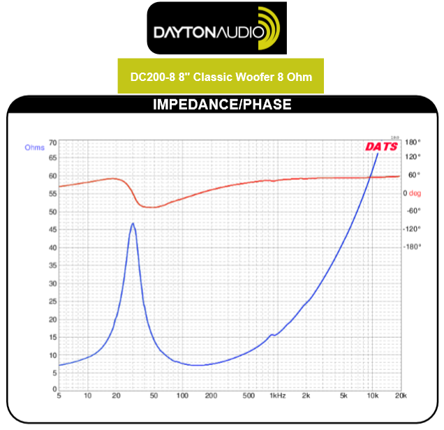

An 8 ohm woofer usually has a resonant impedance of 40 ohms or more at a low frequency.
Then I think the damping from an amplifier is even more than simply with its 7 ohms resistance in series with it.

with a test generator directly connected to the speaker (usually 50 or 600 ohms) you will definitely see and hear that resonant peak.... but try it with a good amp (like a Crown) and compare the results once the voice coil's back-emf is under effective control. even when there's no audio and the amp is on, the speaker behaves differently... tapping on a woofer gives "thump-thump" with the amp off, and "tap-tap" with the amp on.
somehow the second time i read this i realized i must have missed something the first time... yeah, the amplifier damping is much more effective damping the resonant peak because the peak is 40 ohms damped by the <0.1 ohm output impedance of the amp (which would make the Crown damping factor effectively 7500 at that particular portion of the speaker's impedance curve , but only there). i know musicians that don't like solid state amps because they "don't have a sound of their own" like tube amps do... well... that's the point... the goal of a good solid state amp is wrapped up in David Hafler's "piece of wire with gain" analogy. for a musician, the amp is part of the instrument, the amp SHOULD have a "sound of it's own" but you don't want to filter recorded music through that...
